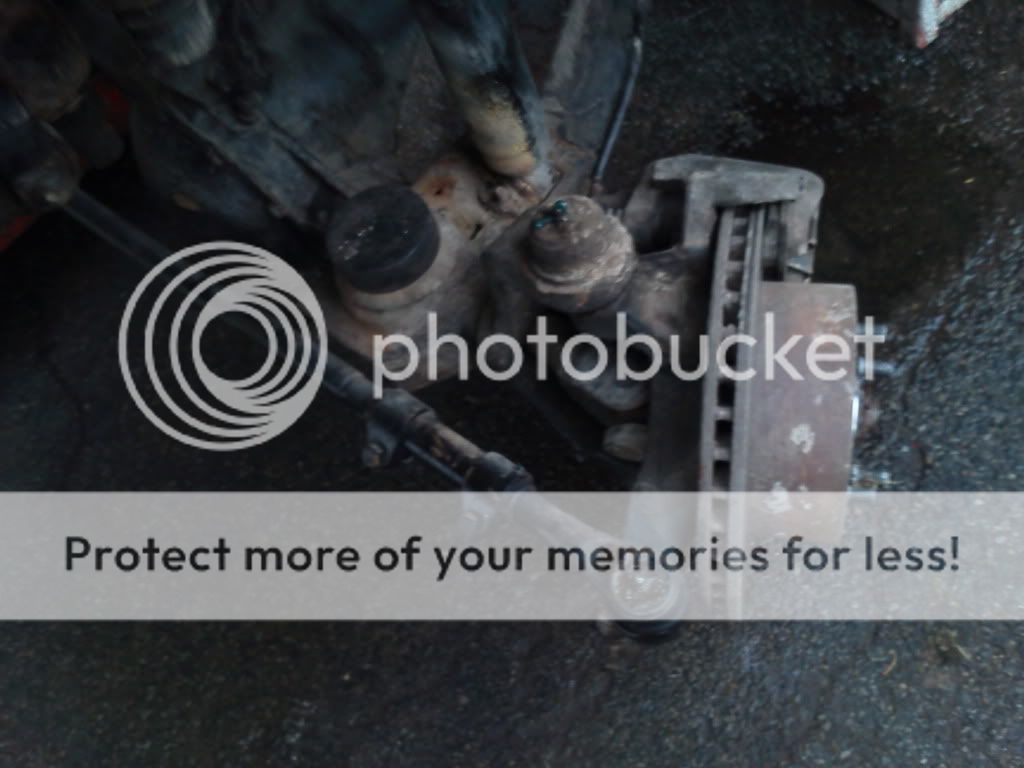

this is the steering I have now
the tolerances are definetly tight... I actually lost a tiny bit of radius toward driver because the tie-rod hits the coil bucket...I am contemplating putting a bend in the tube, or maybe a notch and filling it with some solid rod..... decisions decisions

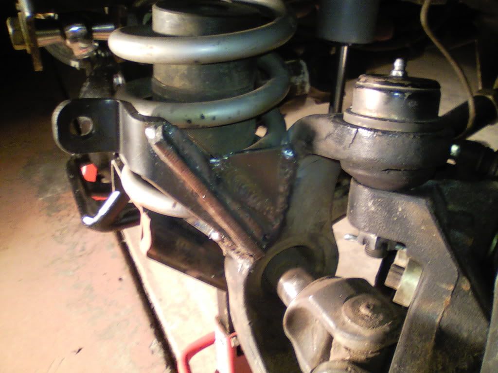

my version of the JCR slightly modded
had to get them up real high, so I went further out, flush with the outer edge of the inner C. I had to make new standoffs from the coil bucket. we added the gusset to tie it in all the way up the inner C. it will act as somewhat of a gusset for the C as well, although it was not intended for that, nor would I rely on that.
Why did you have to get them up higher then they were designed for? Mine are in the mail now.
I am running inverted T steering, the tabs I have on the tie-rod would have hit the sway bar mounts if I ran them the way JCR puts them on.
it wasn't a big deal really, just needed a longer standoff from the coil bucket.
I added that extra gusset behind it for security, I have heard of people bending them, so I made sure that's not really possible.
