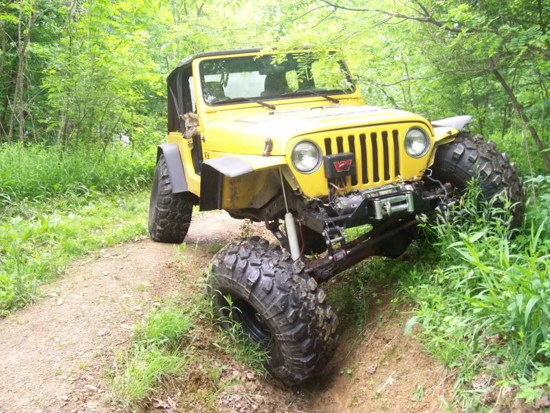

This is pretty cool....just some food for thought...YJ leafs with approximately 4" of stretch, and a stock tank. Easily one of my favorite jeeps of all time. And clean as a whistle.
CHECK IT OUT!

I think that's the same one but it had different rims. Very clean jeep!
