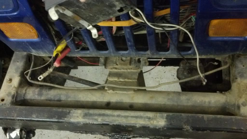

pulled winch plate off

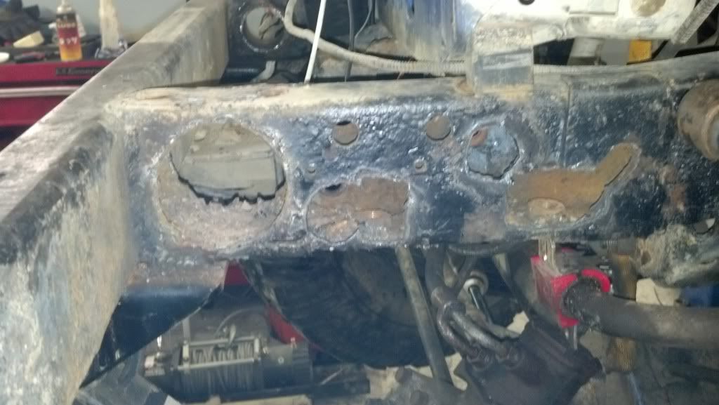

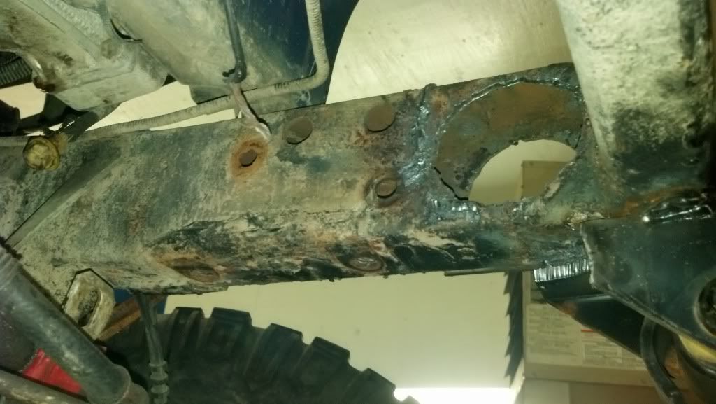

cut old crossmember out (dont even need it with the way my front bumper is

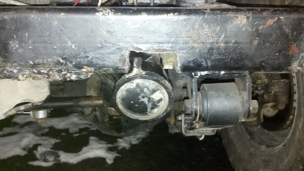

started un bolting the steering box bracket and the ****ing nutserts kept spinning. so i figured since i was going to be plating the frame anyway i may as well make it easy on myself

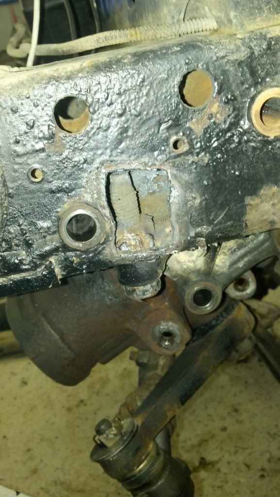

all the holes cut...scary

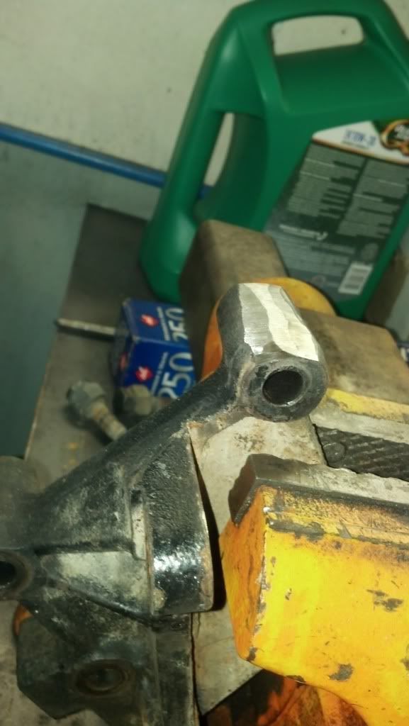

shaving the edge of the mount so i can push i as far forward as possible
before cleanup where the mount will sit

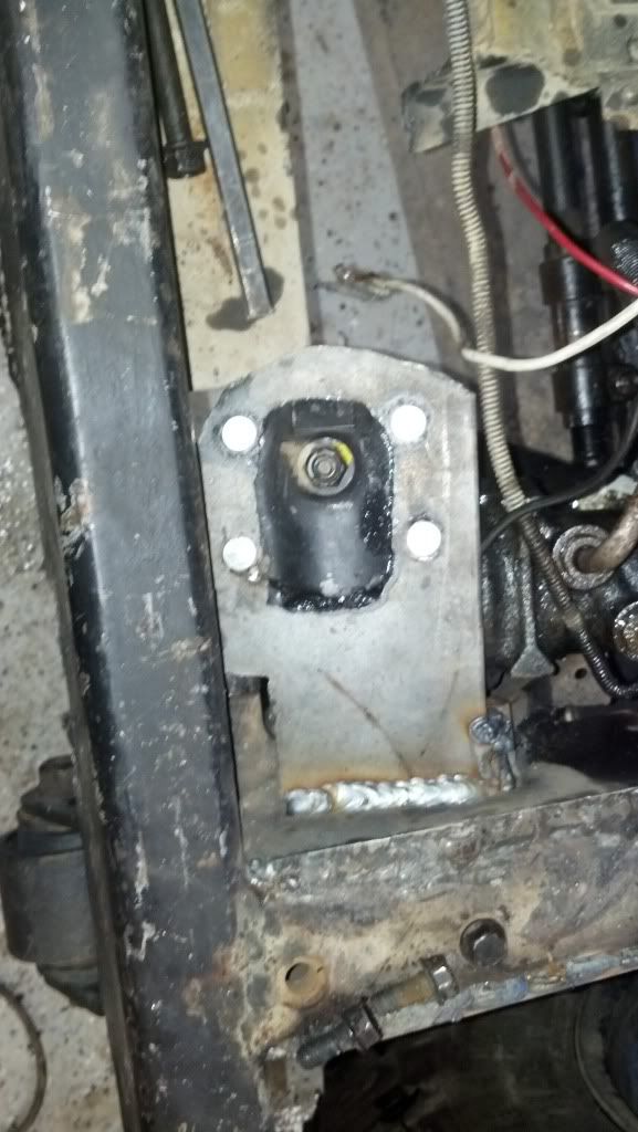

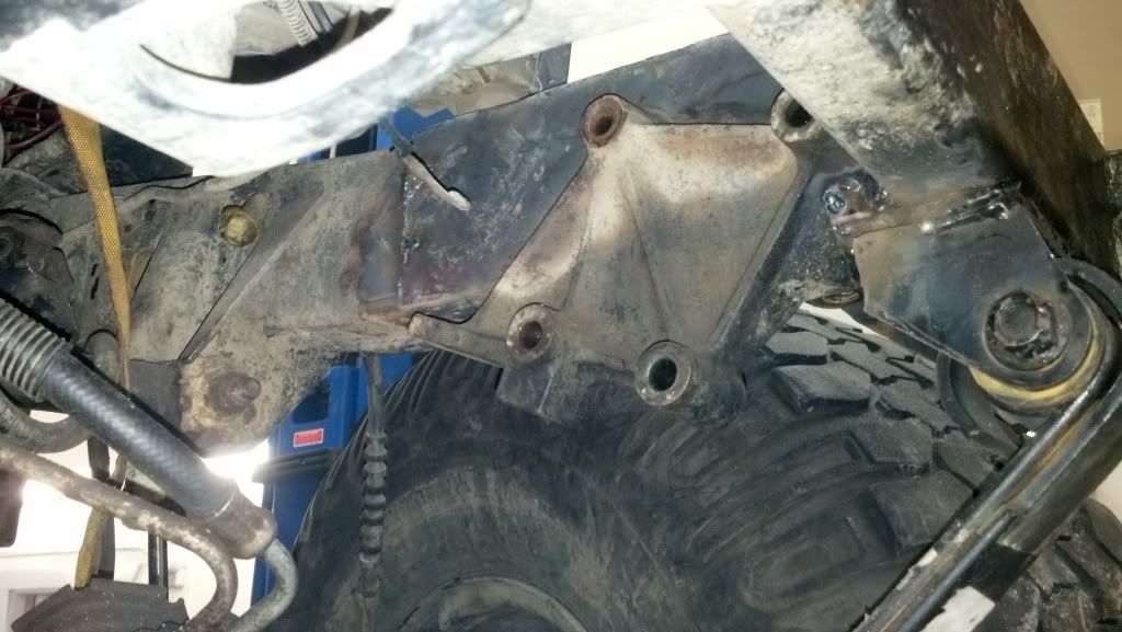

test fit with new frame plate

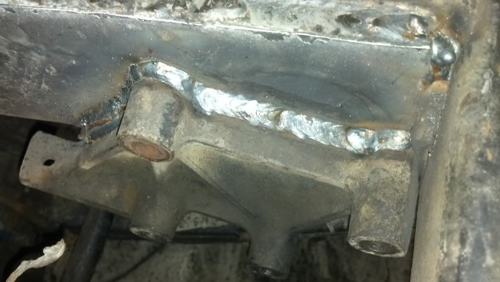

welding the bracket on (as long as nobody asks me how i plan to drill the front hole i'll be fine... i noticed that is going to be a problem while sitting here posting this)

Not bad. That frame was looking like Swiss cheese but it looks like you got it sorted out. Yeah nutserts are a huge pain. I usually blow the heads of the bolts off with my torch and then it makes short work of it. Then I just clean up the holes where they were fit new nuts and weld em in. That way it saves metal, but if you are adding metal to the frame like you did, then who cares right? Good job man, looks good

Thanks and yea the frame was a little trashed after all the removal lol. I wouldn't want to trust it to hold my steering together.

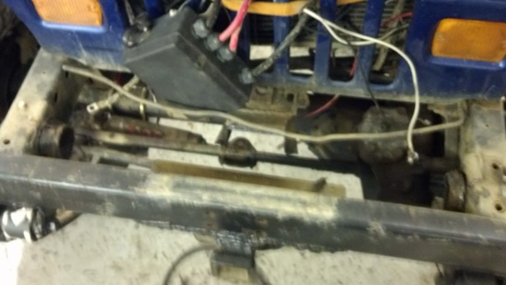

Finished moving my box
Had to notch my bumper for it
Then it didn't look strong enough to me do I built a little brace to give it a little more peace of mind
