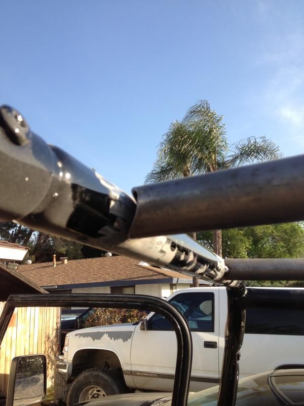

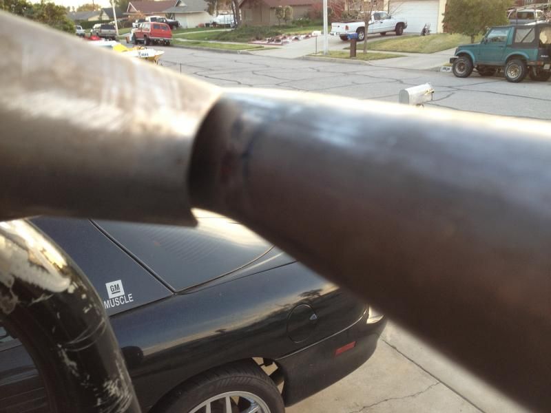

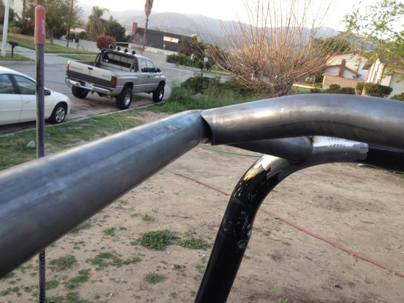

I had ordered my Poly Cage a few weeks ago, finally no more rain so I started on the install about two days ago taking my time. Everything stripped out of the TJ and started to mock up the rear cage add on, there are huge gaps in the tube that adds onto the stock cage. I'm not sure if it wasn't notched correctly or if I don't have it in quite right, there is about a half inch gap.
Dunno if this is the correct area to post this.
p.s. The tube is tacked into place

looks like you could move the rear spreader bar up a bit. did you see if it fit better up-side-down from its present orientation? having to massage the notches a bit would be a standard thing and woulndt constitute a faulty product in this case. every cage is going to weld out a bit different due to the heat involved. dont tack it on if there is a big gap. ratchet straps will help line things up as well.
