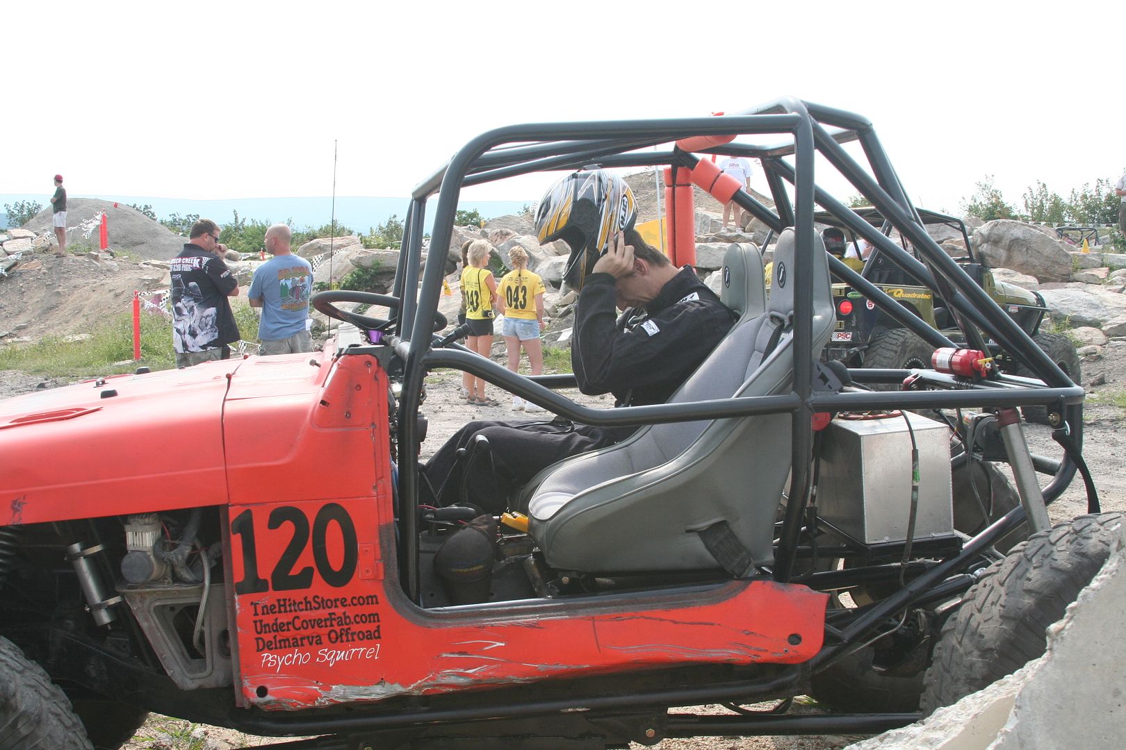

Installed limit straps finally in all four corners:

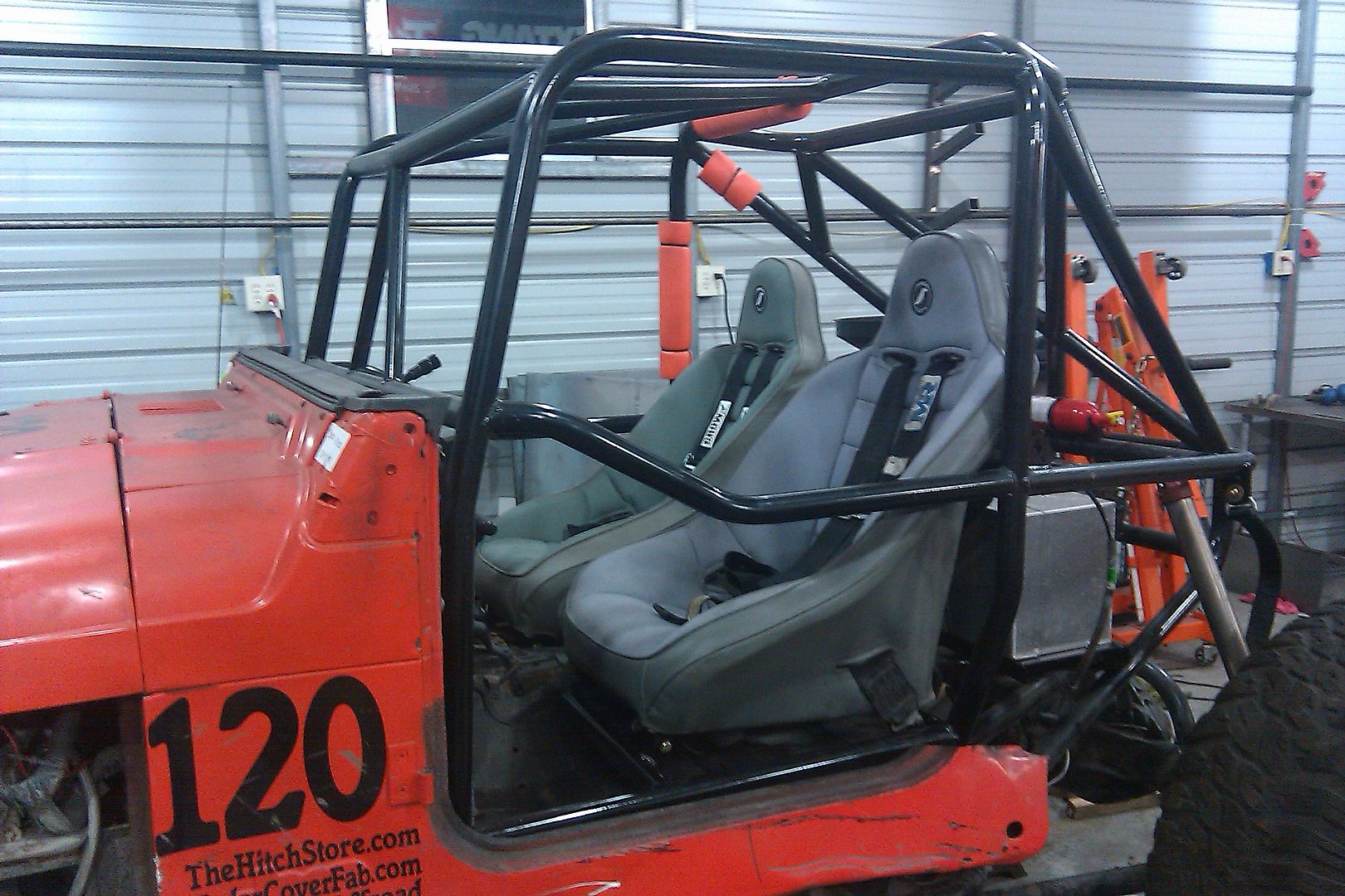

Also swapped the old driver seat to the passenger side (it was a Baja Ultra wide, and I am not a big guy) then installed a normal Baja Ultra on the driver side. No more redneck buggy with 1 seat haha
Gave all the bolts a once over, cleaned up the buggy a litte bit, made a new spotter strap, and it is about set to go. Going to check all the fluids and top off tomorrow then get it loaded up and head to Rausch Creek.

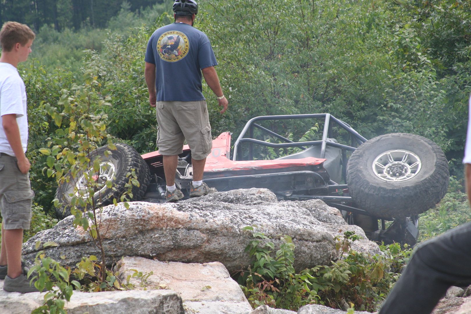

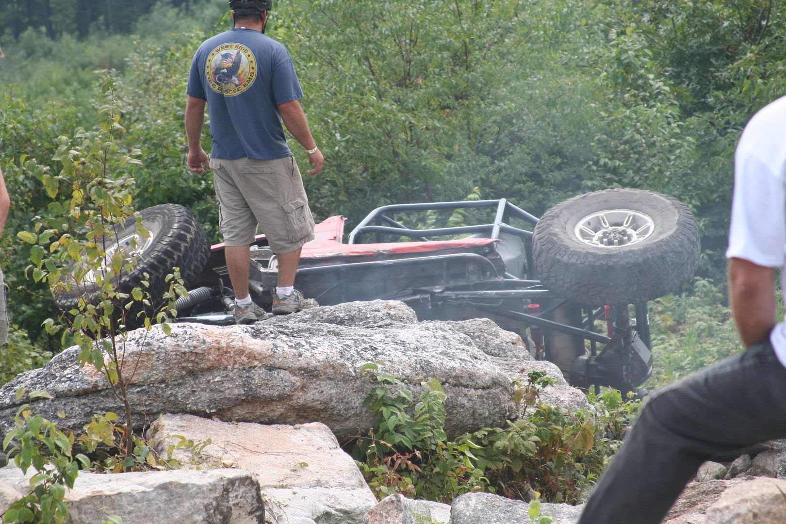

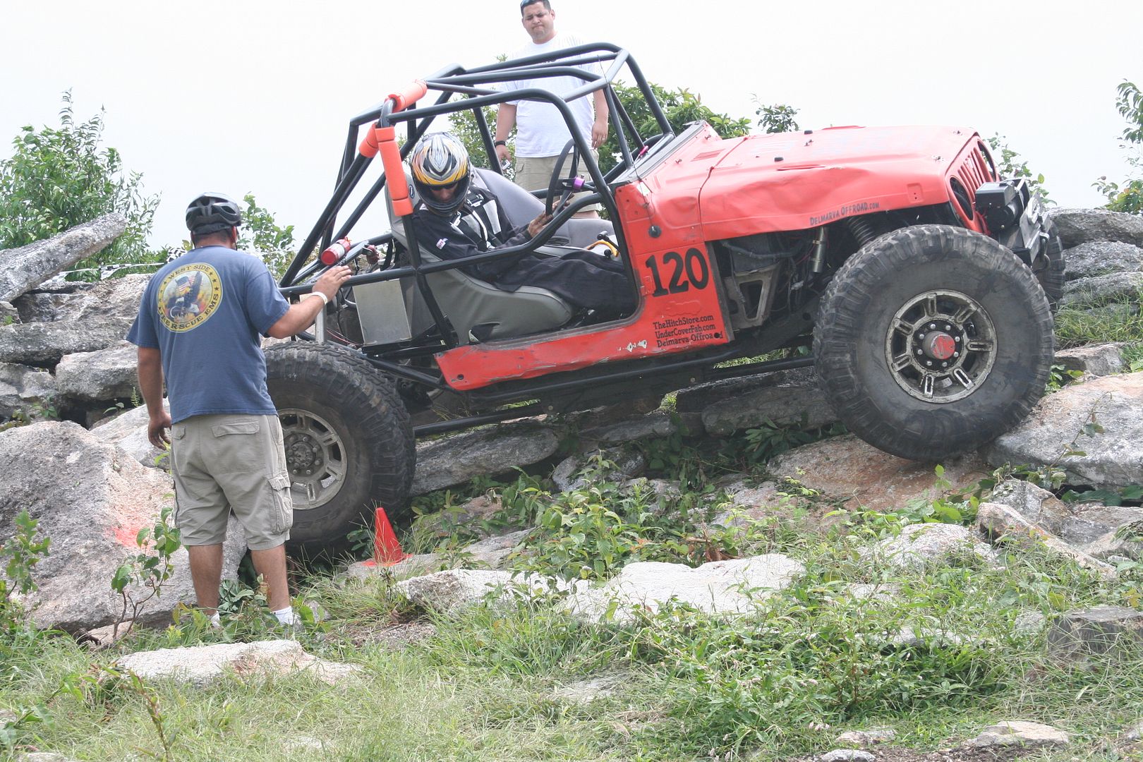

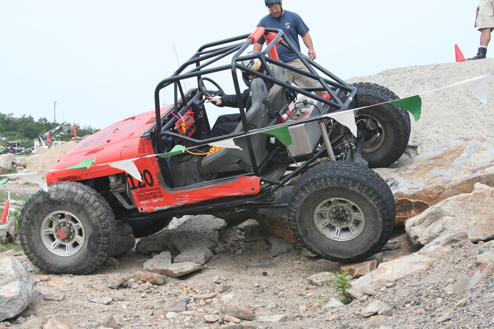

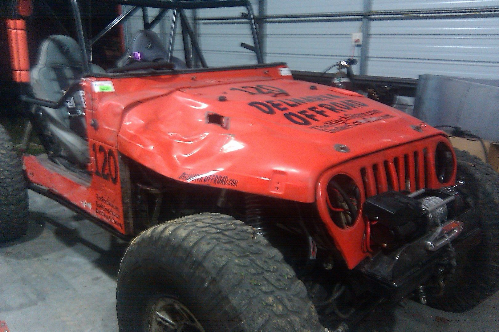

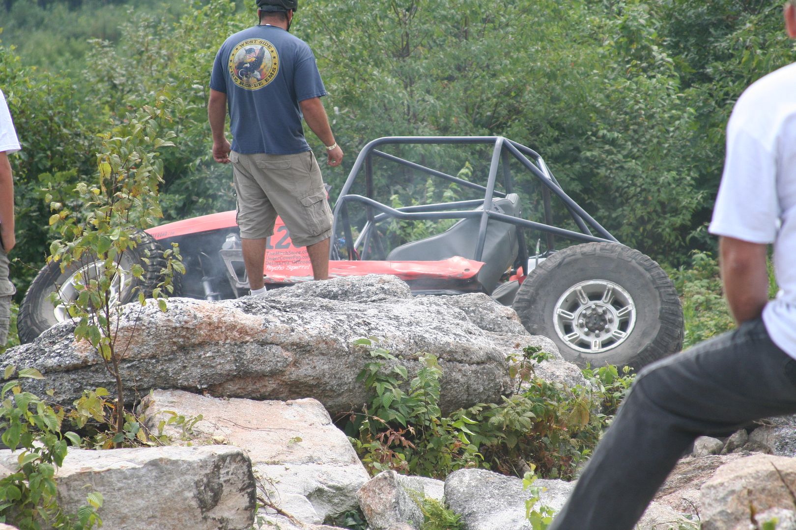

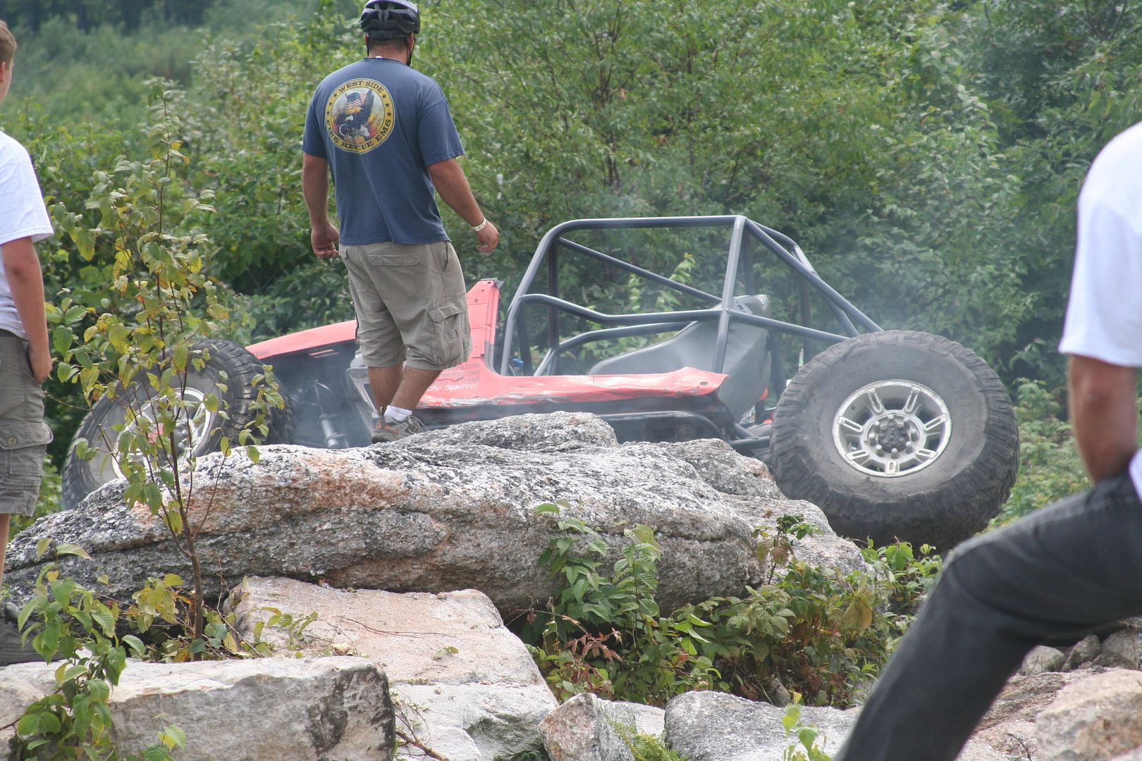

Whelp just pulled back into the shop. Had a fun day but didn't go as planned. First course we got hung up real good and had the front driveshaft rubbing hard on a rock then ended up snapping it in half. Second course we ran in just 2wd and managed to get through 2 gates with ALOT of throttle. Third course we had time to weld the front DS up and run in 4wd again. Got through the second gate, while trying to hit the 3rd gate with 20 seconds left I twisted and snapped the rear driveshaft not leaving enough to weld up. Made it to the shoot out and was only running front wheel drive, gave it h*ll trying to get up the first gate's ledge and managed to roll the buggy 3/4's of the way over and lucky stopped before going down a hill.
Got a bunch of pictures so we'll get those up tomorrow or Monday. Here is a teaser shot of the buggy unloaded:

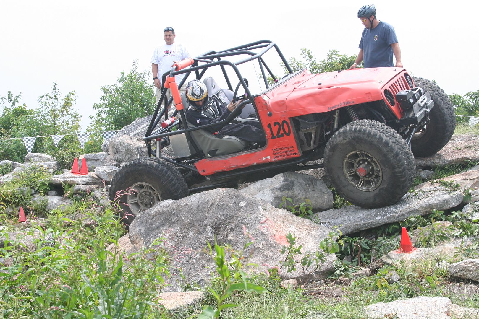

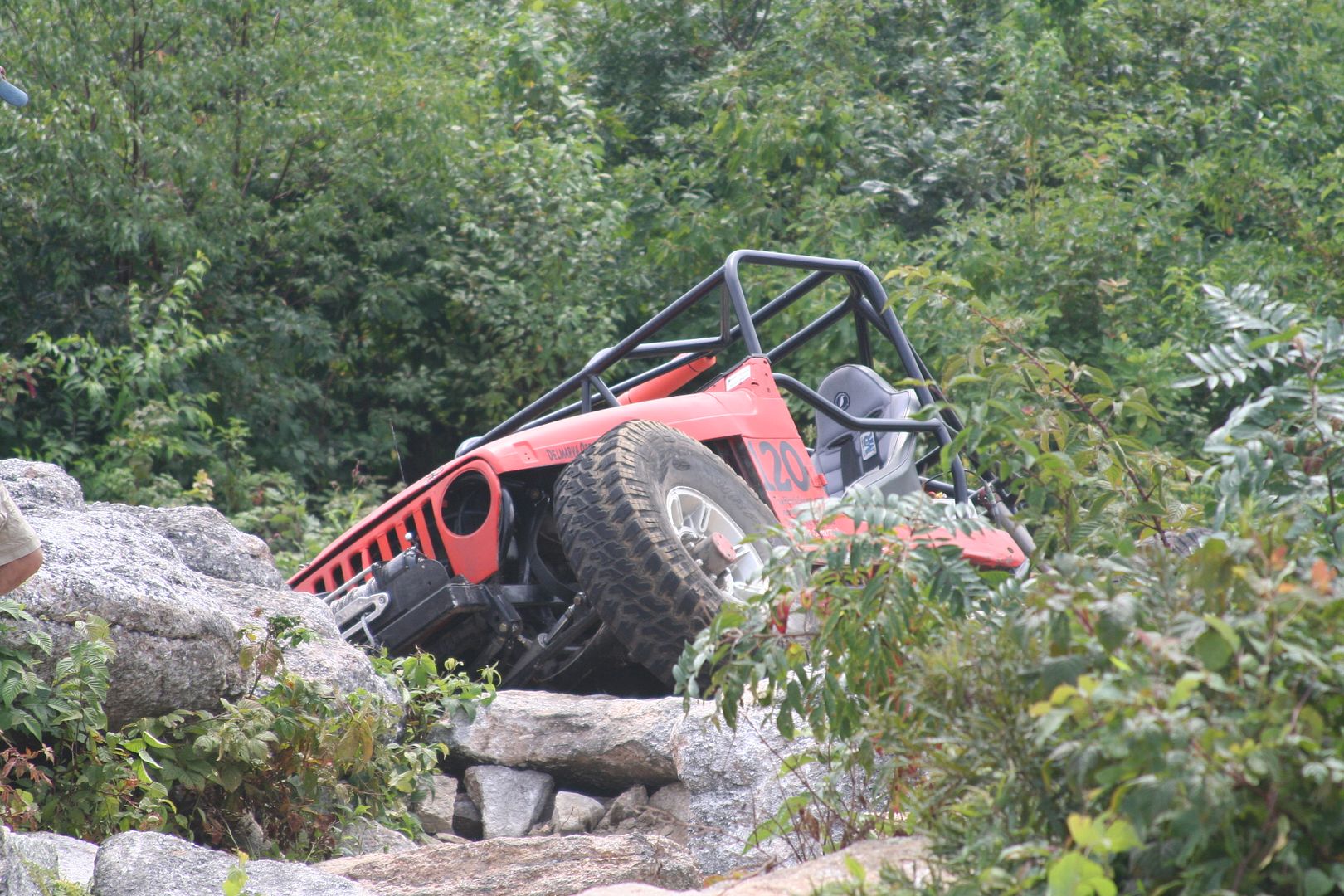

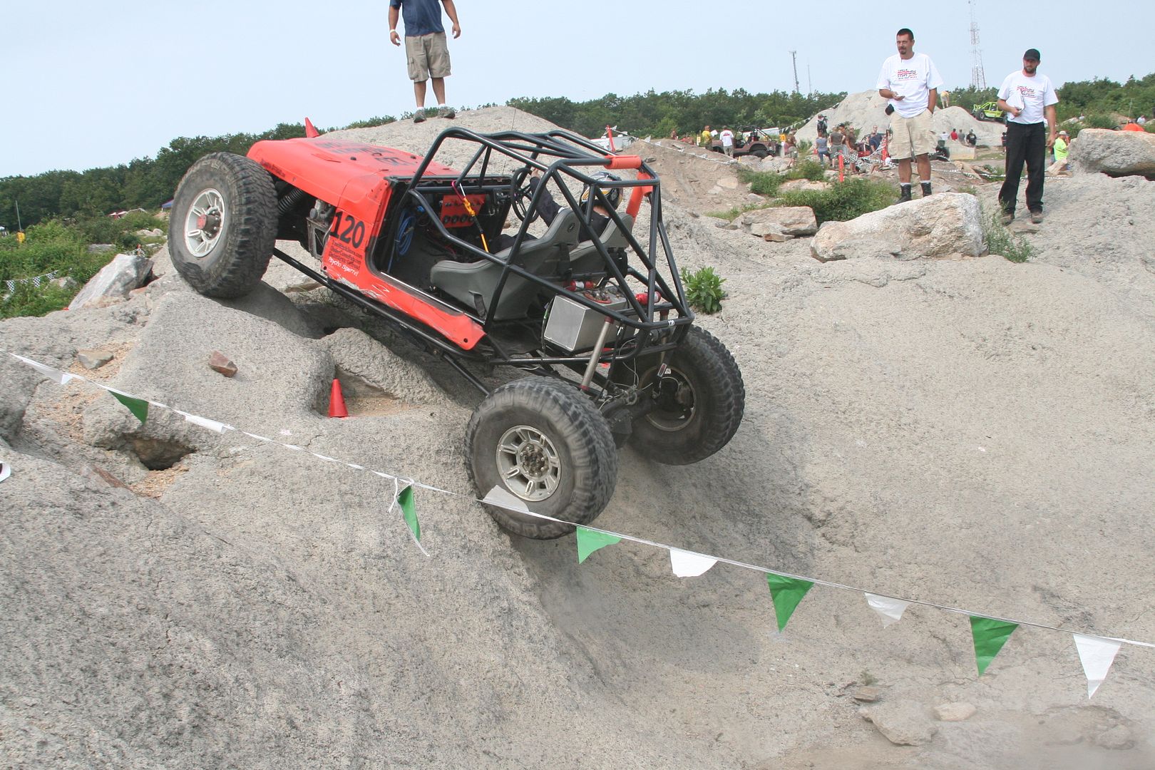

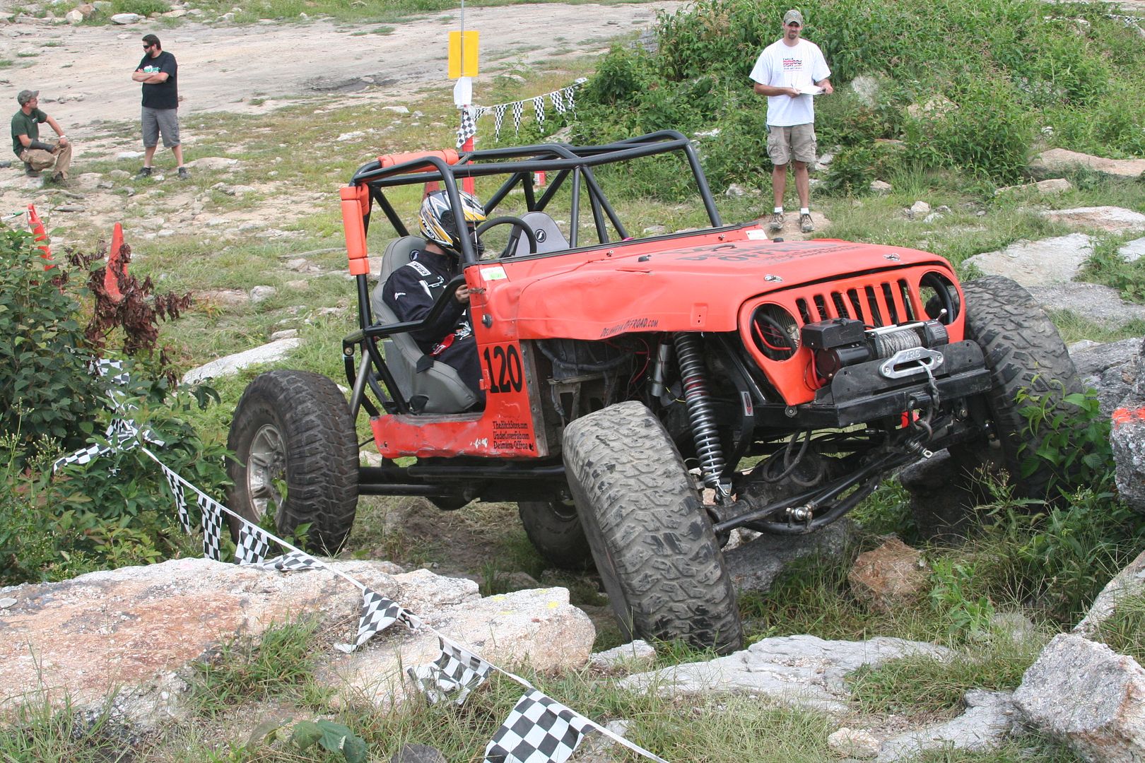

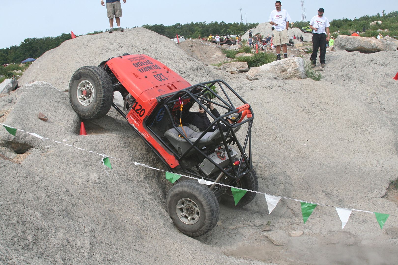

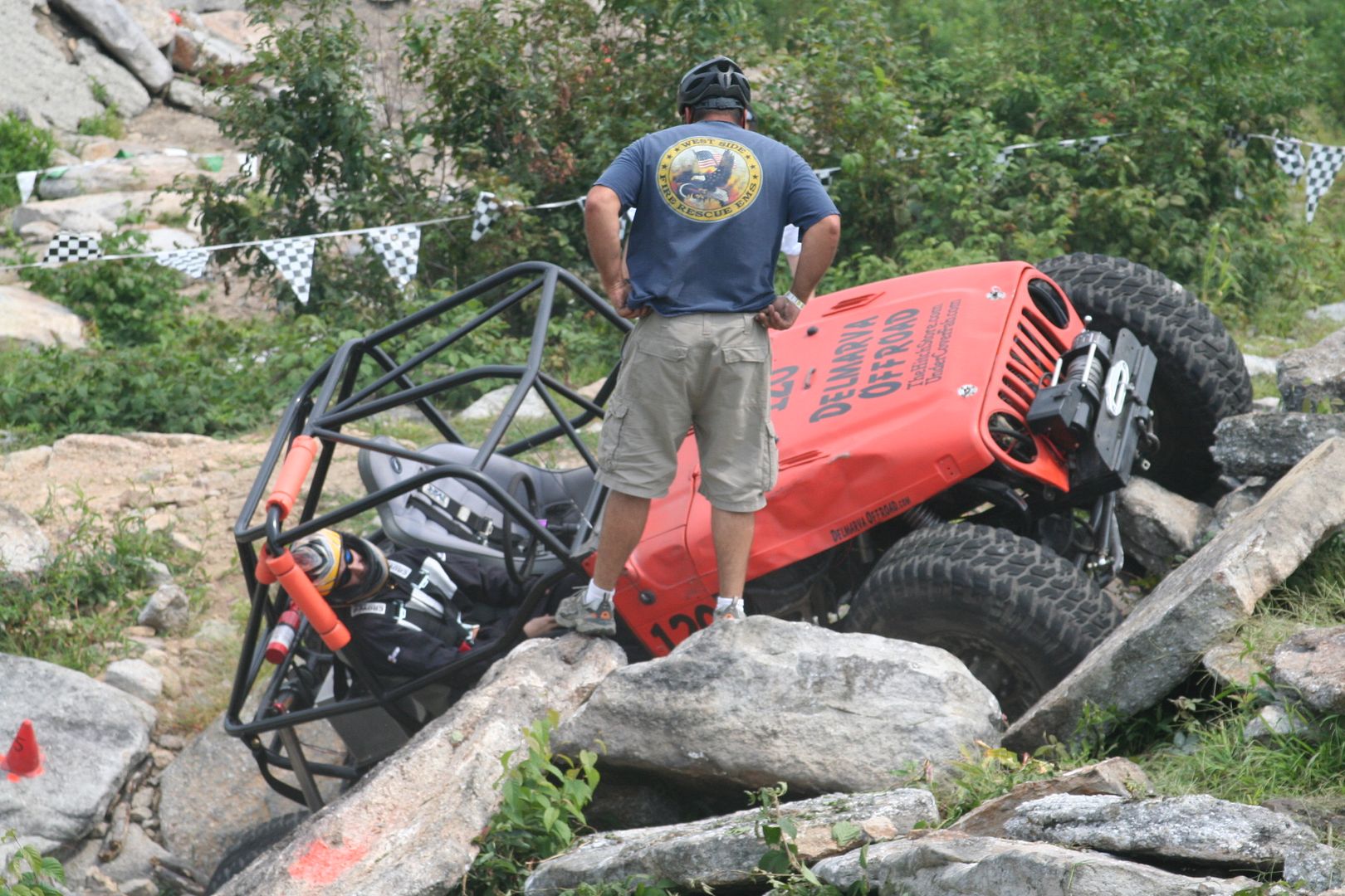

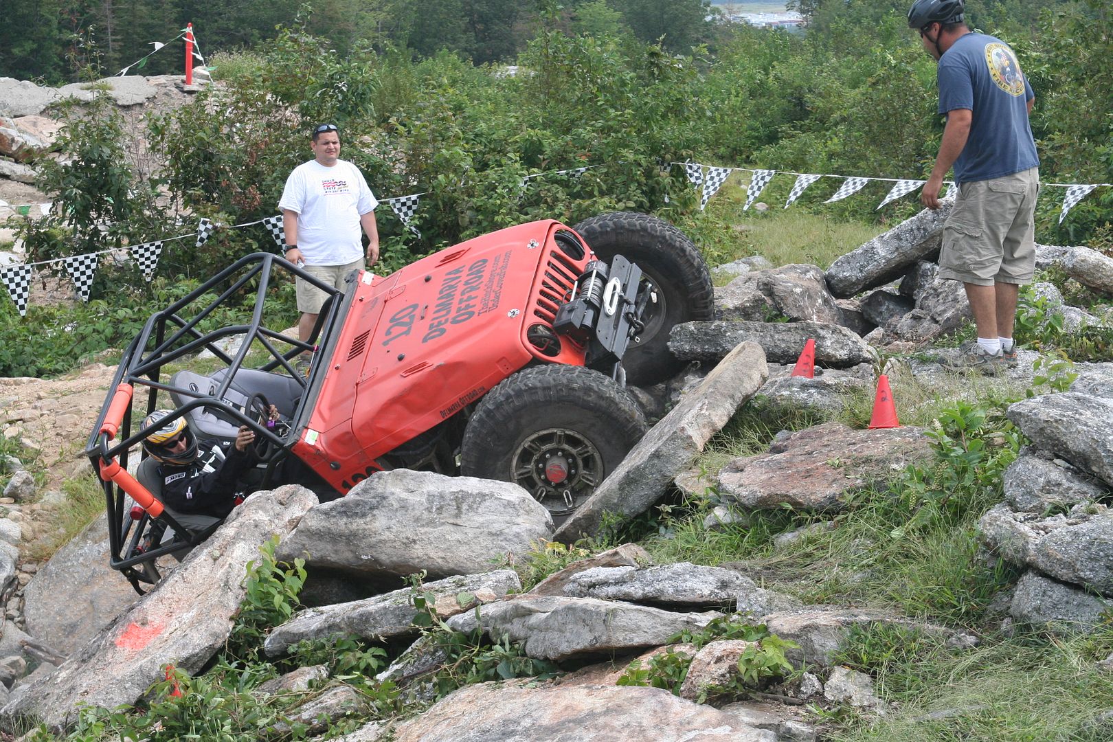

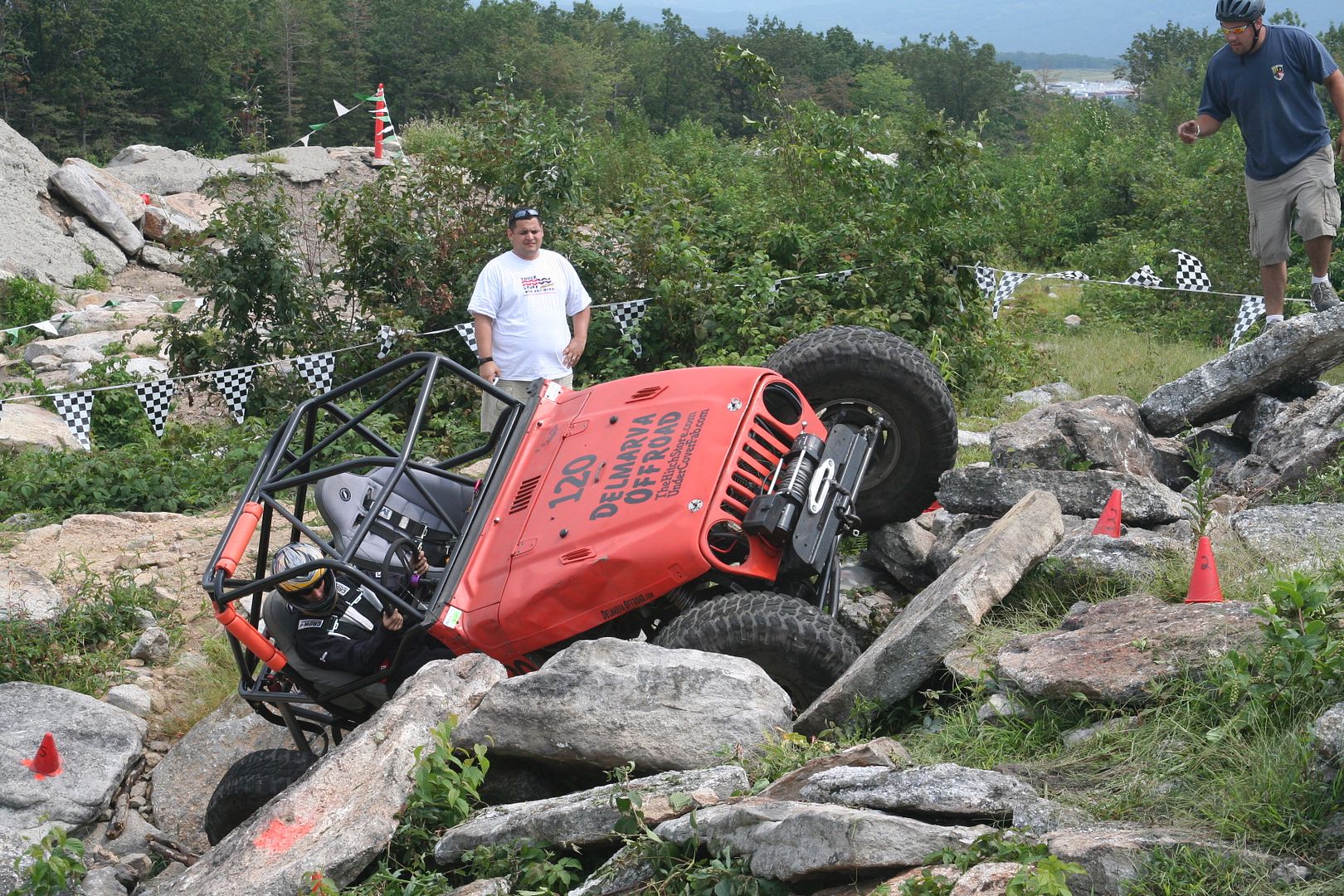

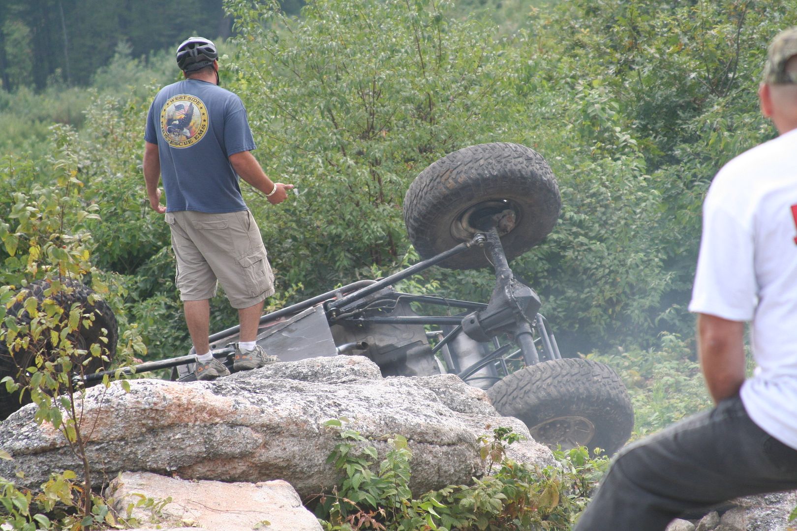

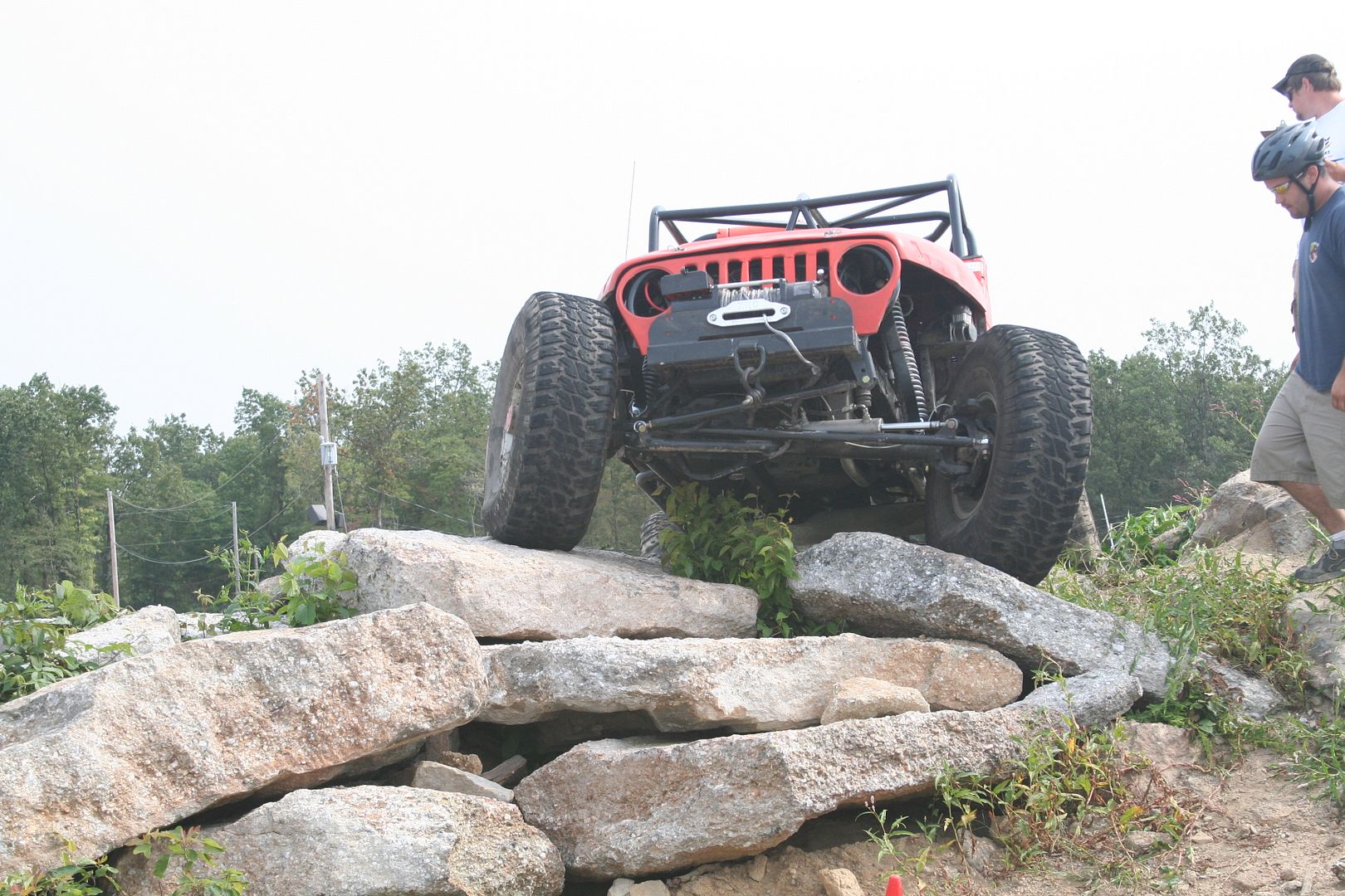

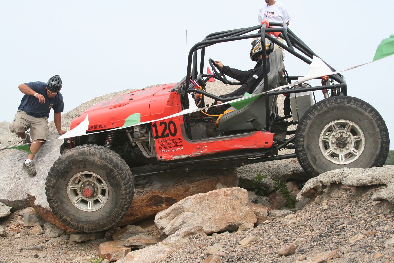

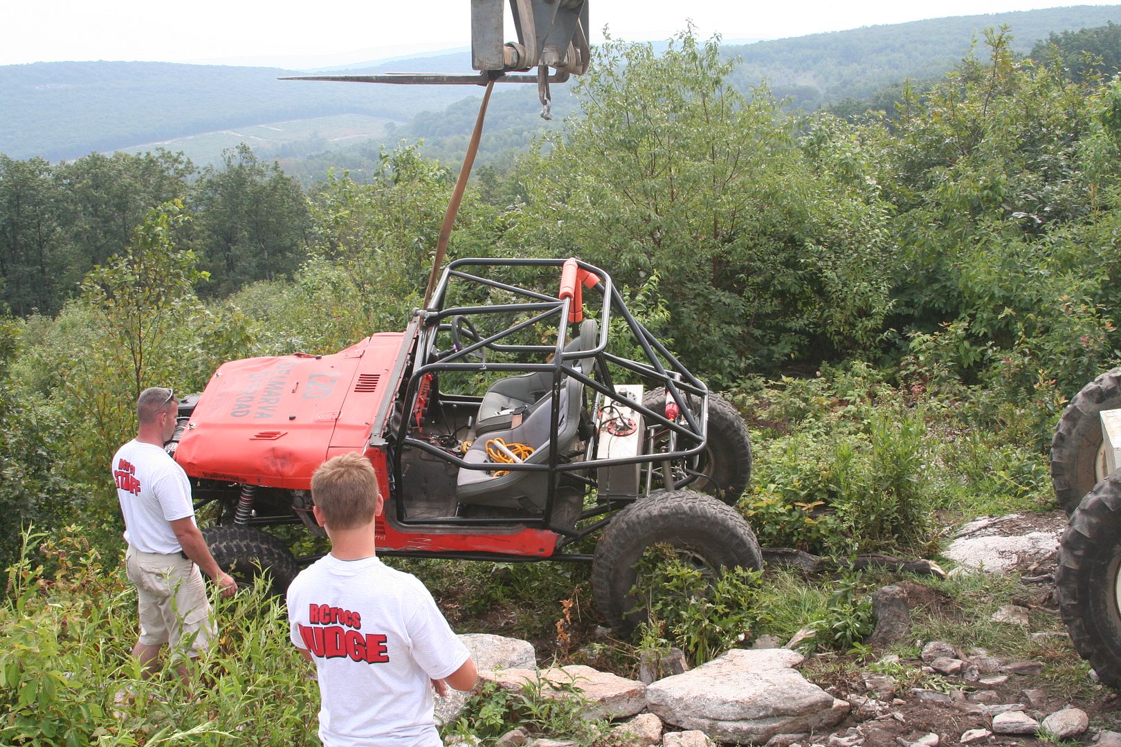

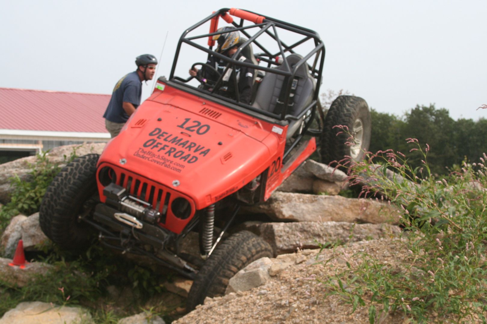

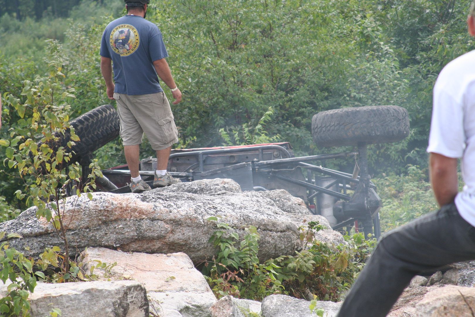

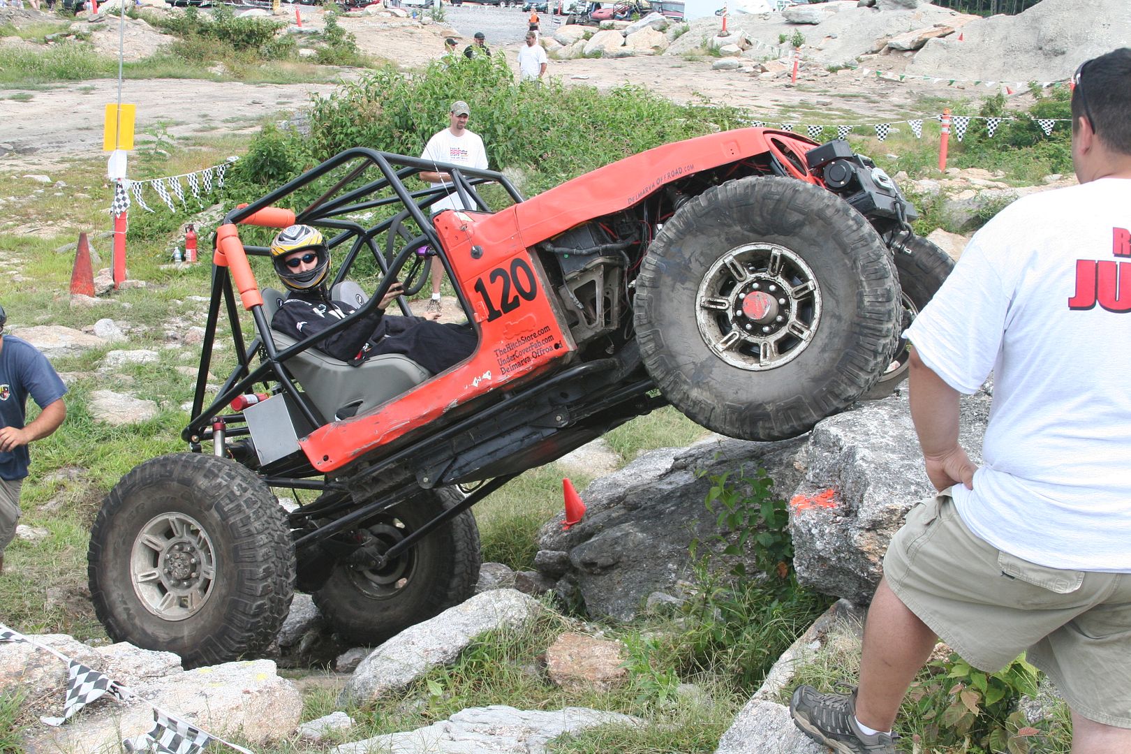

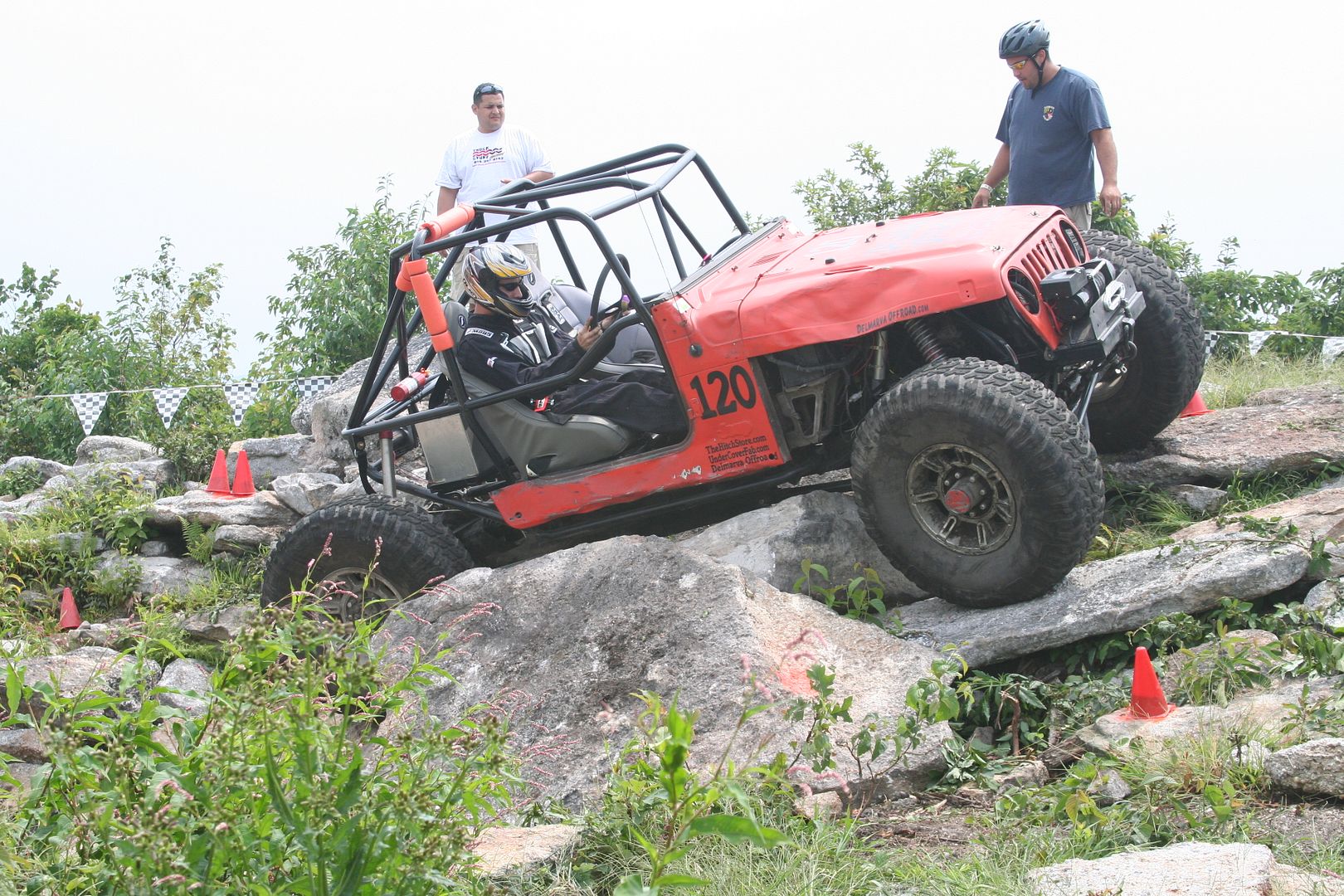

Had a fun day at the competition but due to some carnage ended the day in 4th. We started on C3, got the first gate and lined her up prefectly to get through. While pushing through dropped of a ledge on the front driveshafts, after some rubbing it gave way and snapped.
Next up was C1 for us. After some confusion we thought we had to run right away with not enough time to really fix the front driveshaft. We can up to the 1st gate on top of a ledge with the rear tires sitting in gravel. Gave a few full throttle attempts to get up, after yelling for my spotter to move gave it one more and made it up! Then we got it lined up enough to get 3 through the 2nd gate but couldn't get around enough to get to the 3rd.

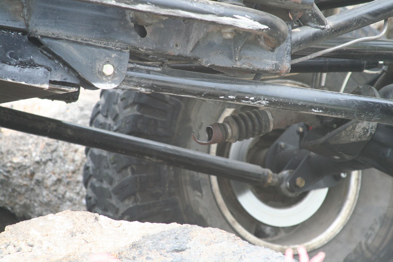

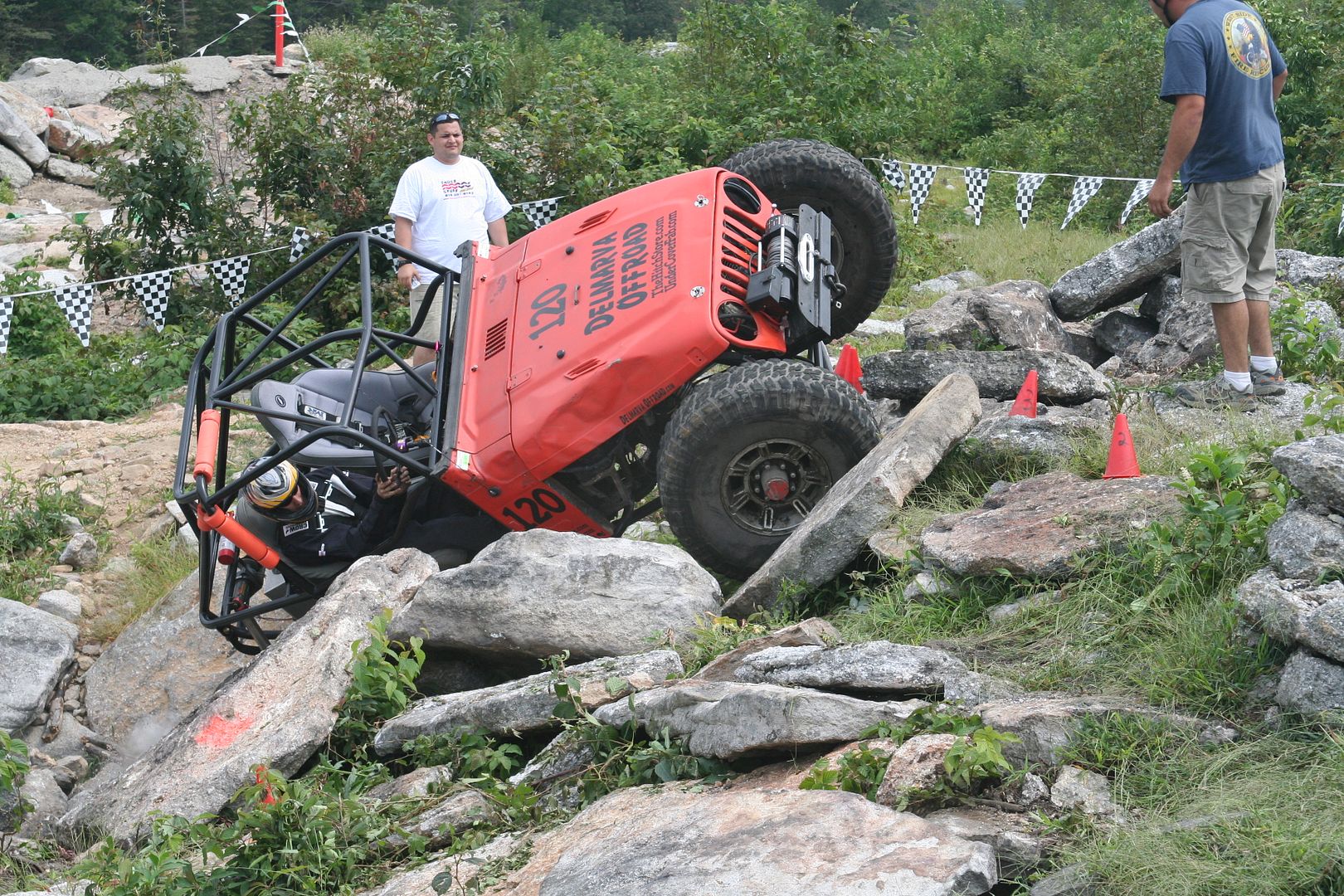

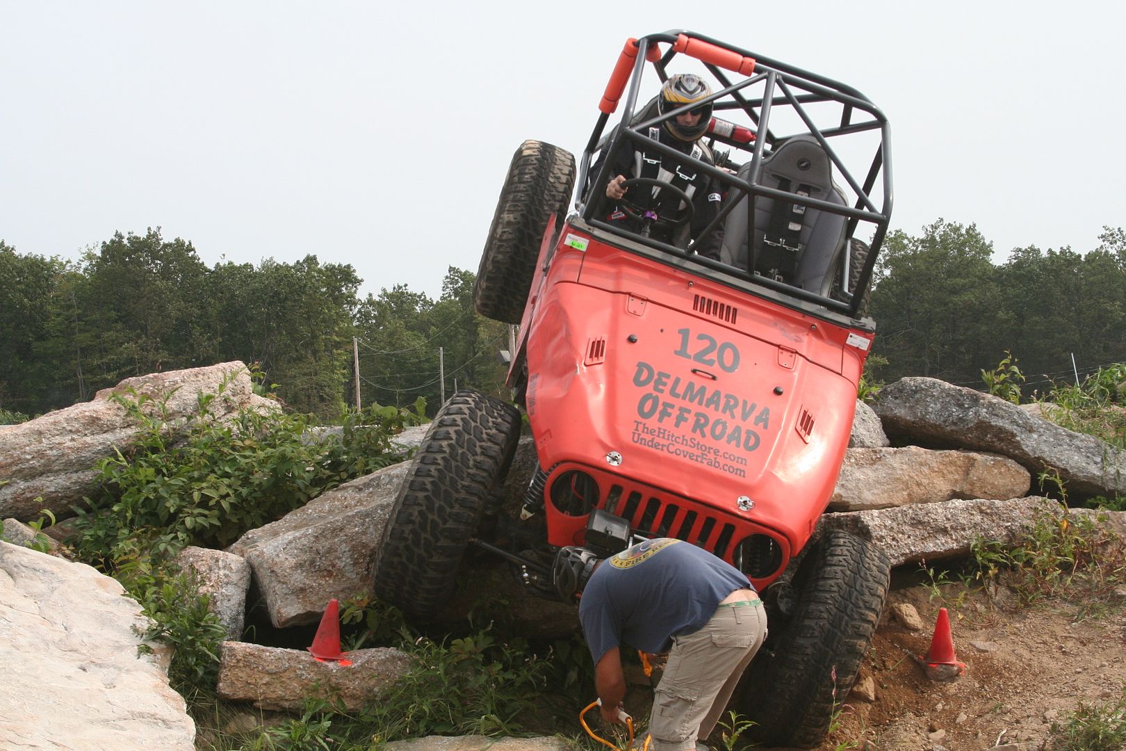

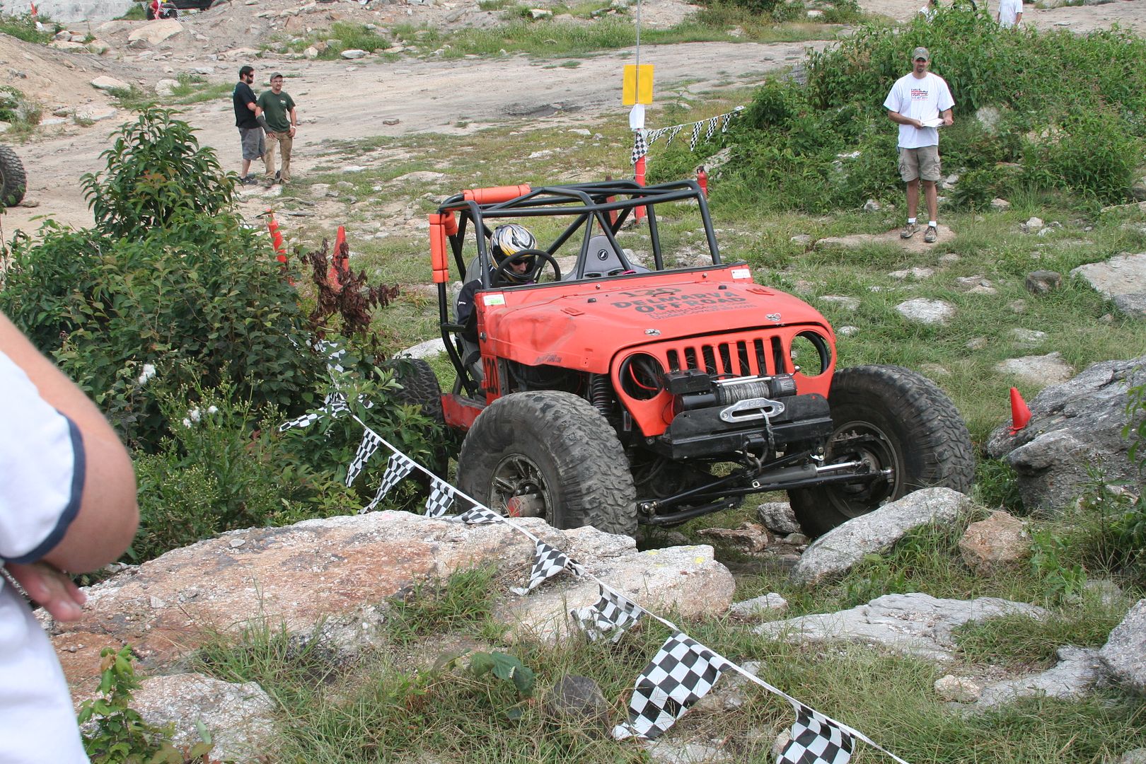

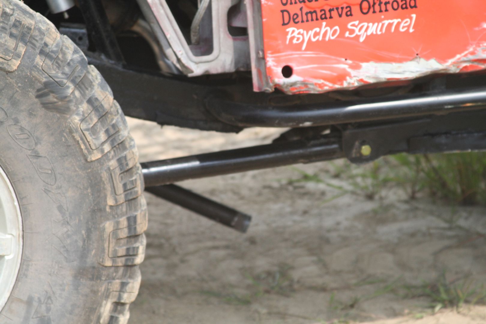

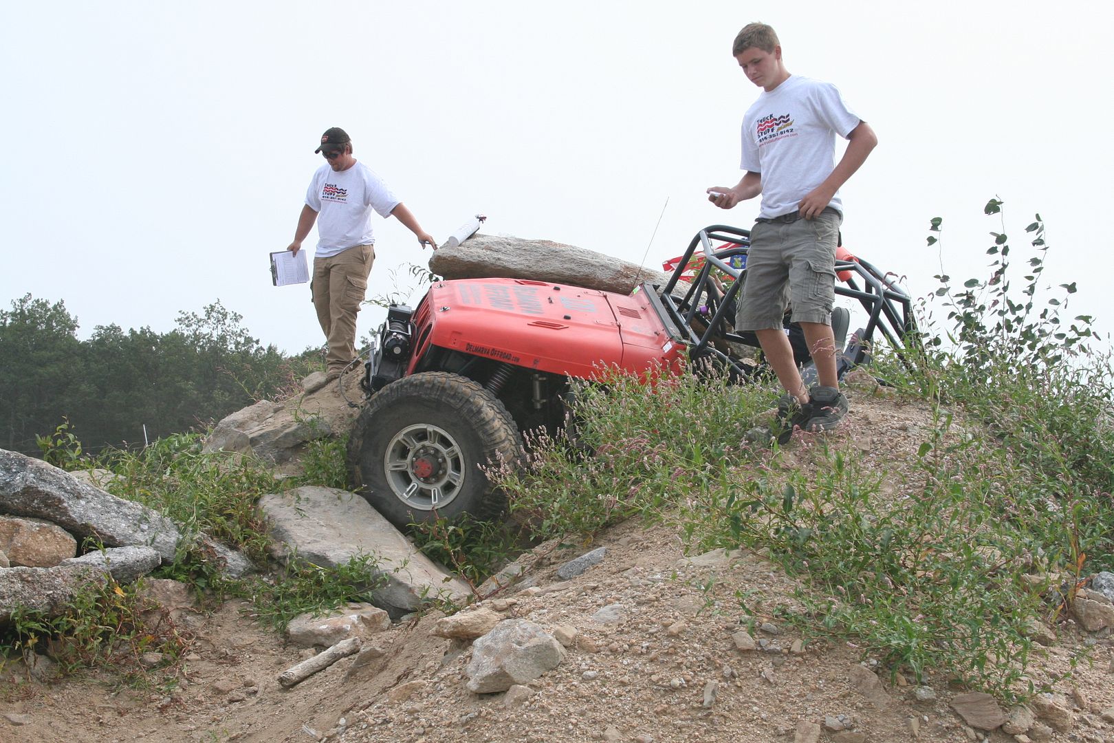

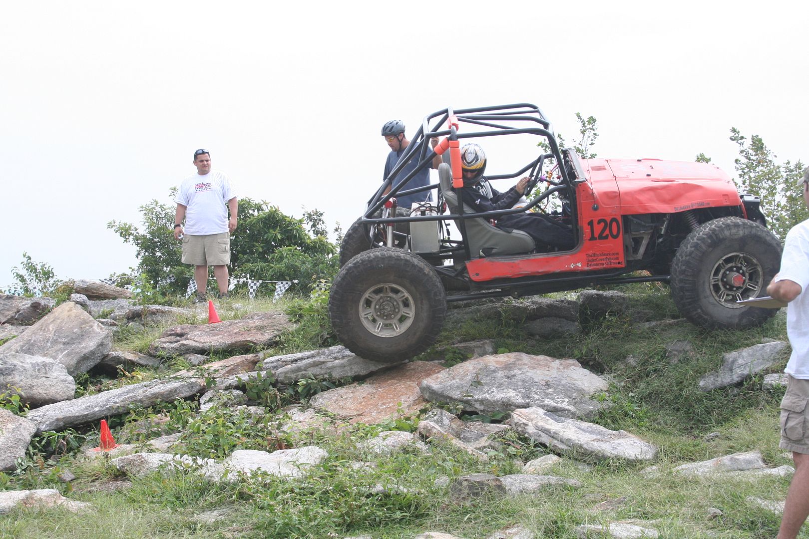

Last course was C2. Out on the natural terrian we knew we would need 4wd. We welded up the front driveshaft as best as possible (even though it looked like a rainbow). Then got it back on the buggy for course. Made the first gate, decided the best route for the 2nd was to back through the 2nd gate into the bowl to line up for our 3rd gate. Gave the 3rd gate hell for a minute. With 20 seconds to go we tried a full throttle assault again which twisted and snapped the rear driveshaft.

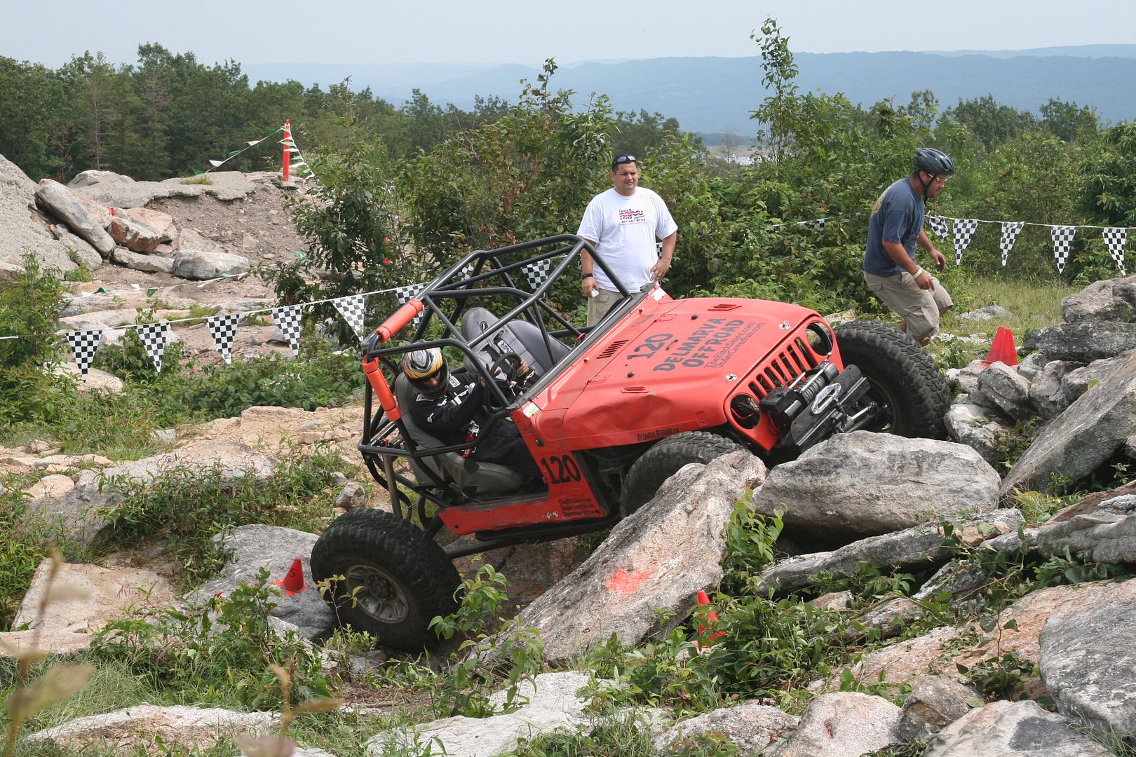

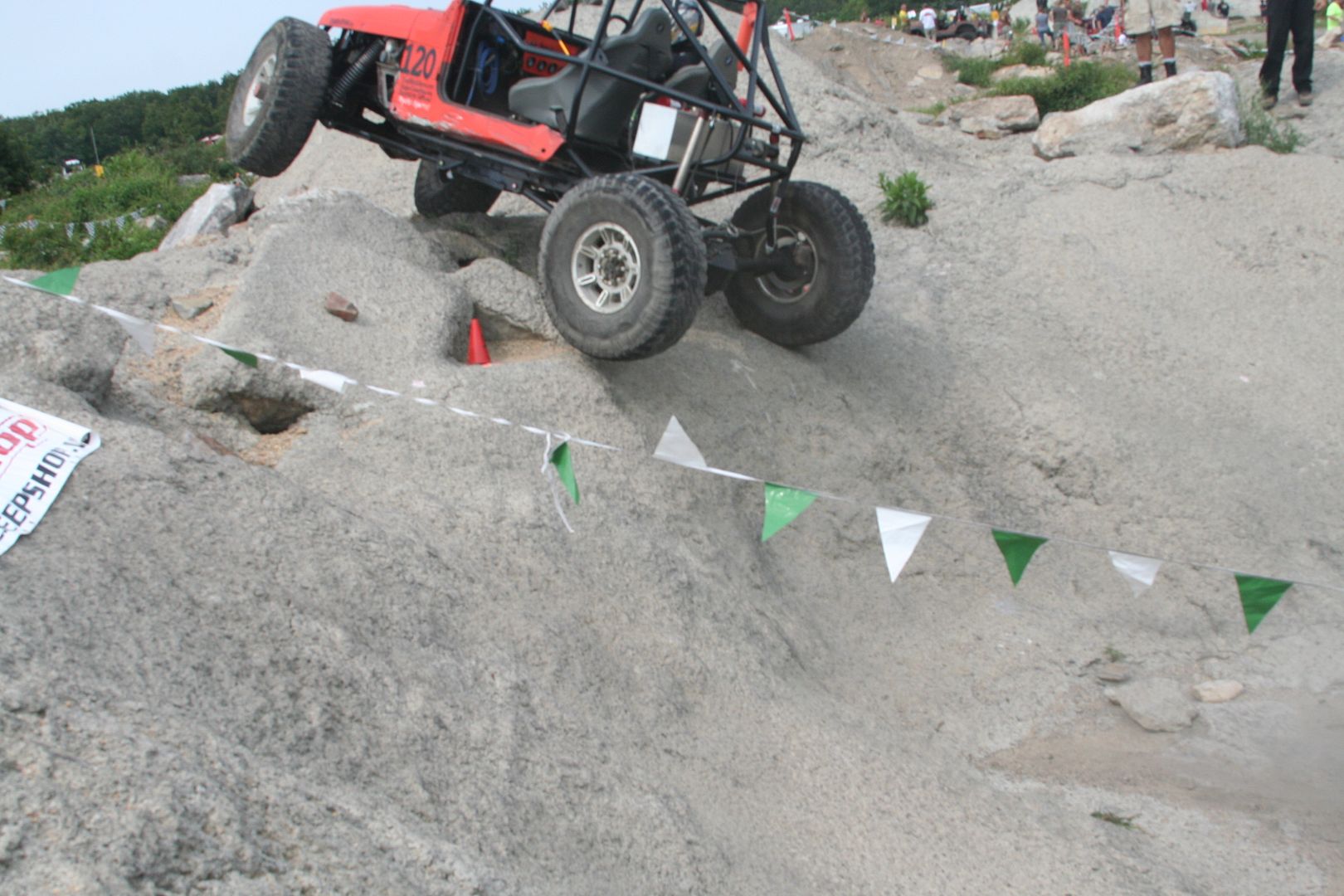

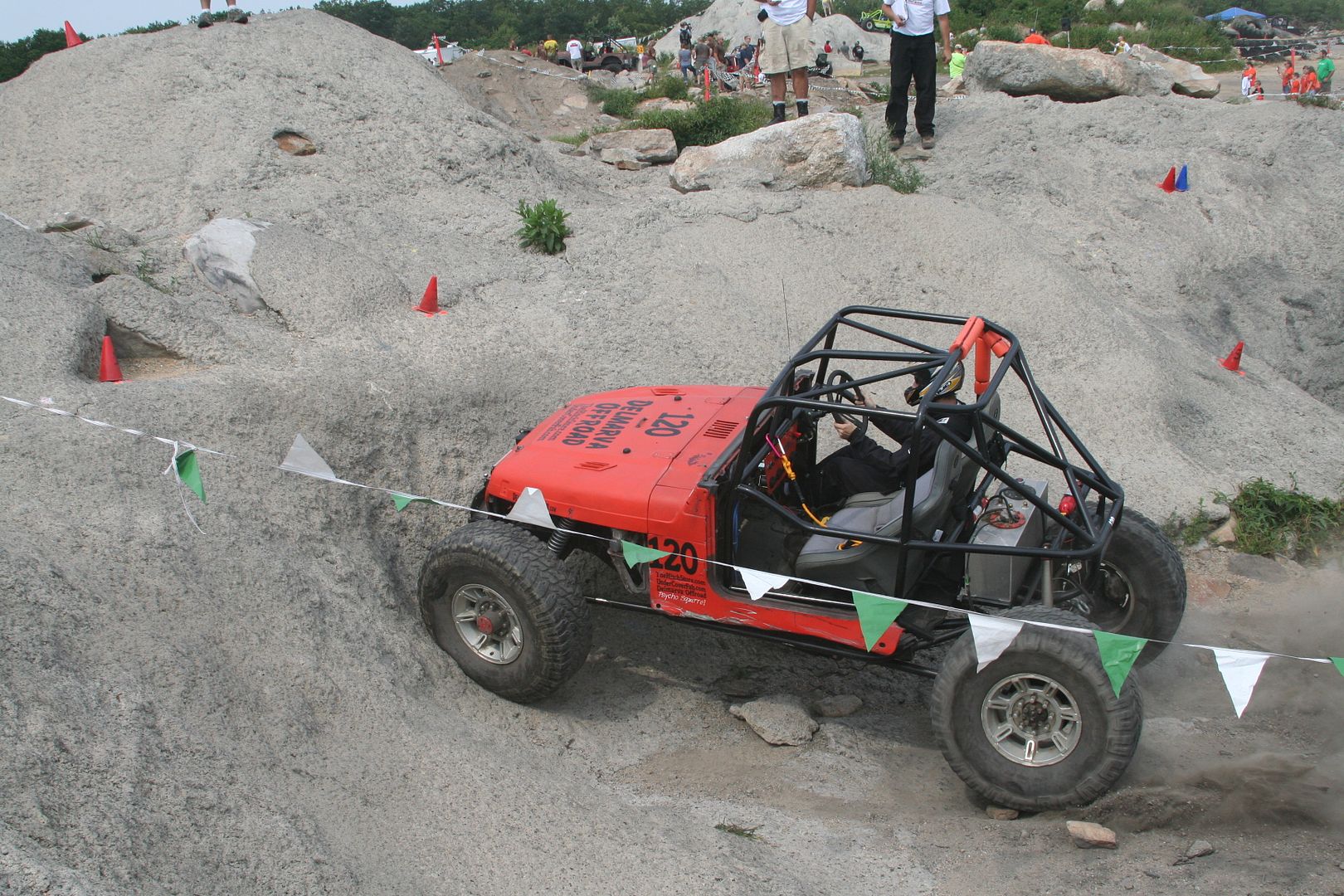

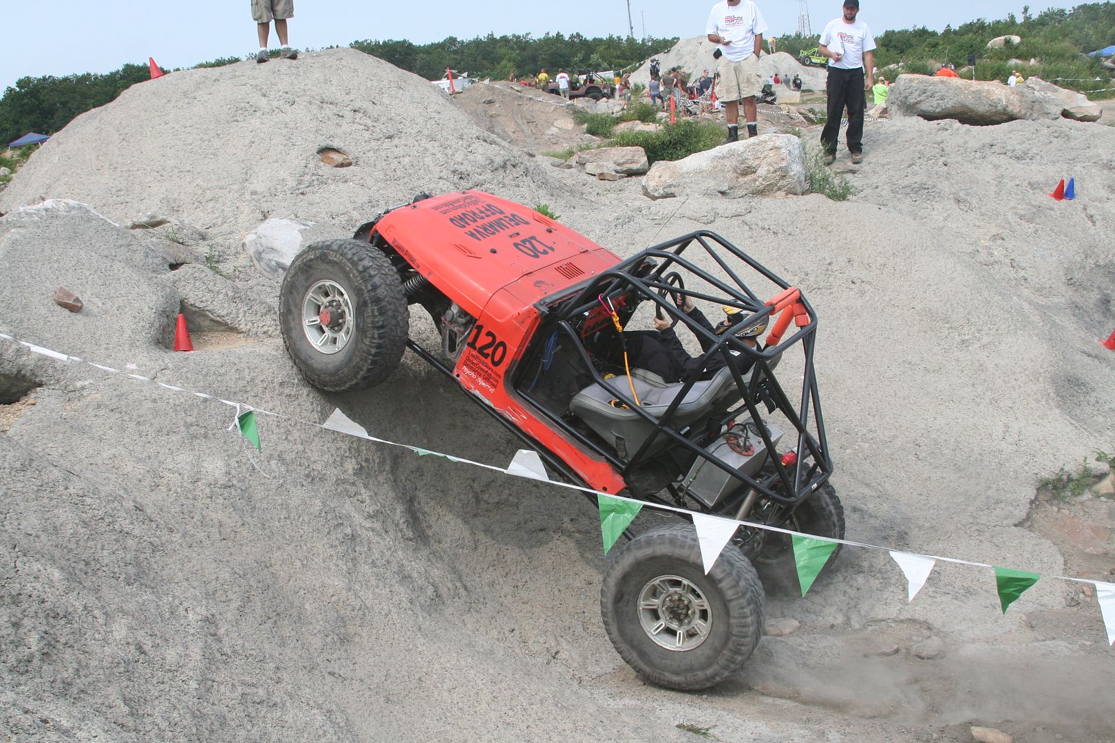

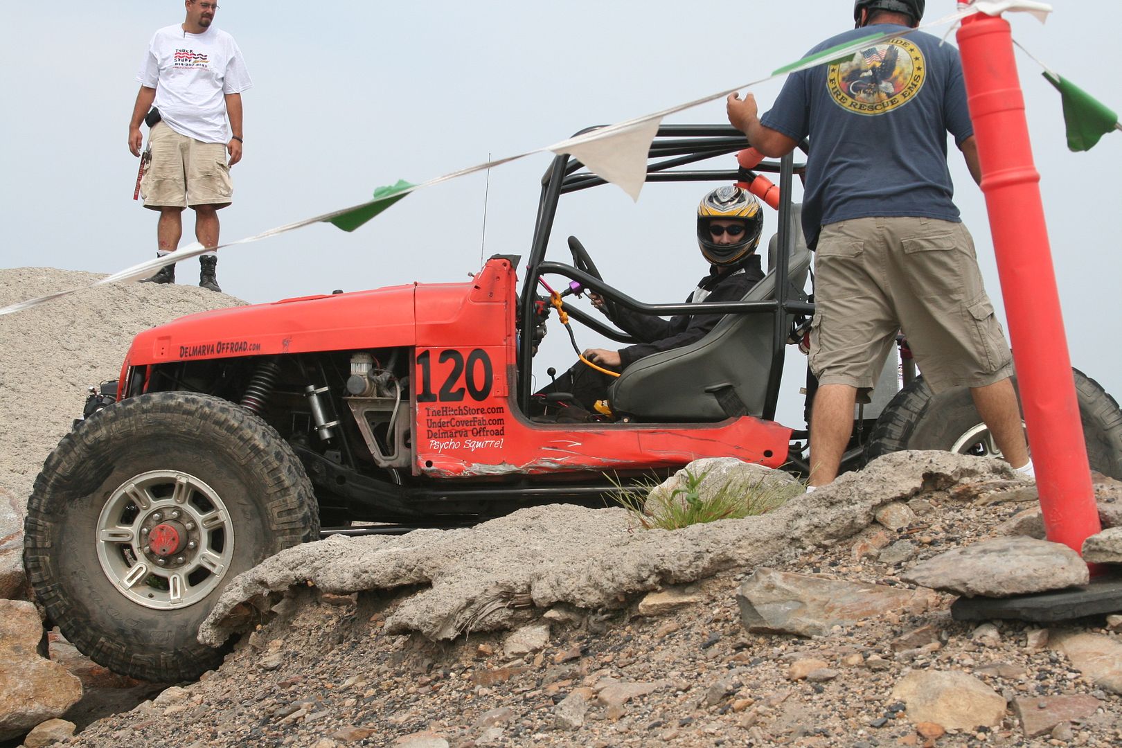

Next up was the shoot out. There was no way for us to repair the rear driveshaft so we decided to give it hell in front wheel drive with an already damaged driveshaft. Our goal was to get atleast one progression point. First gate was a 3 foot ledge that gave us a some trouble. While attempt to climb up ended up a litte side ways. Trying to reverse out of it, it felt like it was starting to connect but at the same time getting very sideways. Ended rolling 3/4 of the way around. Flipped her over, pulled it out, then drove back to the trailer.
It was a fun and challenging event. For the 3rd time out with the buggy I am very satisfied with its performance. The driveshafts were temp ones made from pieces I had around the shop and hoped to make it until the end of the season. Over the off season we will be re-designing the skid plate, tweak the front suspension a little bit, two piece front driveshaft and new rear shafts, along with some sticky tires. We'll be back and ready for next season in May!

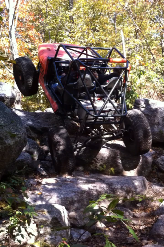

Stilling beating on it after the season is done. Ran a comp practice Saturday and some more trails on Sunday.
Only one picture for now.
This winter I am tearing it down again. Going to be shortening the wheelbase to about 104" (currently 110). Decided I would rather not do too much of the racing, and stick to the competitions for now. Will be boat siding the sides of the buggy. Only sheet metal to be left is the cowl, hood, and grill.
