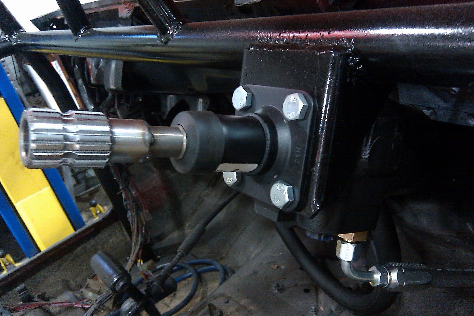

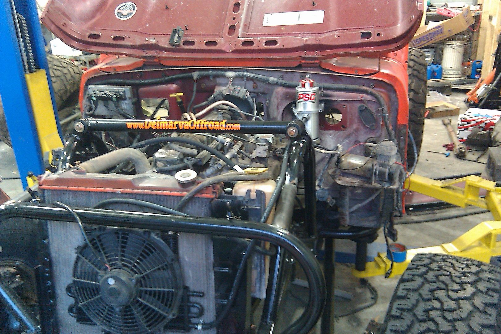

Getting lazy on the pictures now but the front end of the frame is done now. Got the steering resi mount done. Getting started on the plumbing for the steering, but definately going to need to pick up some more hose.
Frame painted:
Resi mount:
New oil filter mount that I have an extra temp and pressure sender on.

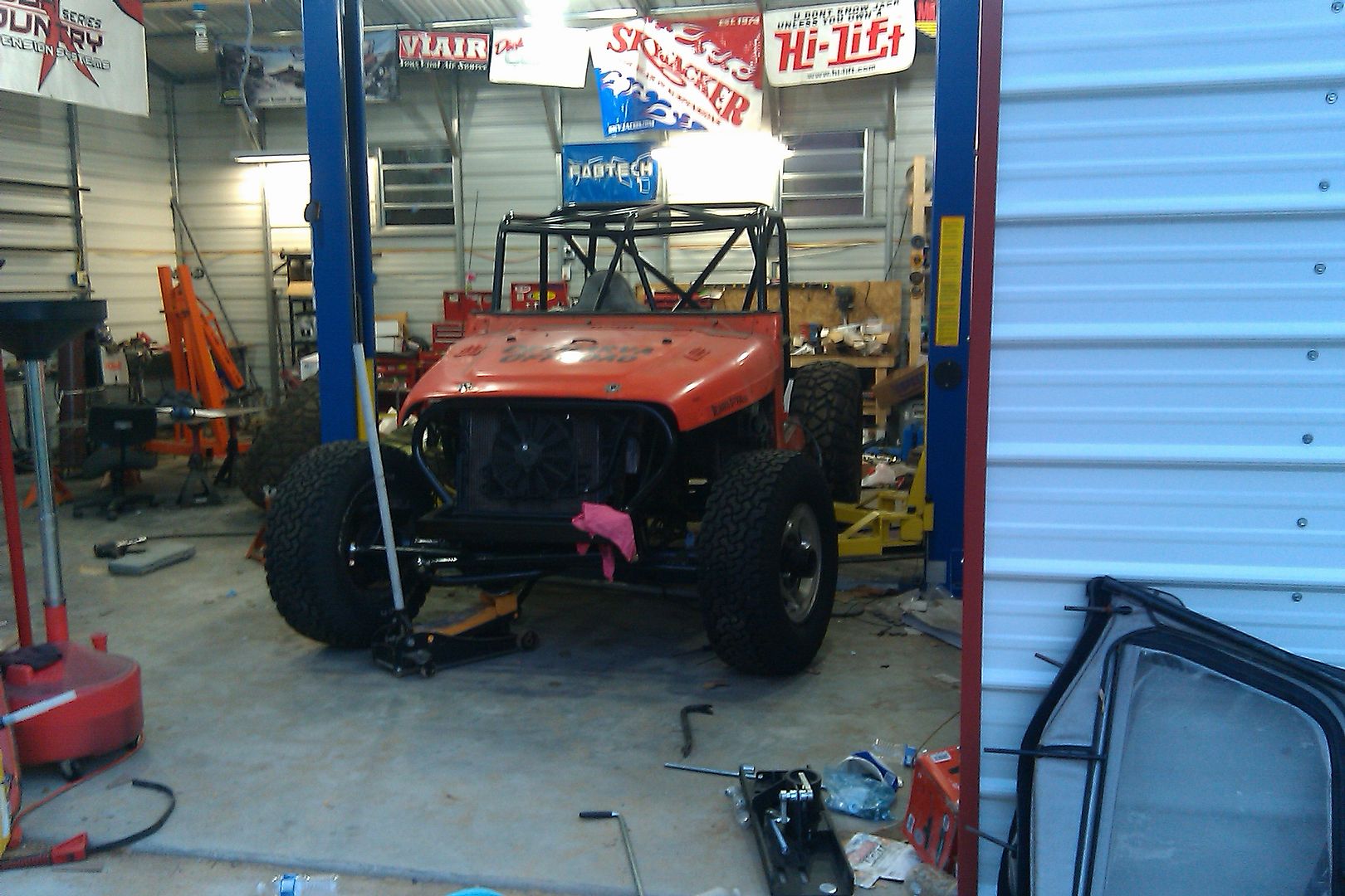

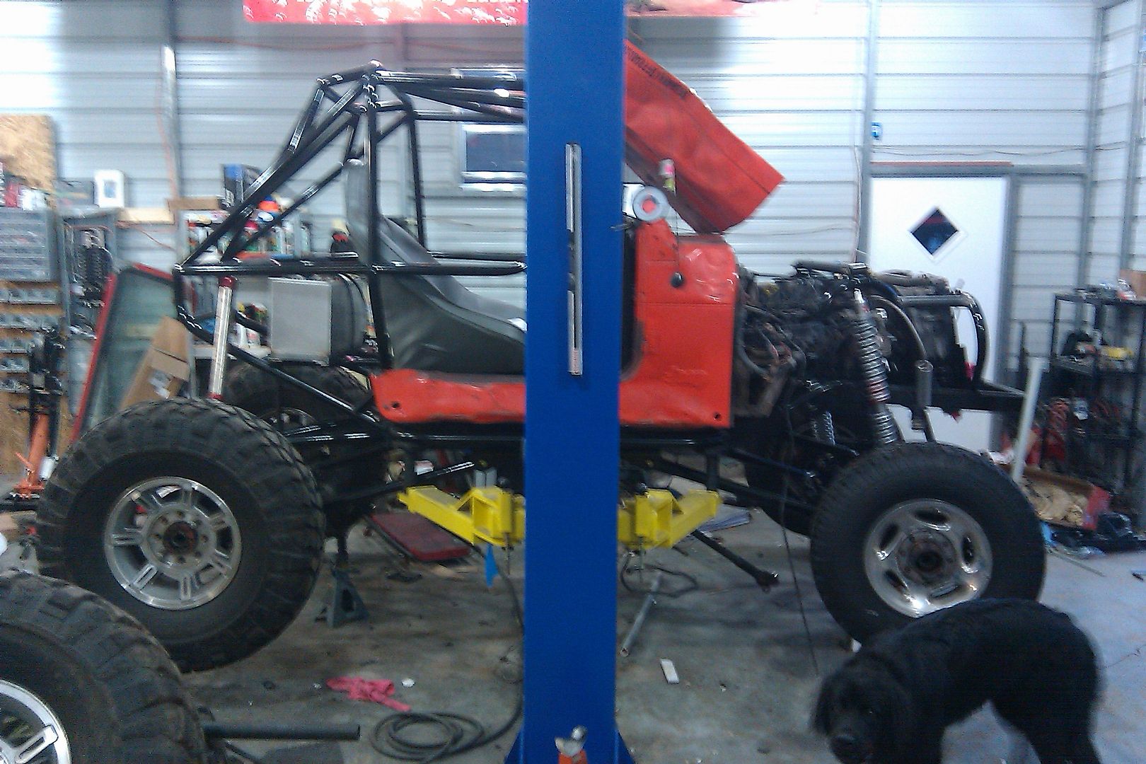

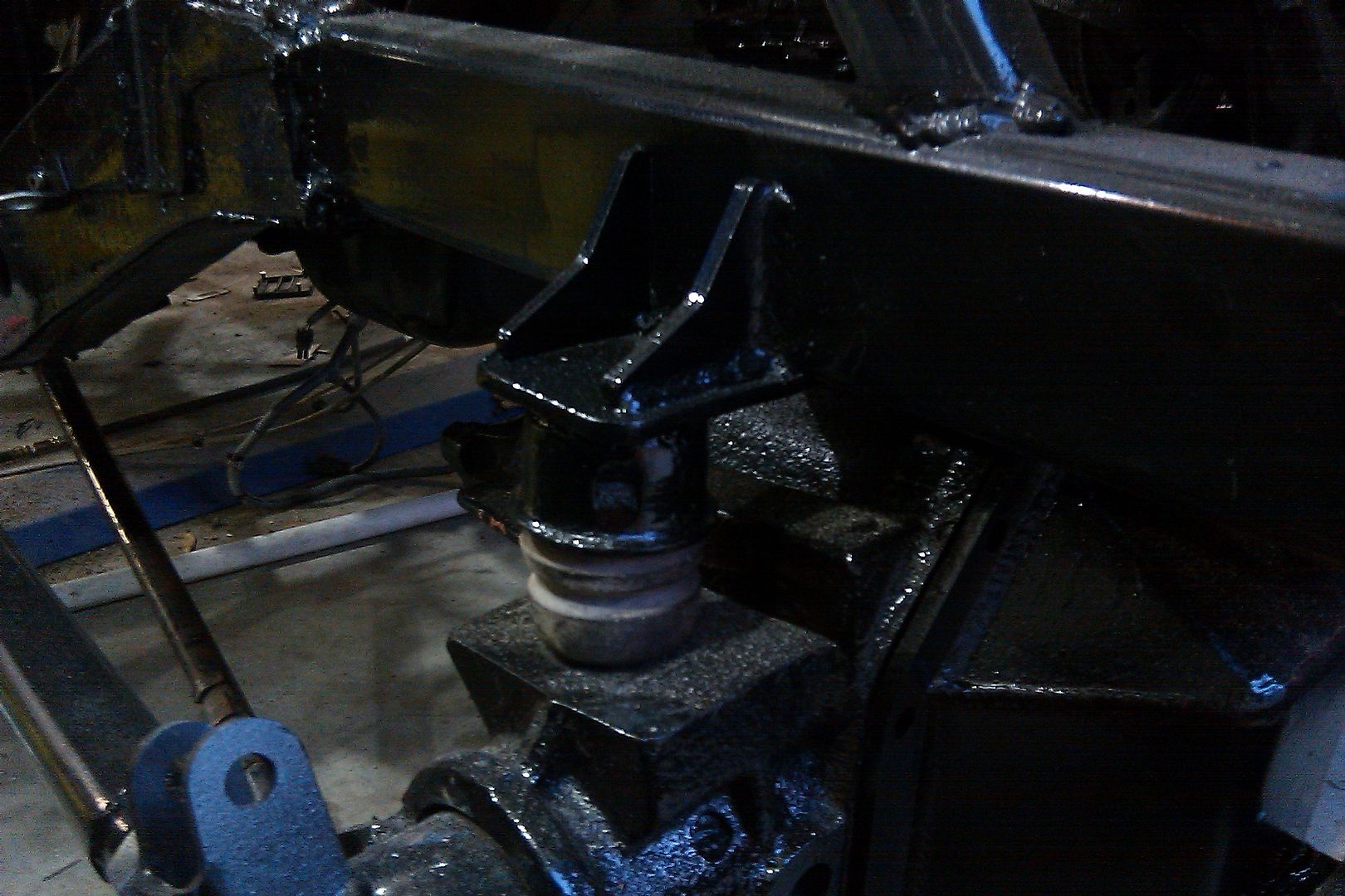

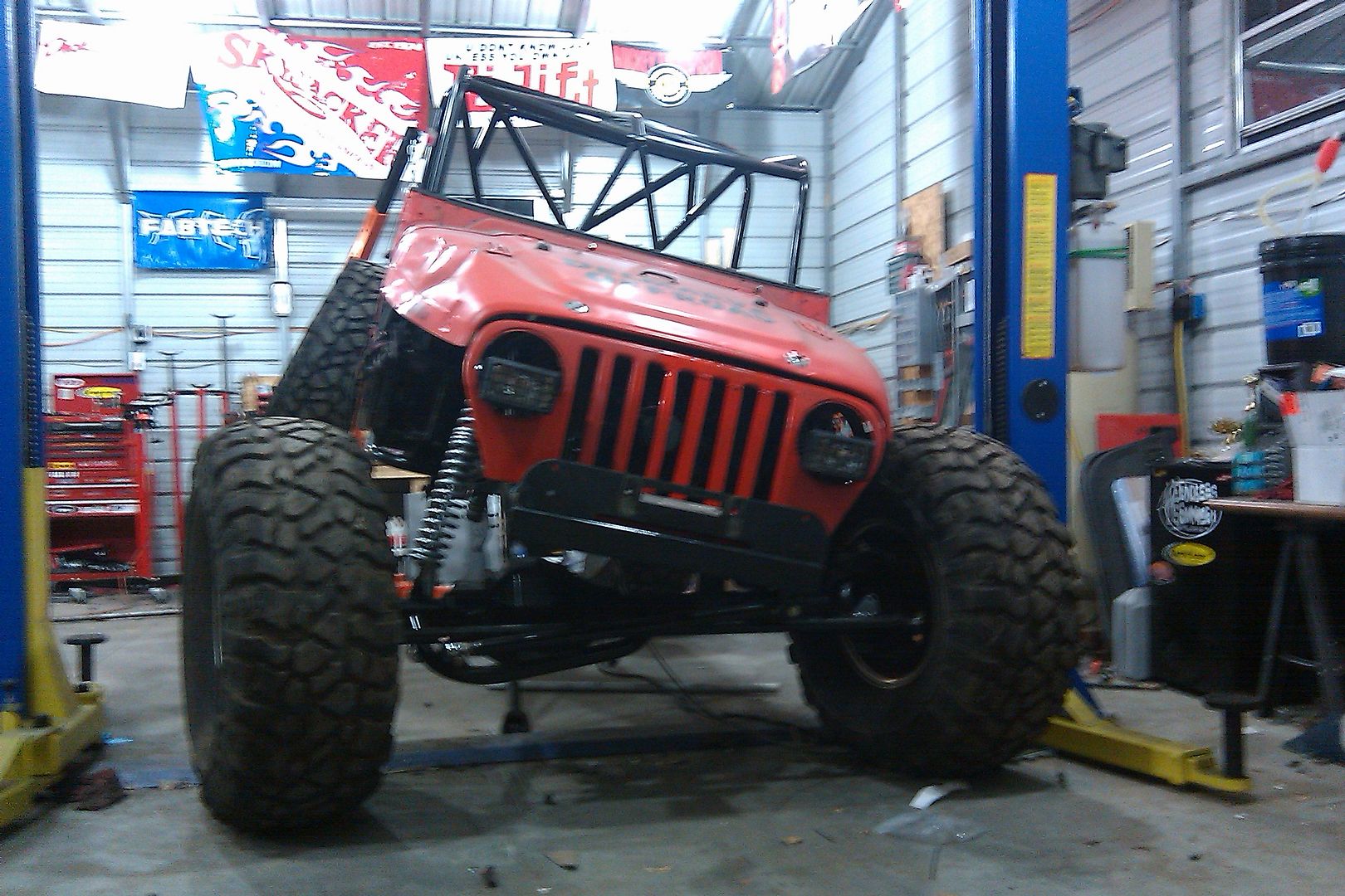

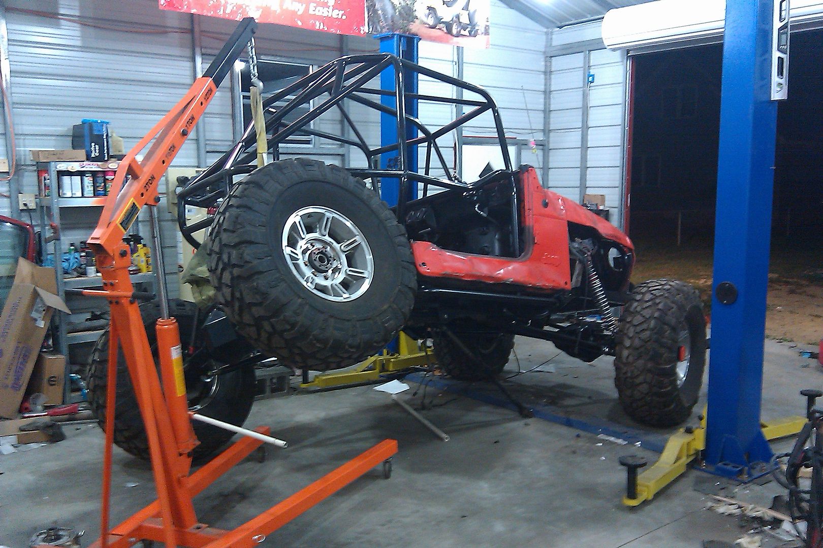

Got it back on the lift to get the buggy finished up
Just so random pictures of how it sits right now.
Engine cage/coilover supports. Also got the steering plumbed.
Bump stops:
Full droop:

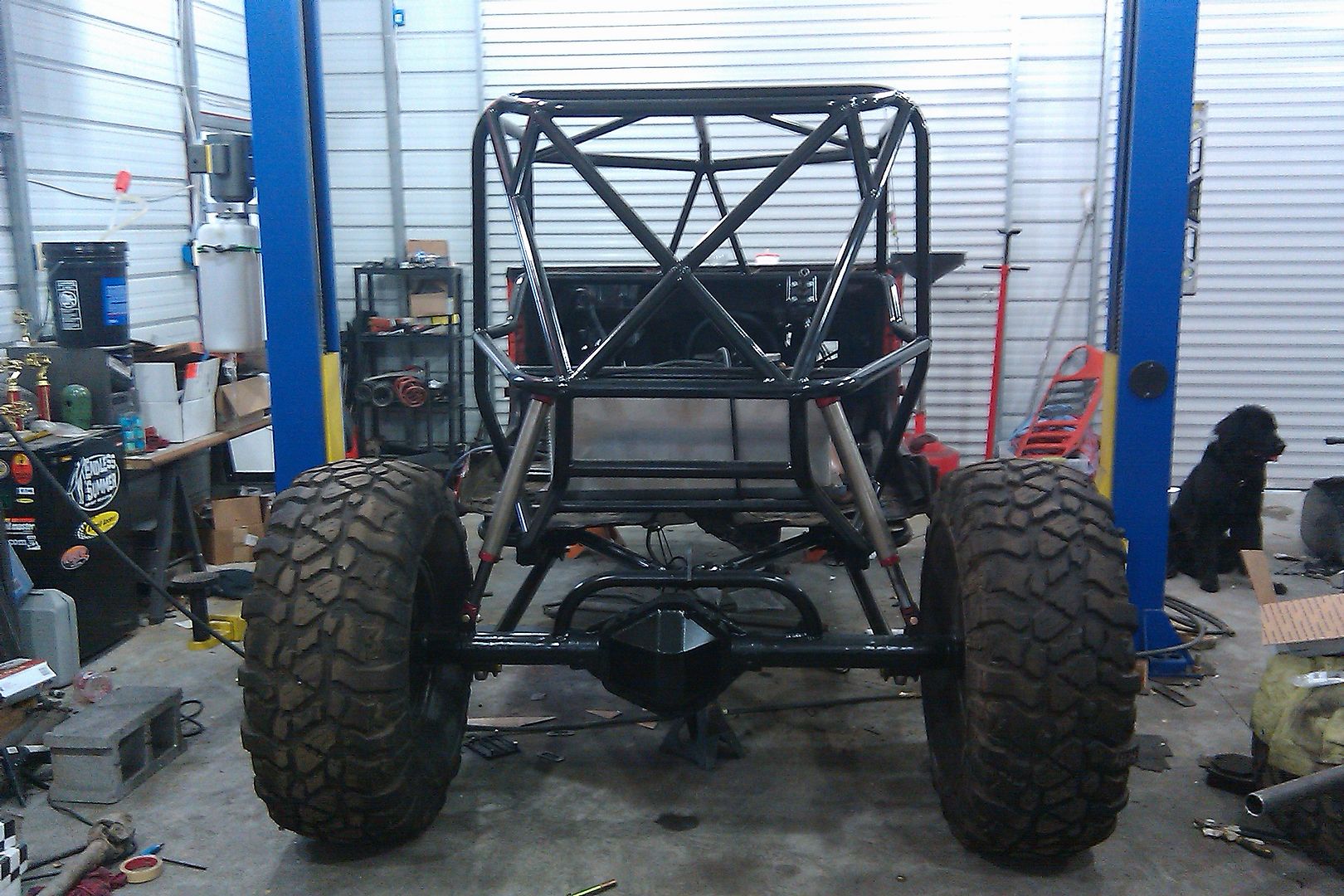

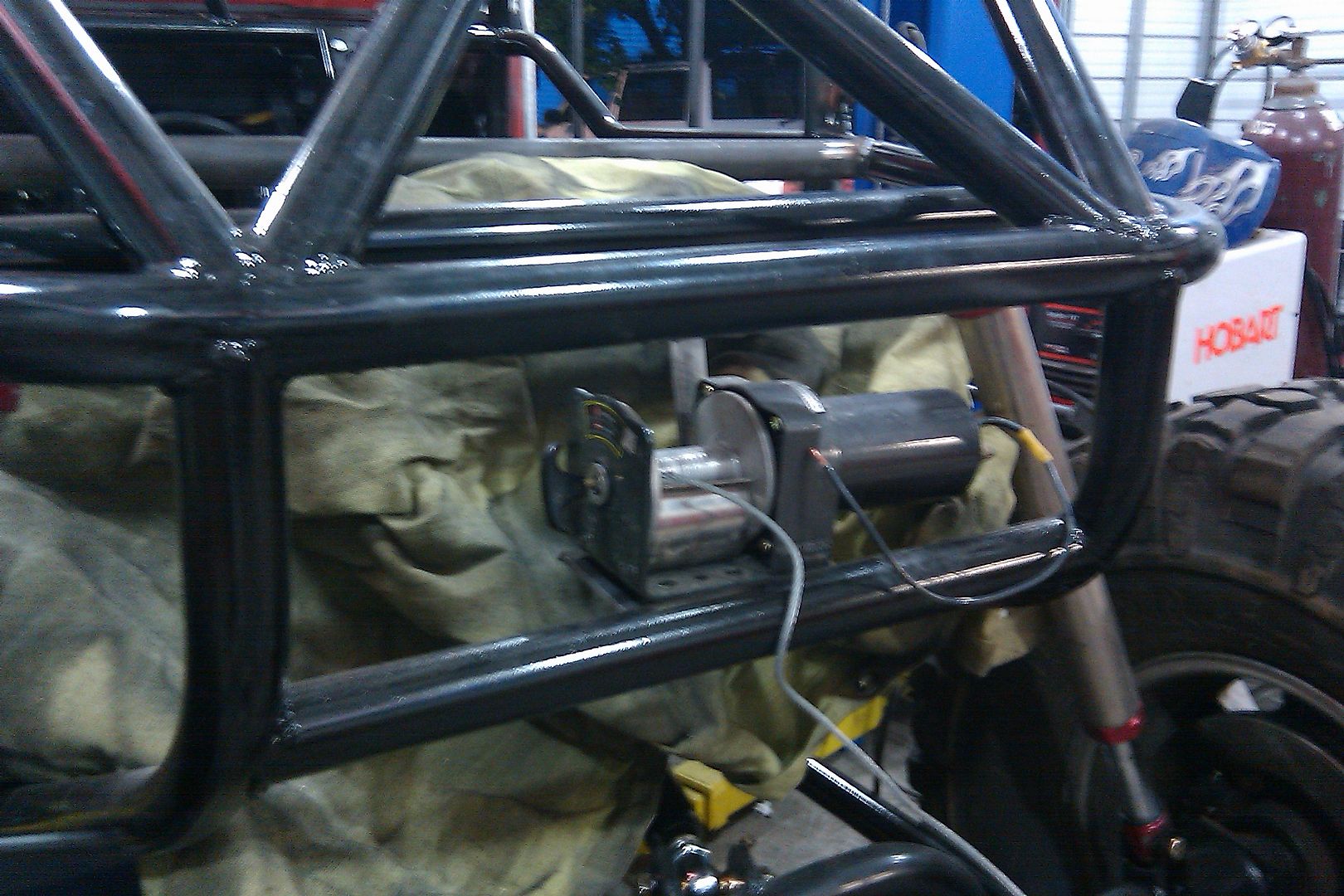

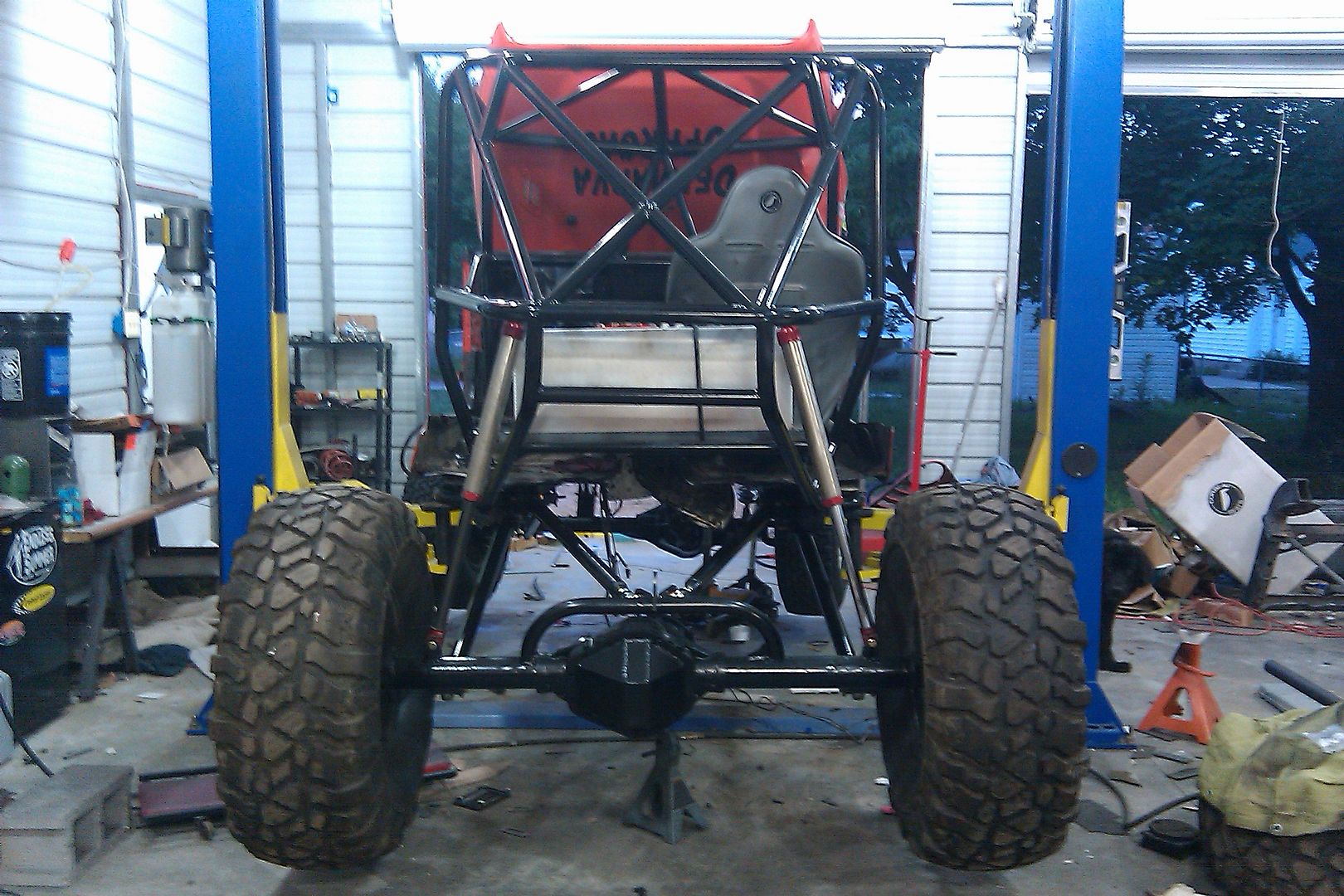

Shocks are filled, I think the rear may go an inch higher:
Rear suck down winch mount is done:
Harness bar and cage gussets on:
Attempted to cycle the suspension:

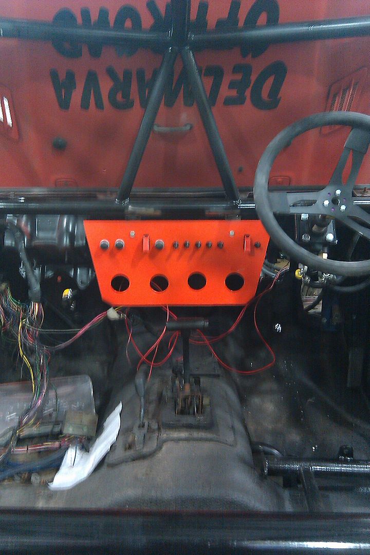

Brakes are getting plumbed today. Steering will be finished up. Going to also attempt some driveshafts and then she should be good to roll. Then make a basic switch panel for now to get her started. Still need the skid plate done and a few other odds and ends.

post #82 of 185 Old 06-12-2010, 07:55 AM Thread Starter
mferrari
DelmarvaOffroad.com
mferrari's Avatar
Join Date: May 2005
Location: Ocean City
Posts: 2,646
Decided not to plumb the brakes yesterday. Instead I ordered two nylon brake line kits from speedway (just so I have enough as well as spares for the trail). Should make plumbing a bit easier and allow me to snake the lines down control arms like you would an ARB line.

She runs and steering works after I switched the lines around since I plumbed them wrong...

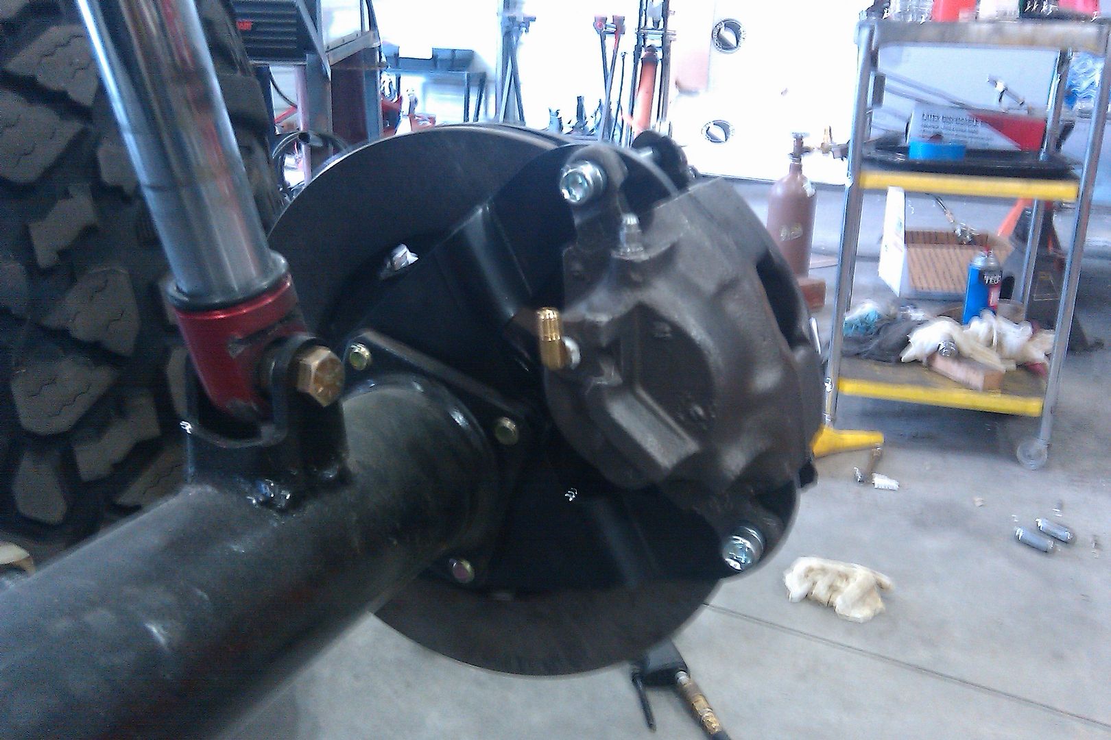

Rear axles and brakes are assembled. Just need to finish plumbing them. Winch came in for the front and along with the last 1310-1350 conversion joint for the rear shaft. Should be the last of the parts I need to get it moving for the weekend (minus u-bolts for the 1350 yoke)
Also hooked up the cable shifters on the D300. Think I am going to just run the 231 crawl box locked in low for the weekend and worry about a shifter cable mount later.
Goal for tonight, get all brake **** finished. Fill fluids, drive it in fwd to see how she rides, and atleast start on the skid plate tongiht.

There is the temp dash until I get the interior worked out

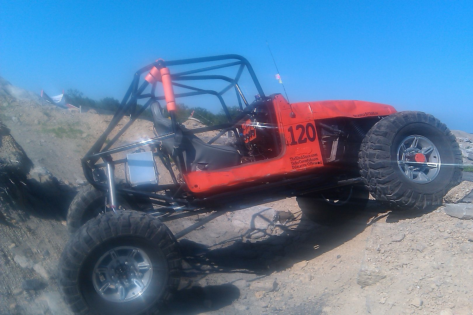

Just something different...

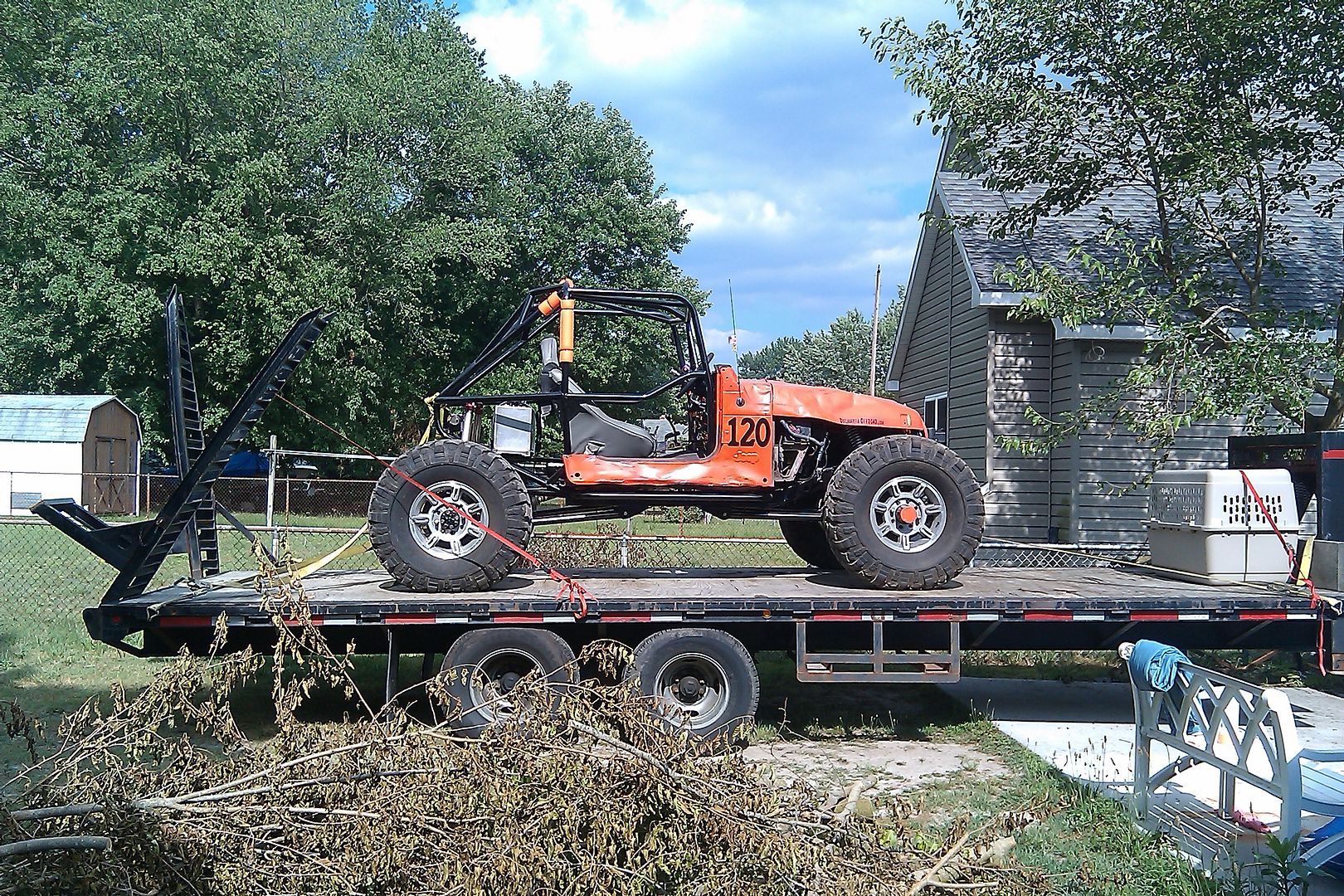

Just got back from RCrocs out at Rausch Creek. Needless to say it was very eventful...
Friday I finished laying the last bead on the buggy about 6am. Packed and left. Got up about 3pm, my spotter and I wanted to try and run some various lines to test buggy. It was a damn good thing too. Started with something inside of the crawl box popped and lost low range in it. Also started to leak fluid from it. Got her in high and went on with the testing. Second course we ran, the driver rear air shock siezed. Went back to the trailer, took of the shock and ripped it open. Shards of metal were inside and the shaft, seal, and body were all scored up. It was about 6pm and no shock oil on the truck, and no stores open to get it. Decided to run some ATF inside since it is thicker, maybe it would not leaked out. Filled it some, added nitrogen and it worked.
Ran a few more lines and called it quits for the day.
Tech'd in morning, refilled nitrogen in the shock since it leaked out over night and then she was ready to roll.
First course, we ****ed up. Being the first comp both my spotter and I have ran we didn't take time and did not communicate enough. Took 2 cones, then tapped a 3rd. On the drop, used too much throttle and hit the finish gate cone and we pointed out.
Second course, we high centered on the first gate. Got it down then tried to throttle over again. Land hard enough to cut power on the buggy. While we worked to get it back started, the broken crawl box decided to leak fluid. Got the buggy down to stop the leak, tried again then lost the fuel pump. 40'd out and ended our day. Pump was shorting out and was unable to find the problem.
Going to tear it down and fix everything this week. Next weekend we are heading back out for some trail riding and more test and tuning.
Here a just a few pictures I got Friday:
