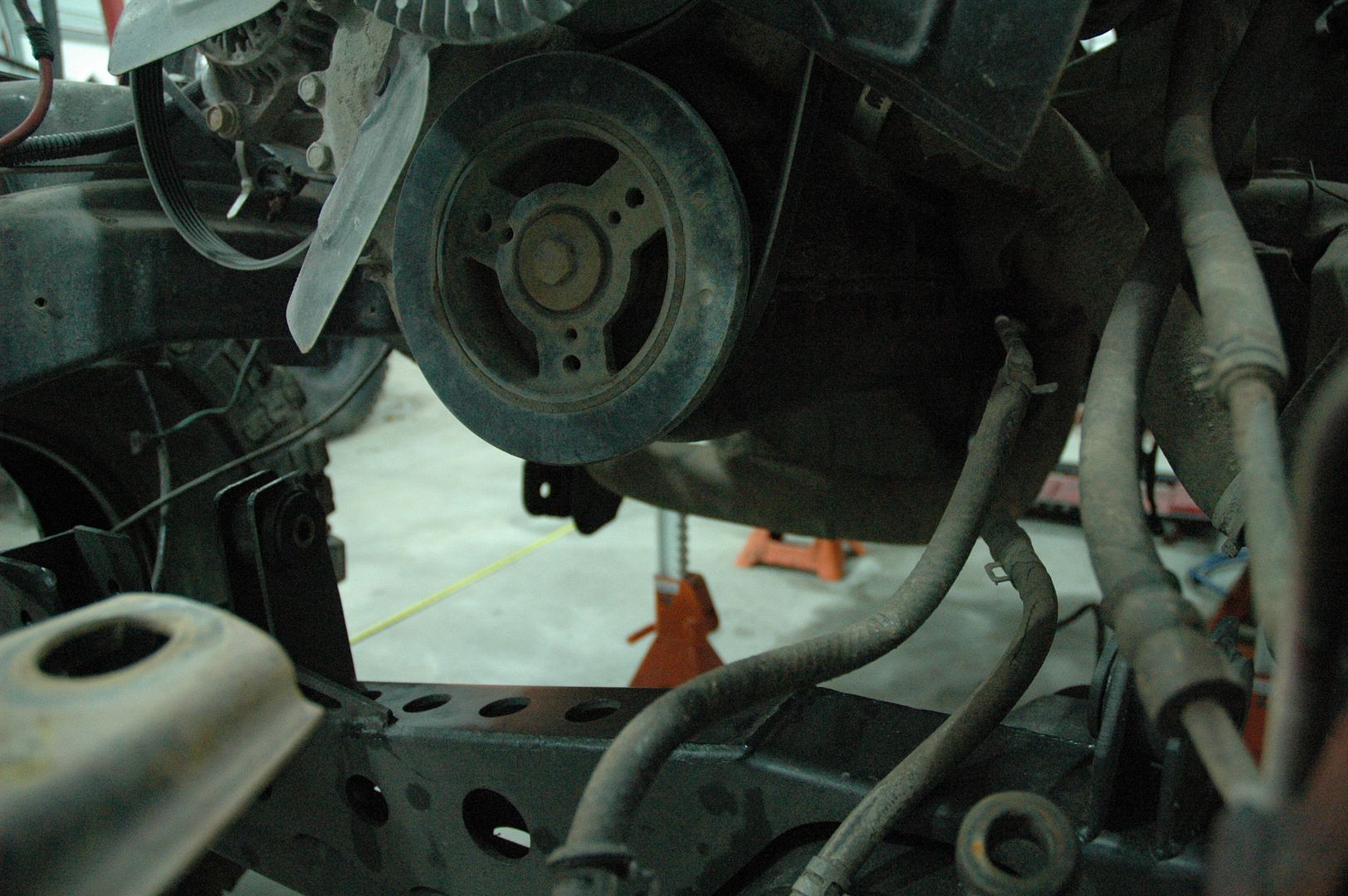

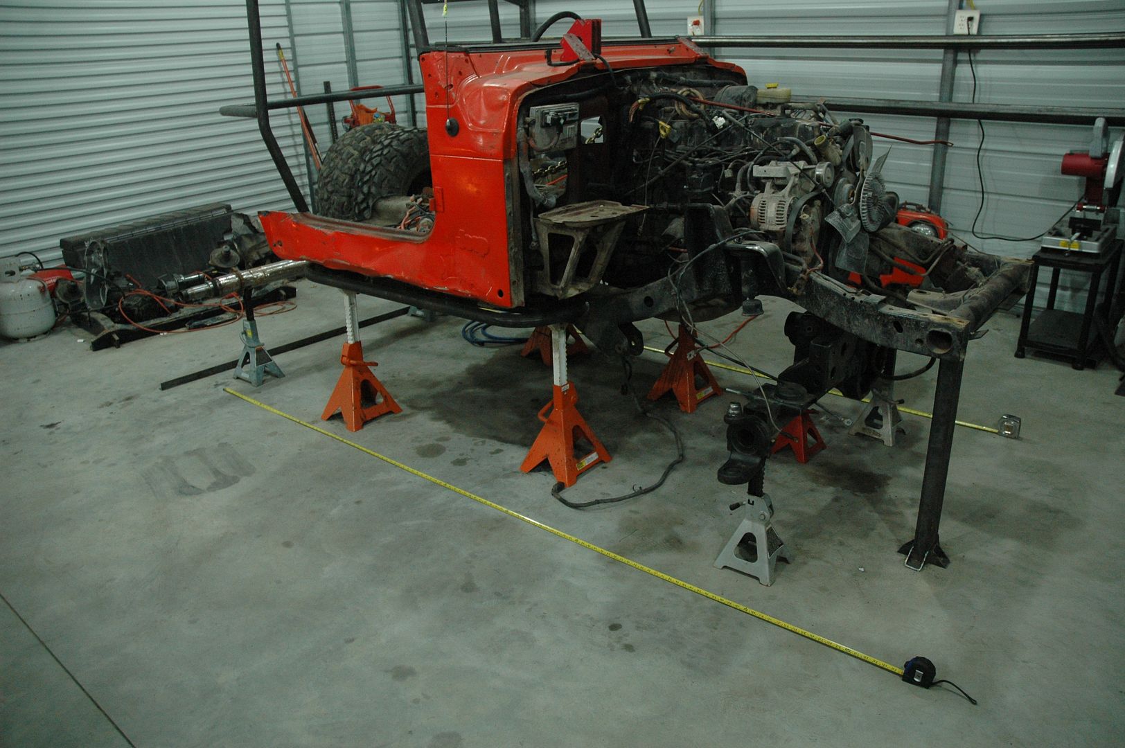

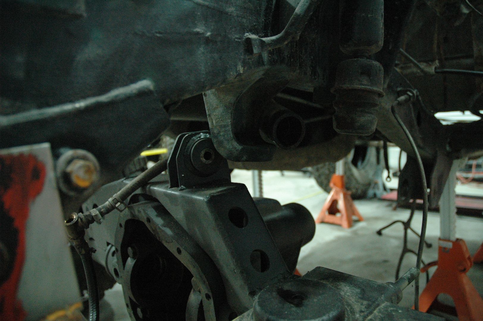

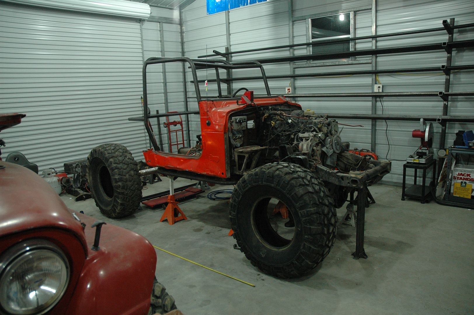

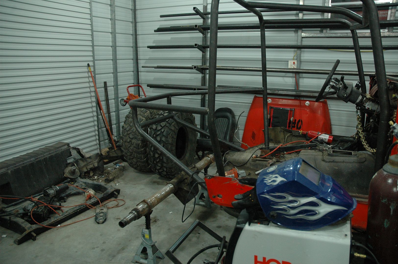

Worked on it a little bit today.
Got the axles mocked into place for a 104" WB.
My front D60 has a truss with TJ brackets on it (decided to change plans and build the buggy) so I was hoping I could knock off one upper and reposition the other to make it work but it seems the truss is just too big for the front right now. At ride height I want the axle about 3" higher than it is now and you can see I will have clearance issues with the belts trac-bar...

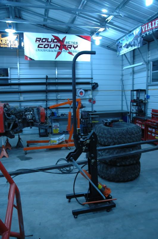

As for the bender... Since I am ProBender and ProTools dealer I must brag. I am using the Pro Bender full hydro vertical bender. By far the most effortless bender I have used and uses Pro Tool dies. All the tube bent so far is with a Pro Tools 240* 6" radius die which will allow you to a bend full 180*.

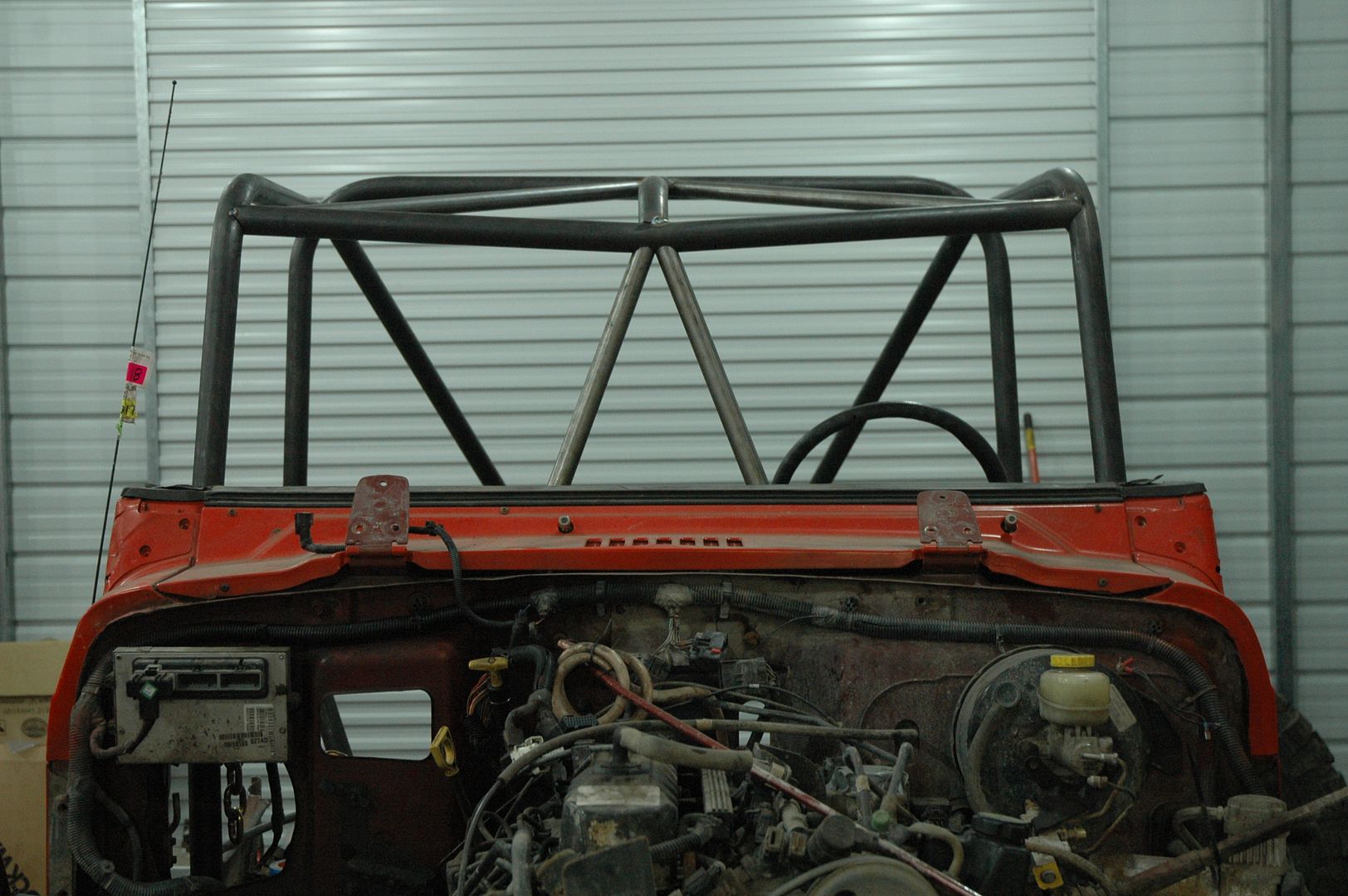

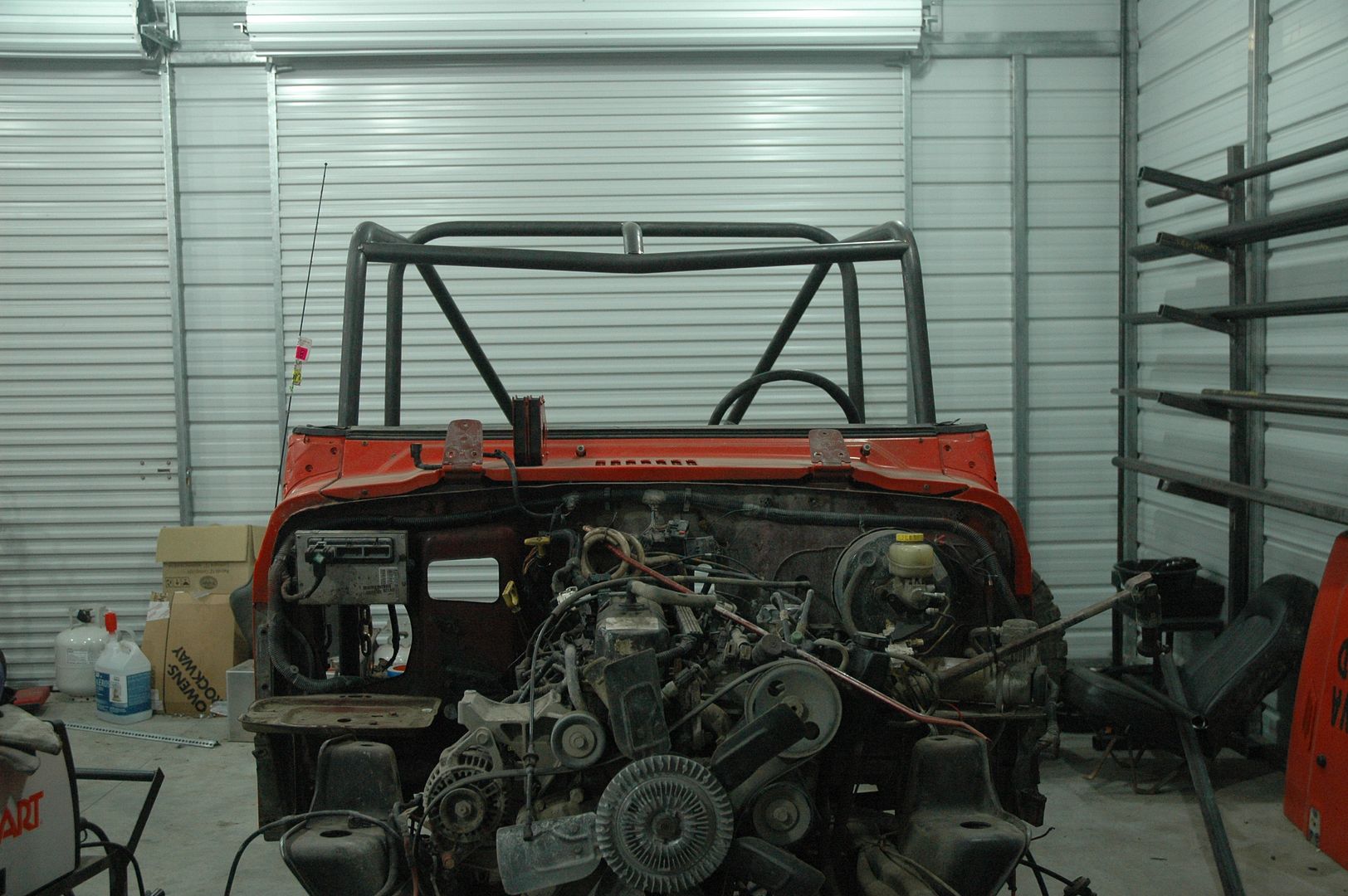

post #23 of 185 Old 01-23-2010, 08:06 PM Thread Starter
mferrari
DelmarvaOffroad.com
mferrari's Avatar
Join Date: May 2005
Location: Ocean City
Posts: 2,646
Originally Posted by NEPAjeep02 View Post

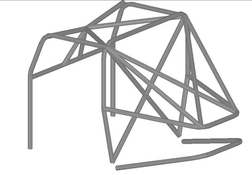

Are you going to be putting tubing in the center of the windshield? Is the cage done?

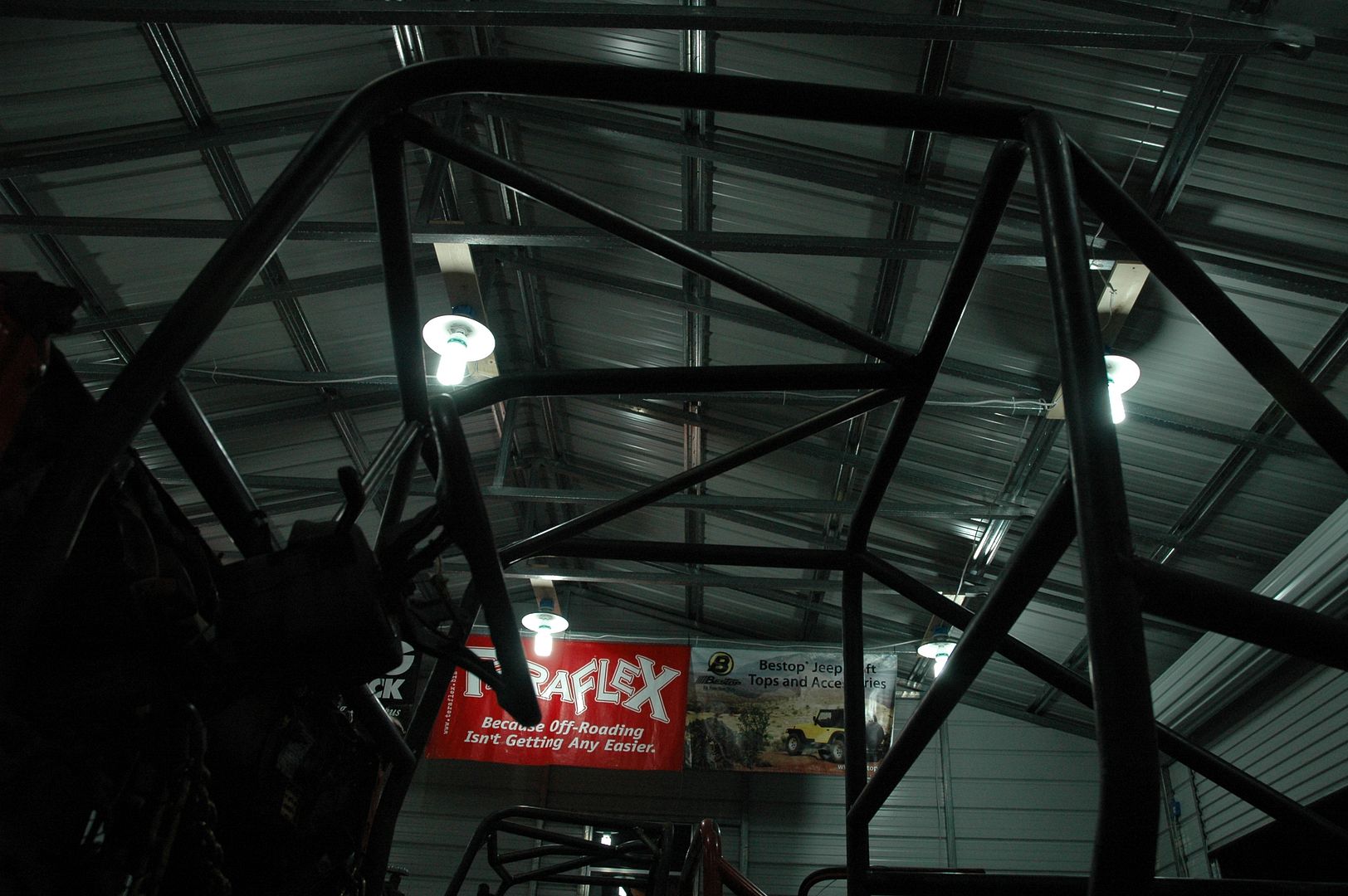

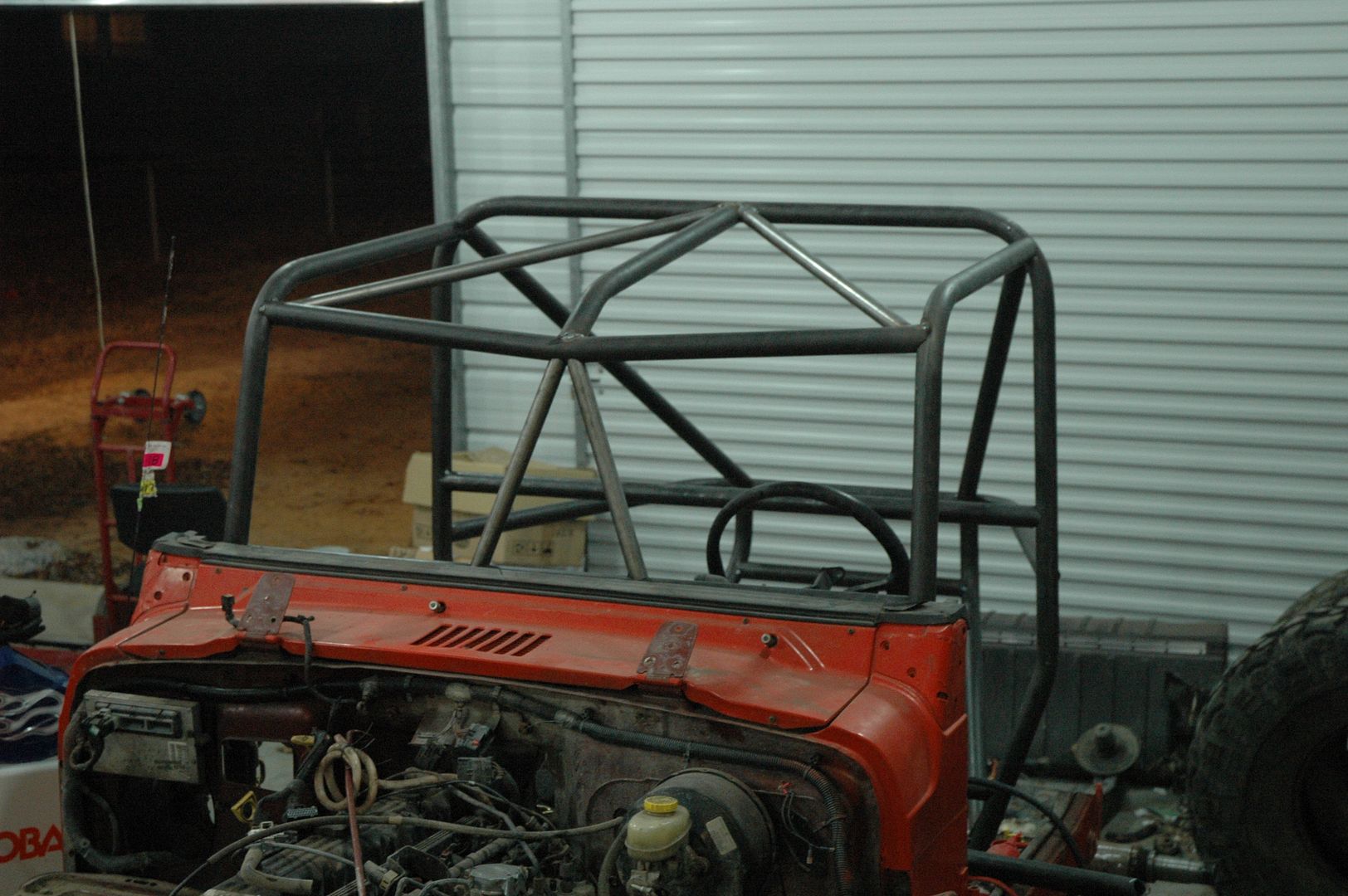

Yes and no where close. Still alot of tubing left to bend and add in.
This was my rough idea (not including kidney bars either).
Today I sold the HP60. Going to be looking for another so I should have the replacement shortly.

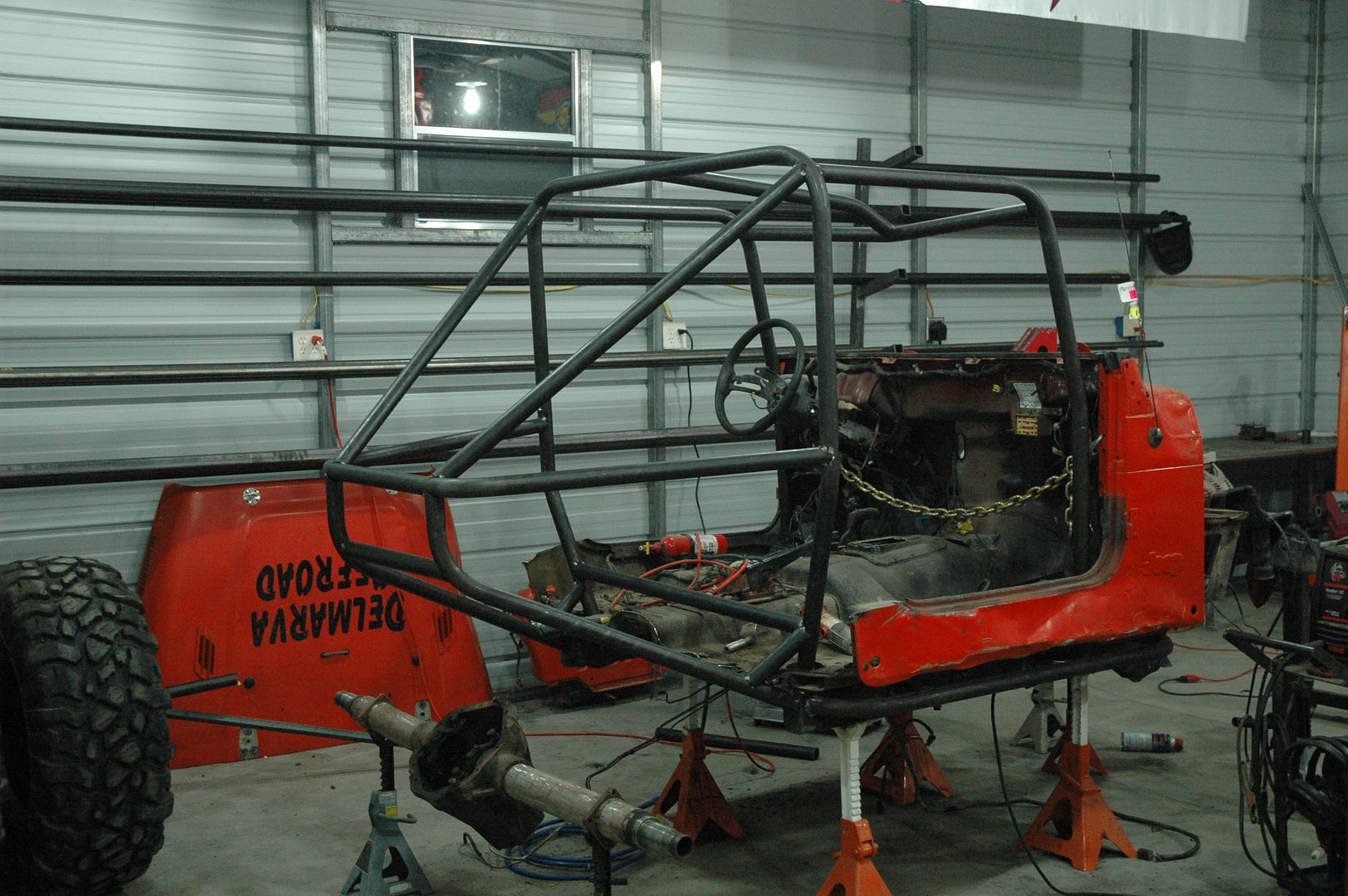

post #24 of 185 Old 01-24-2010, 07:13 PM Thread Starter
mferrari
DelmarvaOffroad.com
mferrari's Avatar
Join Date: May 2005
Posts: 2,646

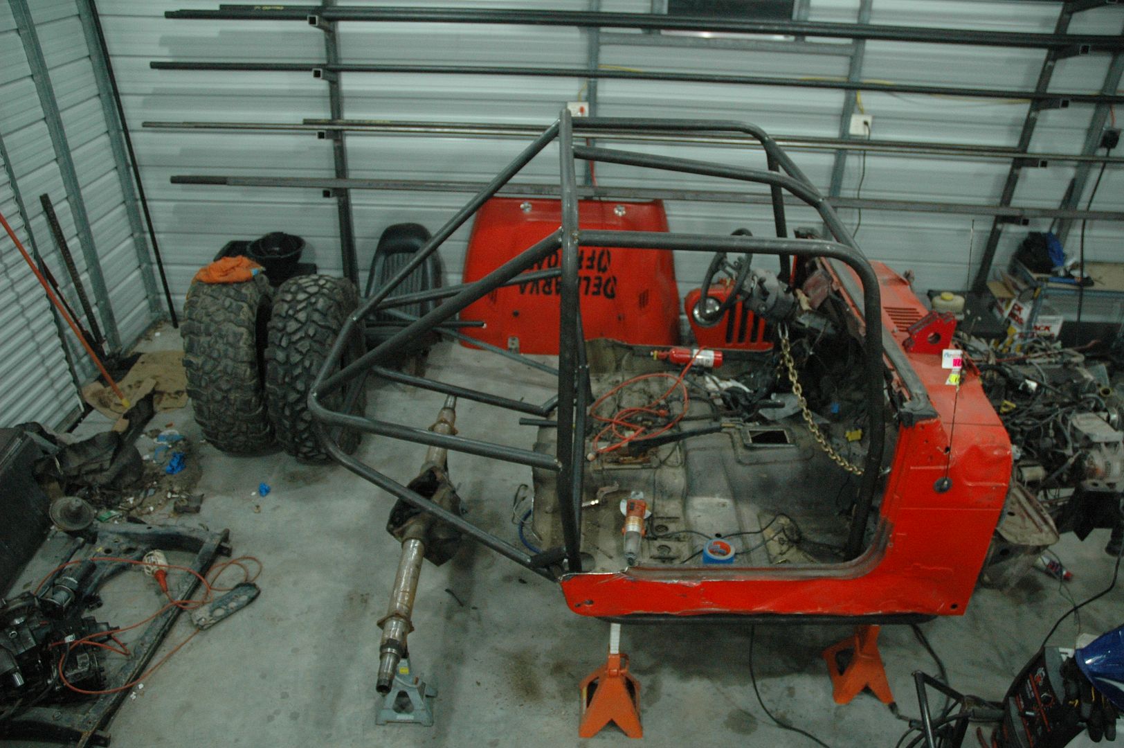

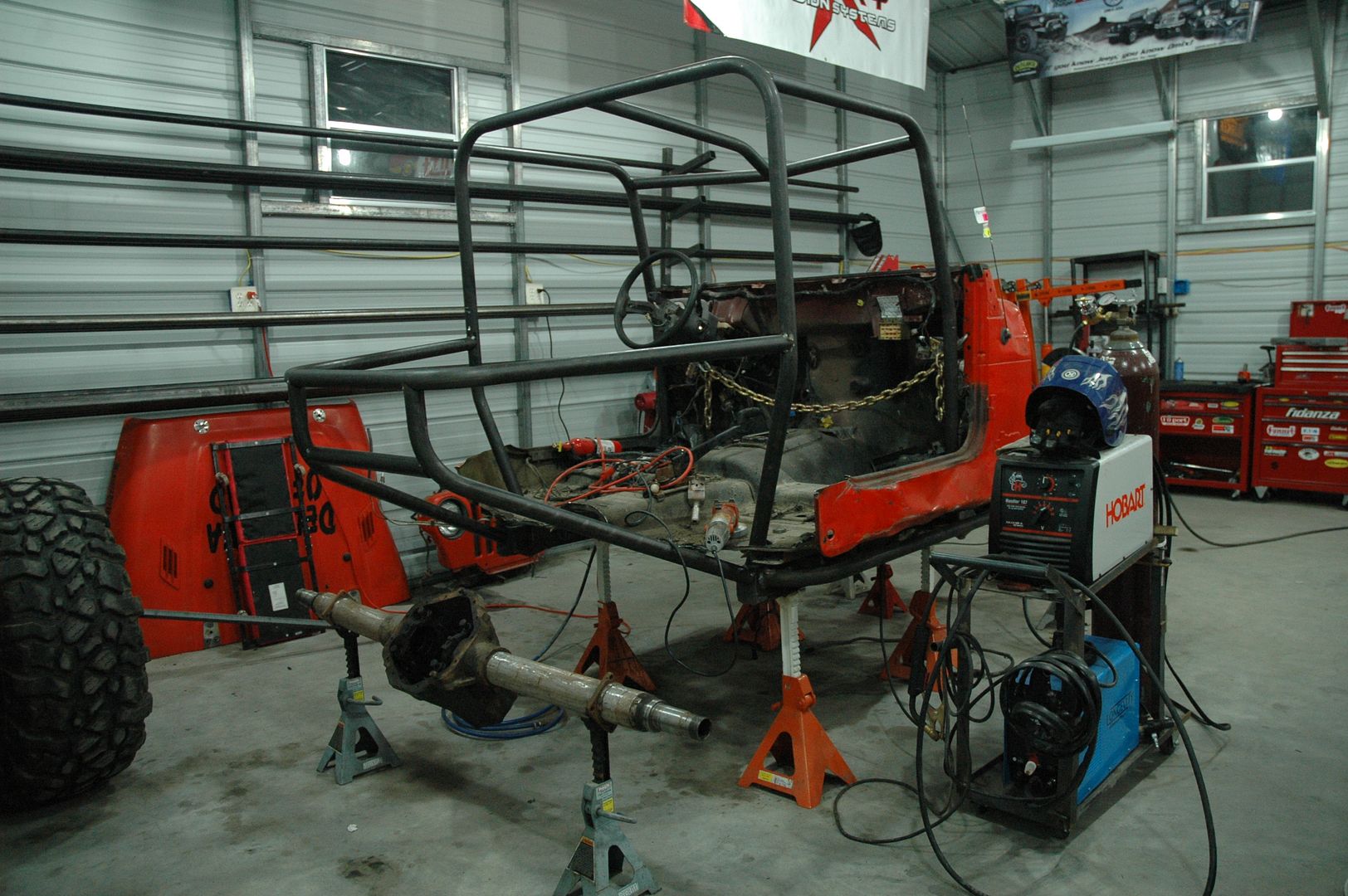

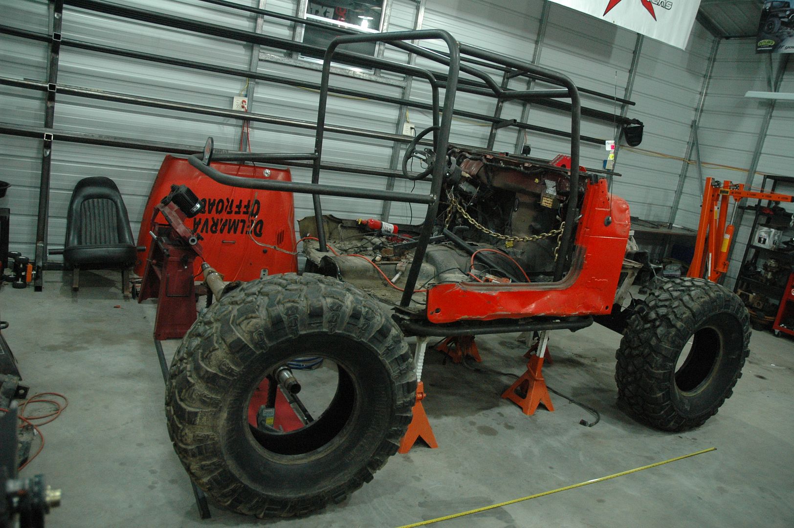

Got a little bit more done today. Chassis is almost done except for some little bracing and gussets and the kidney bars.

post #25 of 185 Old 01-24-2010, 07:45 PM
NEPAjeep02
NEPAjeep02's Avatar
Location: NE Pennsylvania
Posts: 435

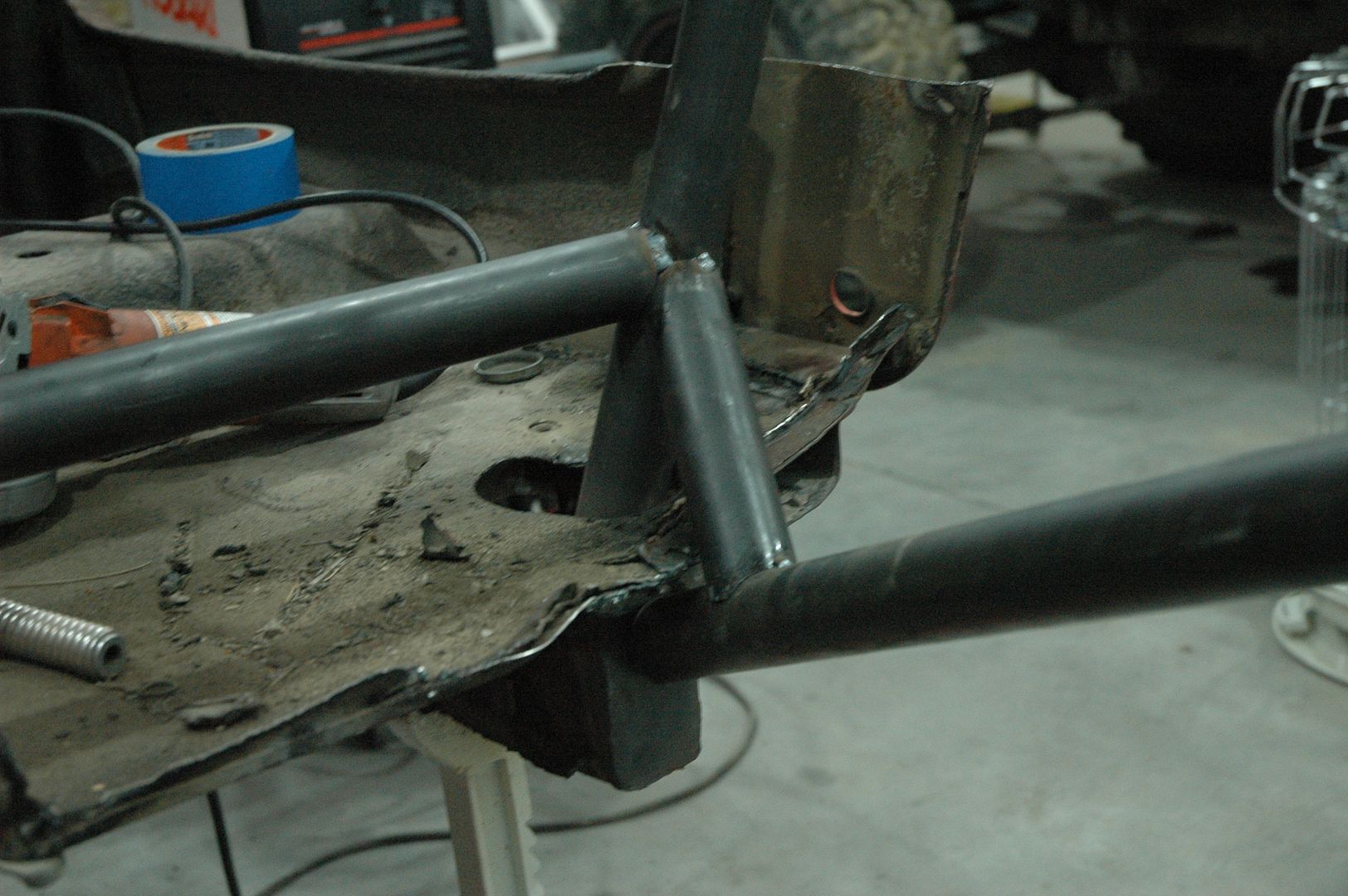

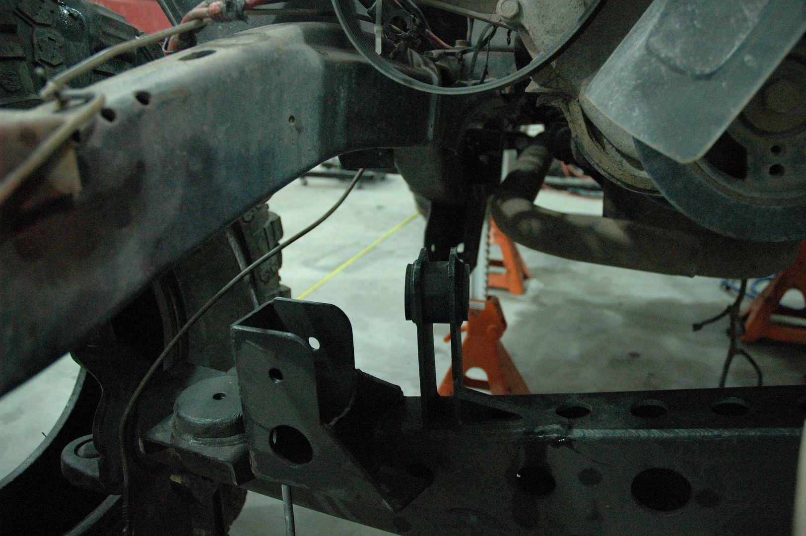

Looks like you're going a little different route on the frame. I like it though. Can you take a pic of how it's tied into the frame? I've heard of people using poly bushings.
2002 Jeep TJ X - See sig

post #26 of 185 Old 01-24-2010, 07:53 PM Thread Starter
mferrari
DelmarvaOffroad.com
mferrari's Avatar
Join Date: May 2005
Posts: 2,646
This is all tied directly into whats left on the factory frame since it will pretty much be a uni-body buggy. On the cages I do in the shop though you use floor plates and then on the underside plates with a bushing and frame tie in.

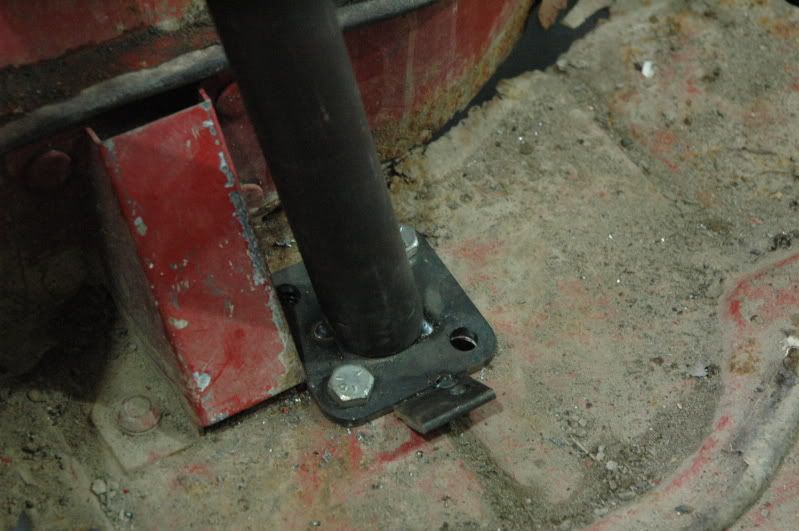

This is a picture I found of a mock up from the Scrambler cage I had in the show. This is out floor plate and on the underside I have another plate and a bushing with two tabs mounted then a tube to the frame.
(edit: the plate is the flat portion but I tacked on the small tab for our ground clamp on the welder)
Some people say a bushing isn't needed, but others complain of vibrations w/o bushings. I normally do them unless the customer doesn't need them. If you need plates of bushings let me know.
