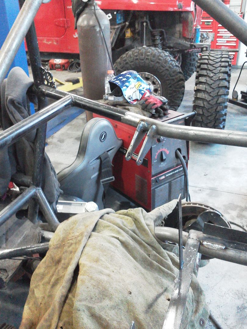

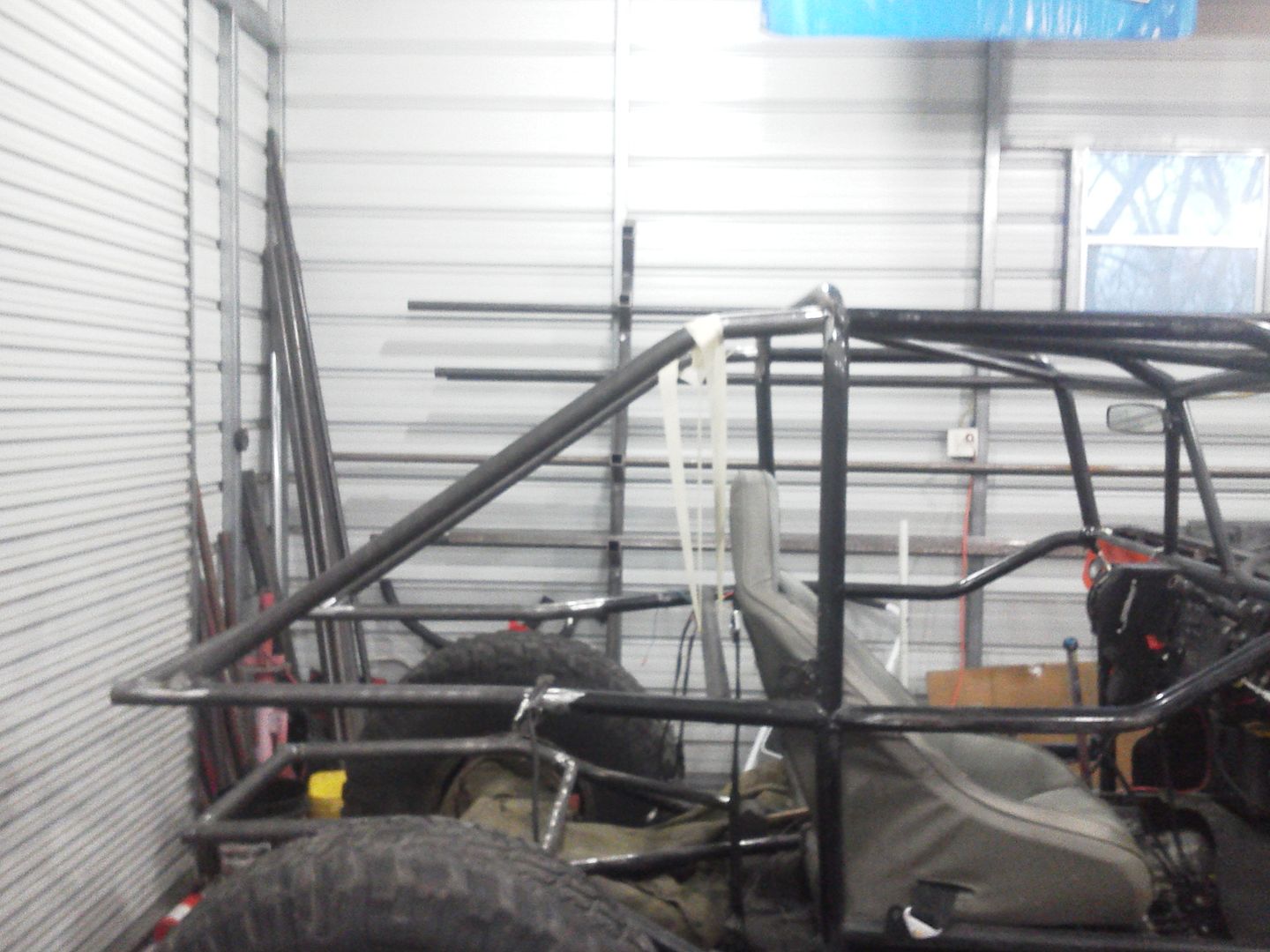

Well thinking ahead. Trailing arms take me out of KOH stock mod classes, so instead of doing trailing arms, I just did this:
Goal is to move **** back. Fuel cell behind the axle, rad right over the axle. Spare off the rear. And should leave some storage room for tools as well.
Playing with the cell location:
Keep it wide and back:
Or Narrow and a little further forward:

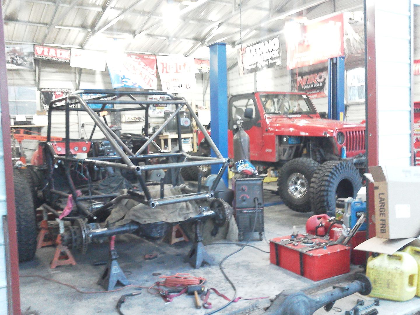

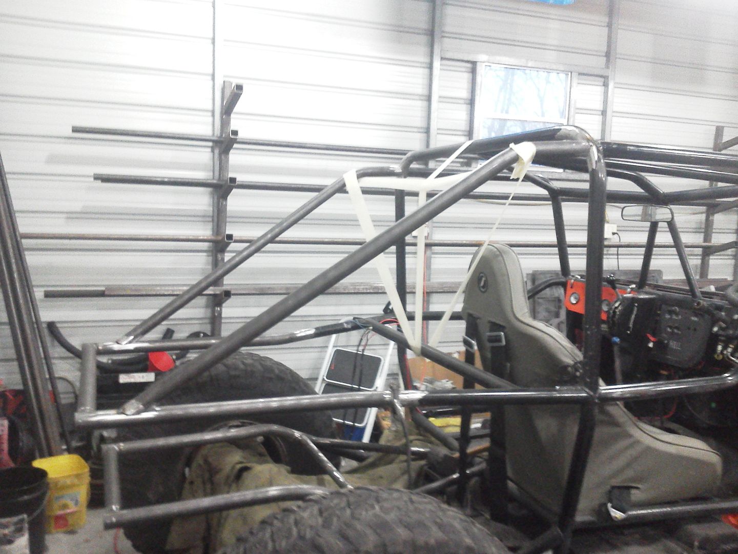

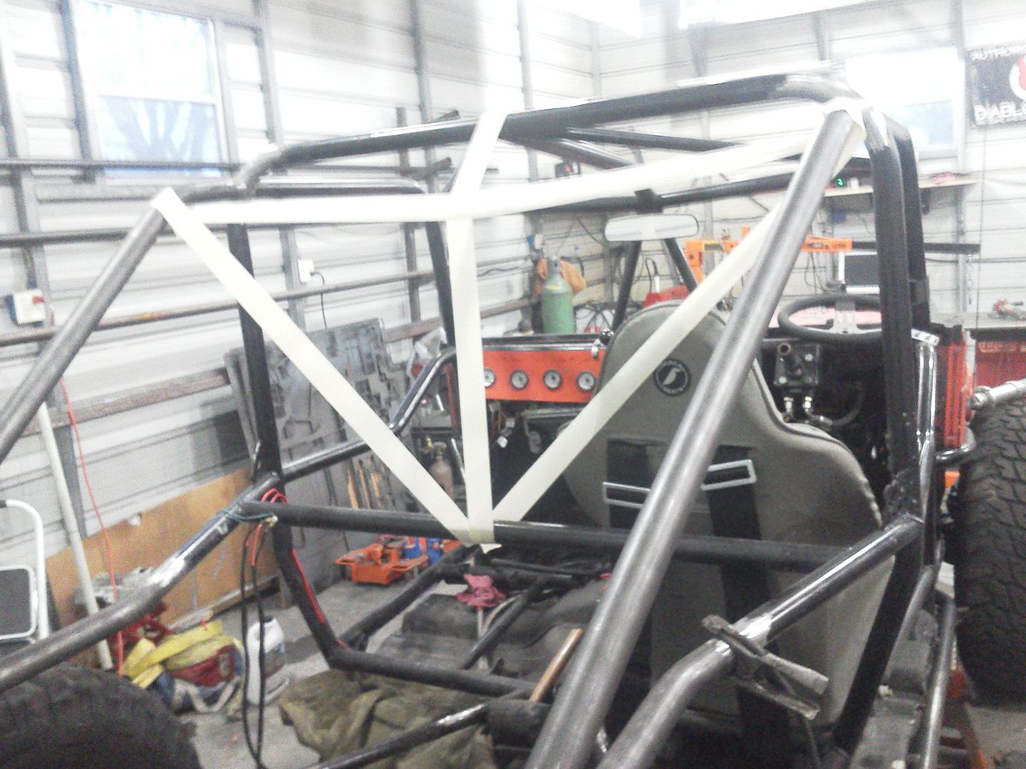

Some shots of the basic rear layout
Possible bracing idea

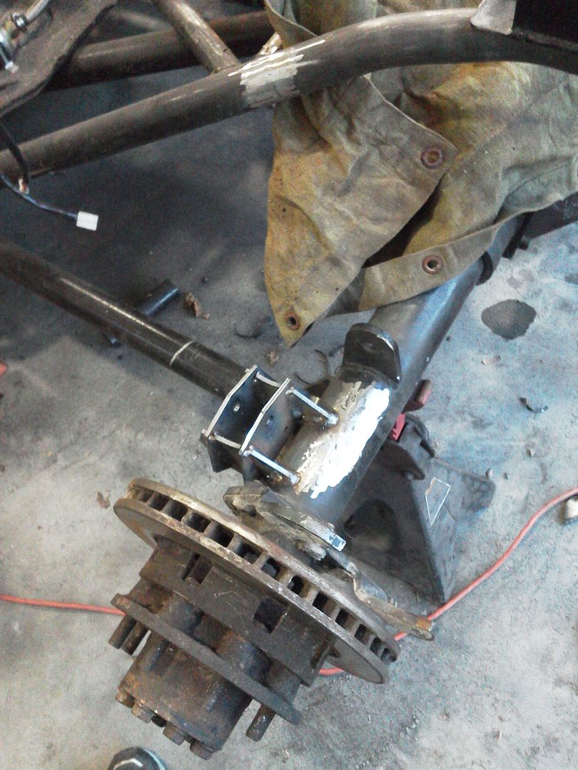

Back to work...
Rear CO mounts:
Uppers (will be boxed and most likely tied together with tube)
Fuel cell mount is in.
Need to get the rad in, rear winch, some more bracing and this rear is done. Going to modify the front coilover/trac bar mounts as well.
