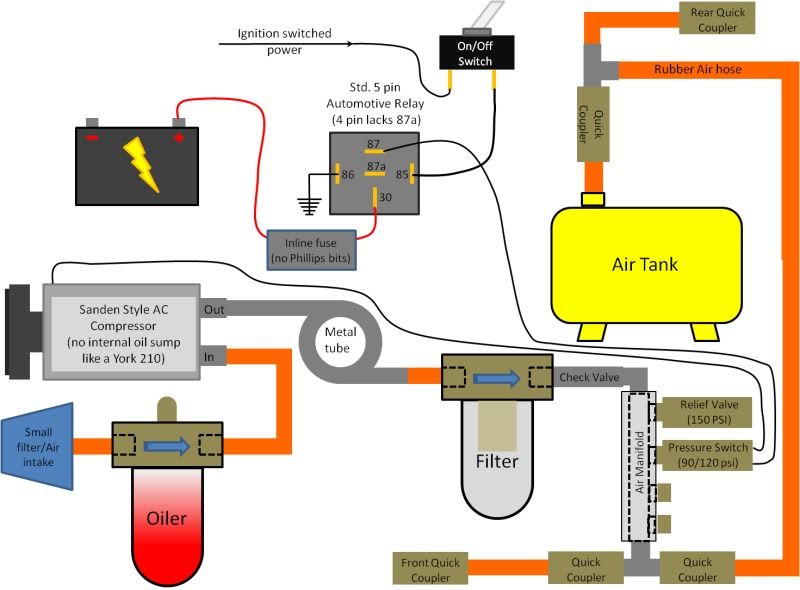

I just installed in inline oiler before it goes into the compressor, then an oiler seperator on the discharge of the compressor

i found this on an old thread. its a great diagram its shows how a machine oiler could be plumbed in for usage

i have made a simple oil reclaimer out of a quart size propane bottle which catches oil coming out of compressor and bleedes it back to the suction
