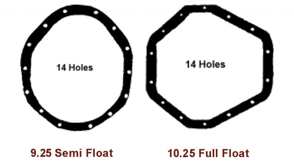

Also, since it seems to be ignored.
Both are 14 bolt chevy axles. On the left, would be found in a vehicle matched to a 44, On the left would be seen matched to a 60. Again, just because it's a 14 bolt doesn't mean is a full-float, 1-ton 14 bolt.

I think the OP will have a true FF 14 bolt as he says its paired off with a 44 front with a 203 case. That combo in its self was popular in the 70's era's trucks and I don't think the semi float made it on the sence till the early 80's.
