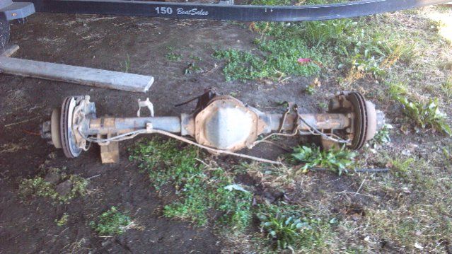

One way to unload a 14 bolt yourself..

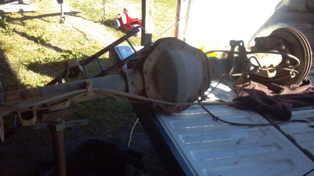

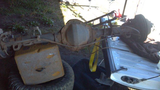

I picked up this axle on Friday, left it in the bed of my truck, then borrowed a hoist so that I could move it into my garage yesterday.
Plans are to gear it to 5.38, disc it, and possibly put an ARB in it and RuffStuff cover. I'm jumping up in tire size from 37" sticky's to 39 stickys".
Anybody want a bling aluminum cover? Oh yea, almost forgot....it came from a mid 90's Chevy 3500.

Good deal Joe, hard to tell from the Pic but does it have a 3 cross pin or 4? the 3 would mean a Gov-loc, 4 would be a open or detroit locker.
But its all a moot point as your going with a ARB, just pointing it out so others can see.
