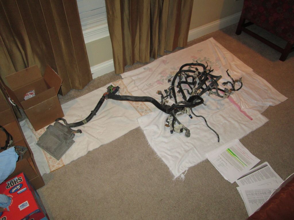

Working on my harness, should be done soon waiting on few peices.

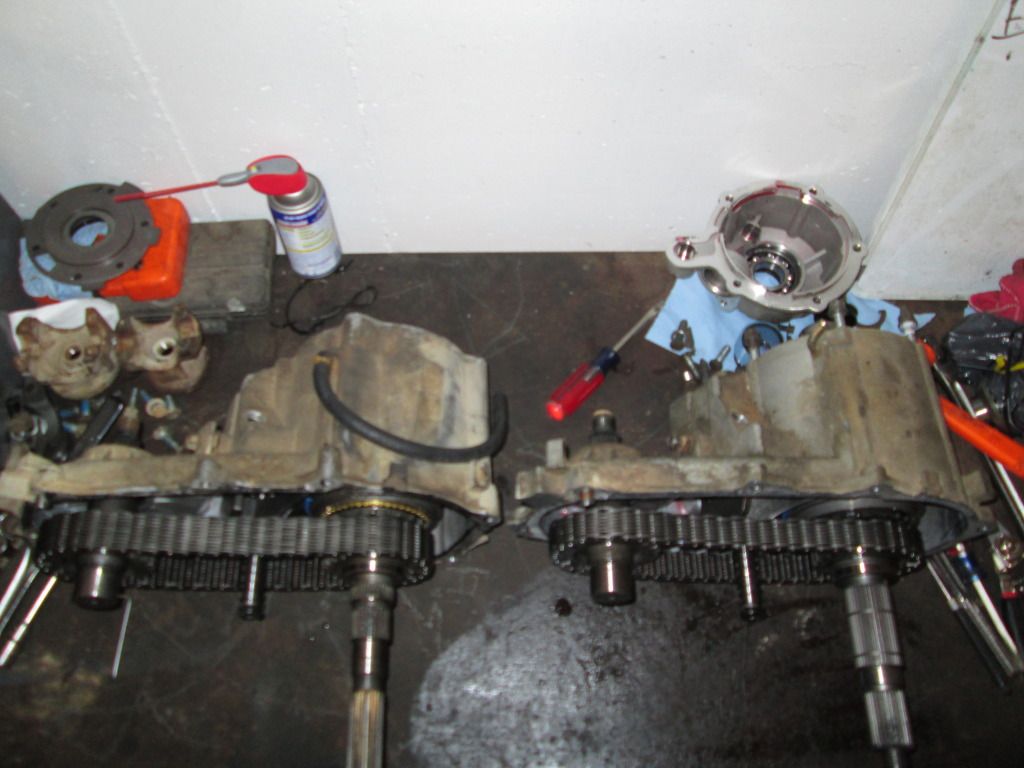

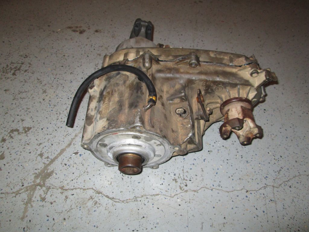

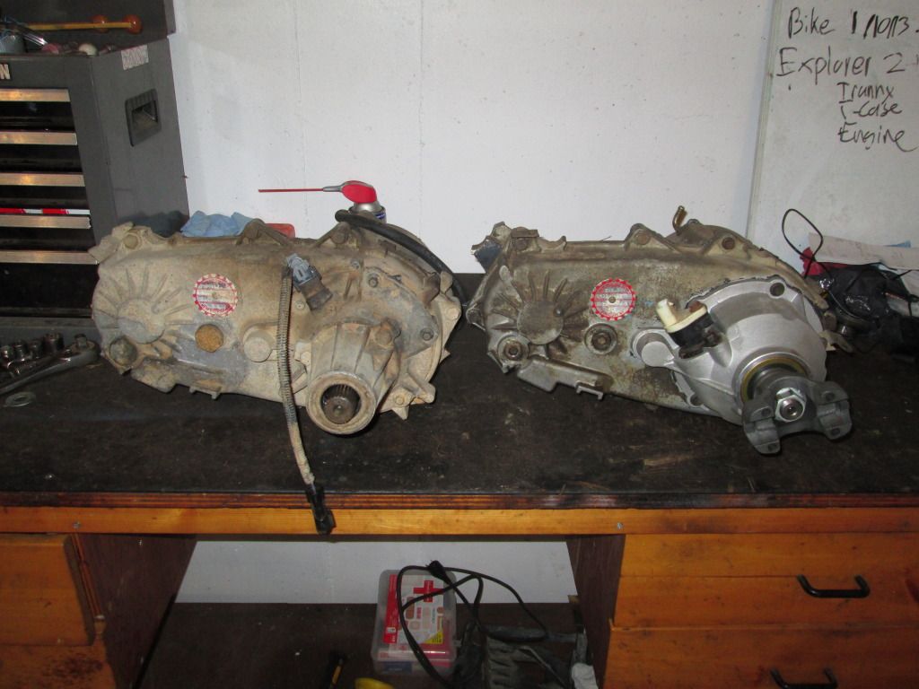

My 231 C Hd from 89 S10 I think.
My Jeep NP231 with SYE on right
Score on the wider chain in the 231C case
Jeep front yoke was little smaller -I did re-use it since it matches my front driveshaft
Also my 231C HD has 6 gear plantery so nice upgrade also
End result, I used my rear 231J half, sye I allready had, the rest is from the S10 231C case, was fairly easy. In theory I could run my facotry Jeep speedo from my tcase if needed I think. I plan to have my ECM tuned to 8000 square wave signal for the output to speedo it provides from signal I will send it from my aa vss signal.

The wiring harness so far has been extremely easy, but time consuming.
