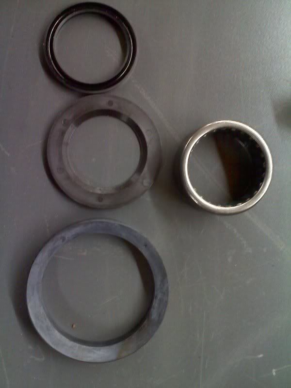

here they all are, just out of the packaging
Since I had just bough a 79 Ford Dana 60 HPhousing and Chevy outers it took me a while to figure out what would take up all the slop on the stub shafts.
That is definitely what you need, the whole shebang comes as a kit.
