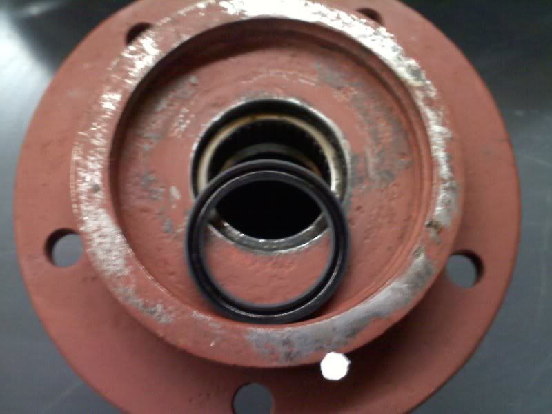

was there a seal over that spindle bearing? like this?

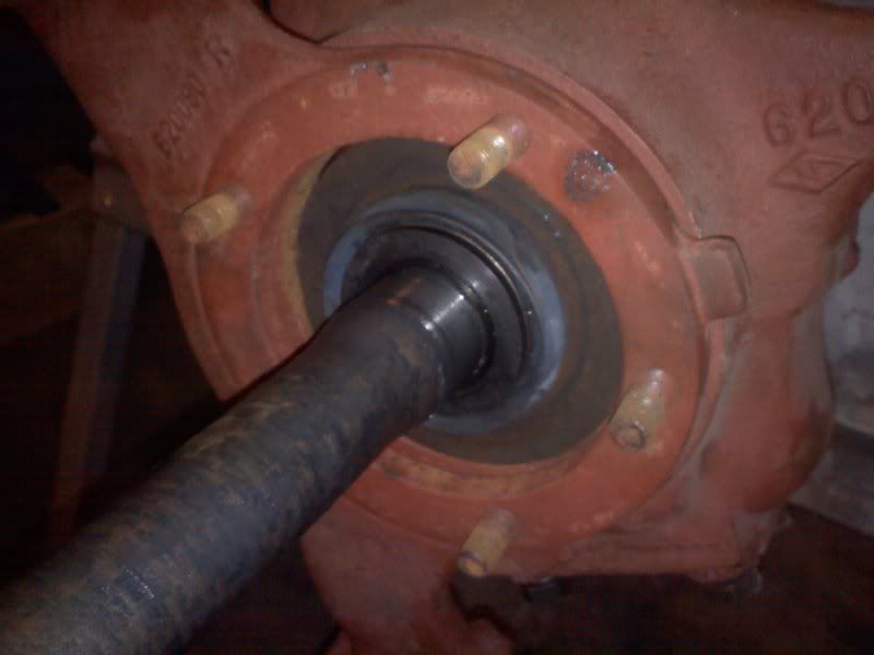

Yep, I just had to go out to check. It somehow was stuck on the axle shaft & didn't come out when I pulled the spindle.
You can see it here:

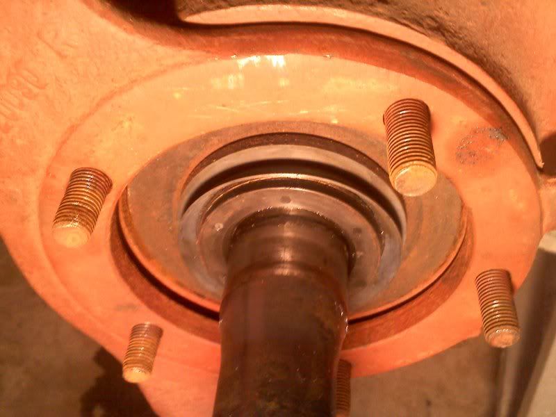

here is what mine looks like with out the spindle bearing seal over the axle shaft. there is an outer axle seal and a disk thing I dont know the name of.

Yep, mine has some misc parts that look like yours do between the spindle seal & axle shaft ear.
