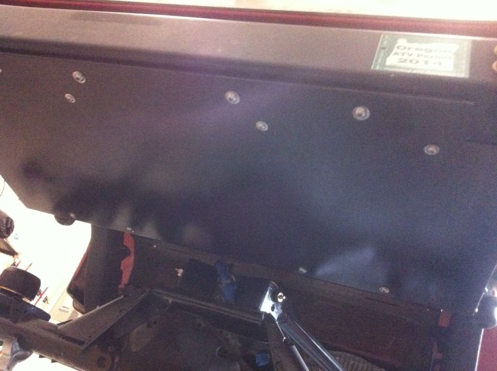

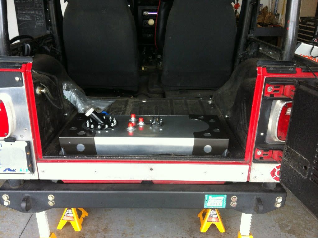

I'm droping a fuel cell in the floor of my TJ. I built a flat skid off the rear to a custom cross member for the cell to mount on. I'm using a Artec mount to hold it in place. I have it hard mounted to the skid right now, but I was thinking about using some bushings between the Artec mount and the skid. I know I have seen a picture or two of cells mounted that way, but not much info about how well it works. Thoughts?

The skid is nothing special, it's been done a few times before.
