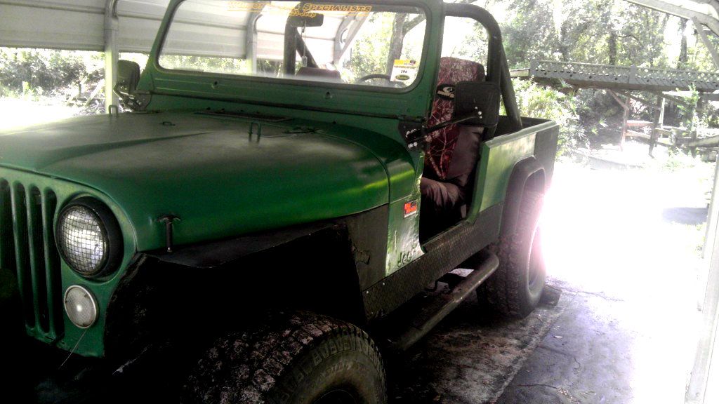

well like I said in my post the towing thing is not a major issue just would be nice and i was seeing if anyone thought it would be possible. My buddy who is a professional welder has done similar things already to cj's like v8 motor swaps and he has re welded spring perches that needed moving because a guys lift moves his axle back. so im not worried about the work I was just seeing if anyone had some input to make it easier and to see if anyone had some pointers before I started to save money since my tire and wheel setup is going to be around $5000. I am for sure going 1 ton everything, axles, tranny, driveshafts, and suspension so i'll just get a donor truck (probably an older f250, preferably dana 60s) and weld the f250 spring perches on, axles, etc. I decided to keep the current frame because it has already been plated on both sides on half of the frame so im just going to plate the rest of it and make it solid. Now im not sure if im going to run the axles normally and just get custom fenders made or shorten them. not sure if this would look goofy for an on-road jeep. i have made my mind up on the 4bt so ill have my buddy make the motor mounts. by the way one of my buddys with the 6bt sitting on 38s gets around 18-20 mpg average and can still tow. i do plan on getting bigger gears probably 5.13s if i get 40s. one thing i have not made my mind up on yet is what tranny and tcase to use, even though its for on-road use mainly i still want it to be heavy duty.
but besides all that, im going to wait and sell my truck around December when my college classes end. so for now i just ordered a spring over axle lift from rocky road outfitters. i also ordered the longer shackles for the front so it will be 7.5 inches of lift according to their website. with the body lift I will have 10.5 inches total of lift.

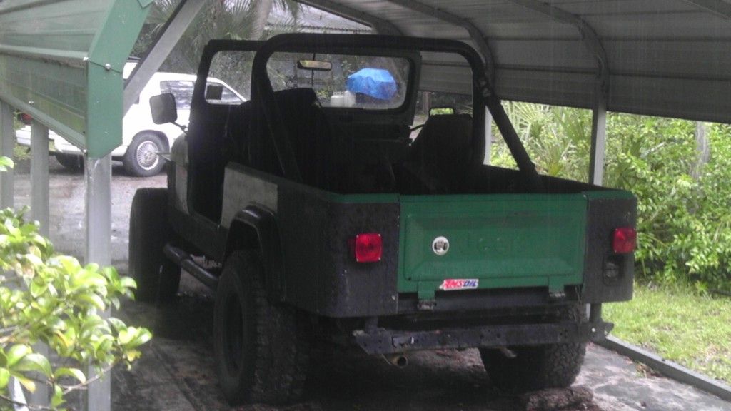

I know she looks ruff but i plan on putting a lot of tlc into her. most of the rust has already been cut out and replaced with fiberglass. Its a 1982 cj8 scrambler with a 3in. body lift on bald 33x12.50s, re manufactured 258 bored to around 263, dui distributor, 2bl webber carb, hedman headers. I also have a t18 with a dana 20tcase sitting in the back that i need help swapping in if anyone wants to check out that thread and give me some advice. also what tires would you guys recommend after the lift? 35x15x15 swampers or 37x12.50x15 iroks? i dont plan on wheeling her too hard.

AustinTexasXJ
1987 MJ Comanche
Location: Austin/San Marcos
Posts: 6,115
looks awesome, you have some cool plans, interested to see how it goes.
I would rather you not re install the body lift. that are dangerous especially @ 3"
I think you will have plenty of lift with a 4" SOA lift
