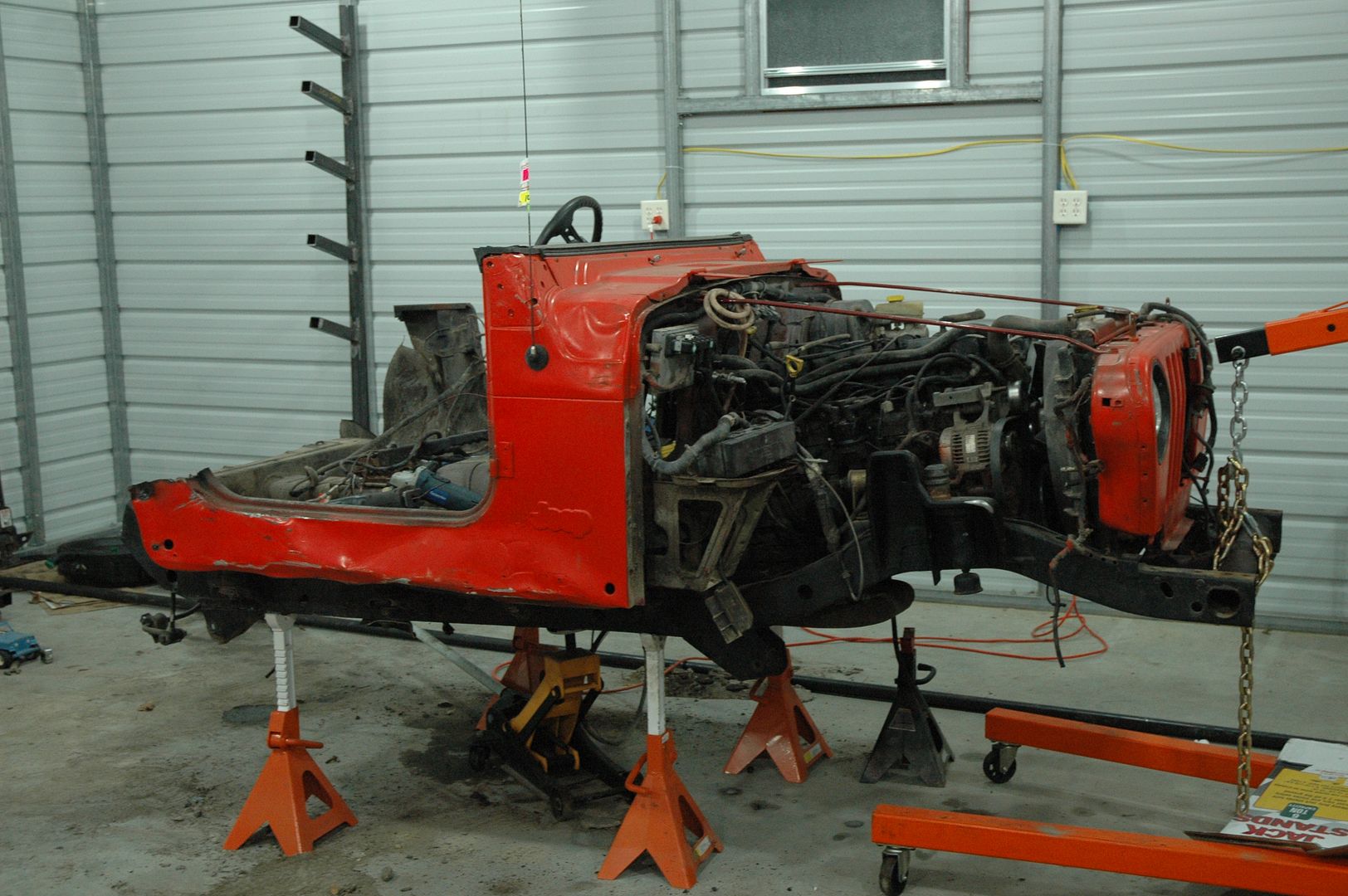

This worked out real well:
Build in the sig

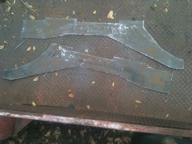

For unibody plating I used 3x3x3/16" angle for the "frame" rails and cut out 1/8" plate for the front (haven't burned them on yet)
For stretching the wheelbase and fitting bigger tires I used 52" chevy leaves in the rear and removed alot of that unnecessary sheetmetal (still need to finish them up).

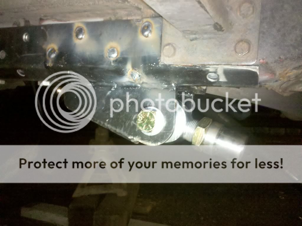

here is my unibody stiffner pics i did to my xj over winter
