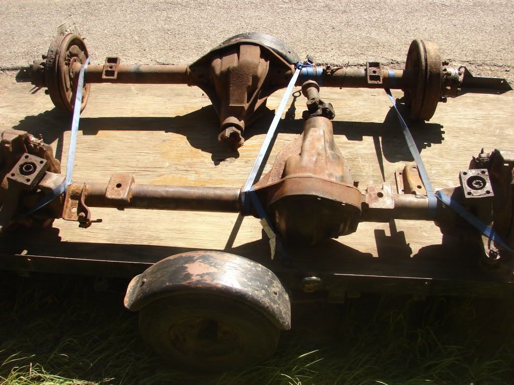

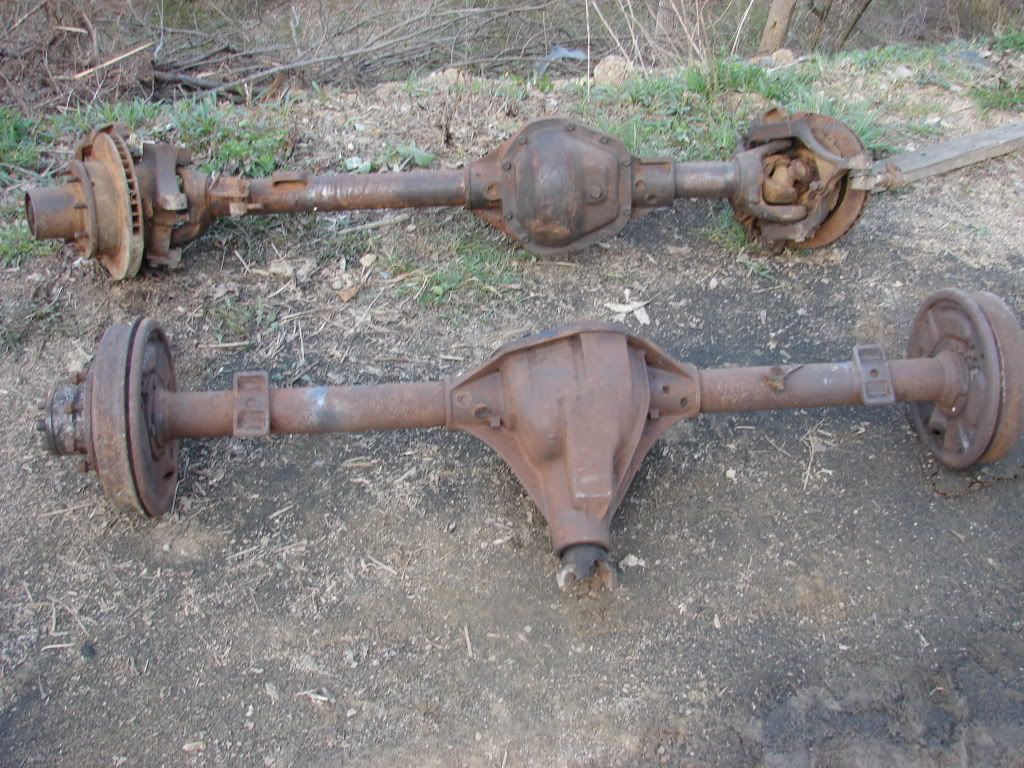

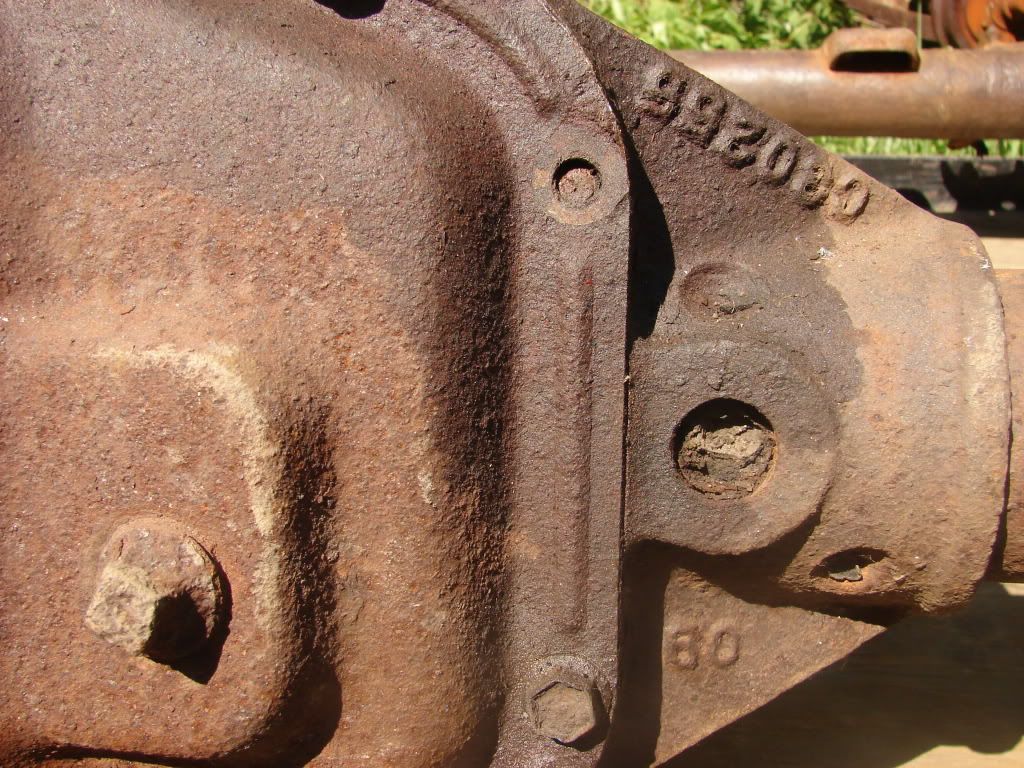

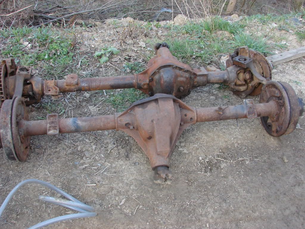

here's a few pics.
i am pretty sure the rear has 4.88's in it but that's just a turn the drum and count the pinion revs. it is closer to 5 turns than 4.5 but that's not an exact science. i am not sure it's from a cucv but i assumed that just due to the lack of a BOM on the diff.
the front i am fairly sure is a 4.10/4.11 from a 78 snow king or whatever the truck was called. the front has just drive flanges, no hubs. i want to weld/spool the front and run the lockouts for a poor mans locker. i am using H1 wheels, should be ordering them within the week, i already have my 37x12.5x16.5 HMMWV tires sitting in the shop. i definitely would be interested in a set of hubs for the front.

Yep that rear was not in a CUCV. Judgeing buy the type of drive hub flange on the rear 60 it looks to me like its from a Dodge. They had a step in the hub very close to what yours have and yes some Dodge had 4.88's so maybe you found a jem in the ruff.
Your missing the KP caps but thats not a bid deal as high steer arms will go in place of them. As long as the KP cone's are in good shape ( witch 90% of the one's I find are ) then just clean them and your good to go.
As far as the hubs I would just trade ya for the drive flange's. As long as I got all the parts and caps, i'm not joking I have a set but there missing the caps.
I would drop a set of good black label Warns in a flat rate box if you do the same.
