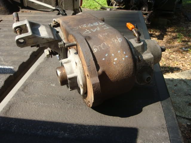

Today I picked up some 3x3x3/16" angle iron to make frame stiffeners. Tomorrow I'll be picking up a Dana 300.

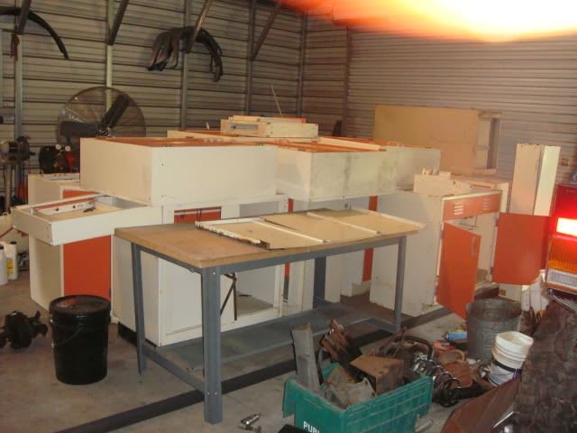

Had a busy day today, this morning I picked up a bunch of free cabinets and workbench for my garage
And then made the drive to pick up the Dana 300

What's your plan with the Dana 300?
I've got one going in, too. Wondering what you're doing: drop it low or hammer to floorboards or cut out floorboards, mechanical shifters, cable shifters, etc?

Cut and rebuild around it with an access hole to check/fill the fluid. Not sure on shifters yet, but this set up is kinda cool.

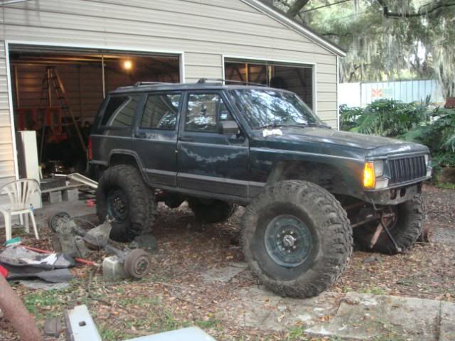

Pushed it outside today so I can start cleaning up the garage. Also fired it up for the first time in a while and let in run a bit.
