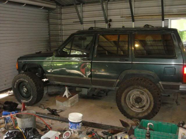

Trimmed the front fenders yesterday, still need to do the cut and fold on the pinch seam. May have to end up cutting more but will wait till I can get the tires on to check the clearance. Probably will end up cutting the front side horizontally just below the side marker lght. Also removed the front bumper, thinking about recessing a winch below the radiator to help the approach angle like this http://s143.photobucket.com/albums/r...cpZZ1QQtppZZ20
Ordered some leaf spring pearches from Ruff Stuff Specialties this morning. If they arrive by this weekend I may have the rearend sitting under the Jeep Sunday.
Before
Scratched a line following the mark left by the fender flare and then cut it off with a cutoff wheel and the cleaned it up with a flap disc.
After, when its all said and done going to cover the edge with door trim.
Bumper off
Getting there!

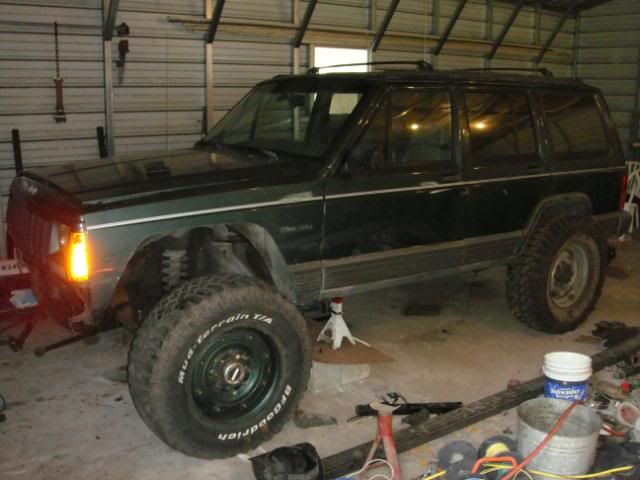

33's and no lift, better not hit any bumps
Just put a tack weld on the perches to keep them from moving until I figure out the exact pinion angle.

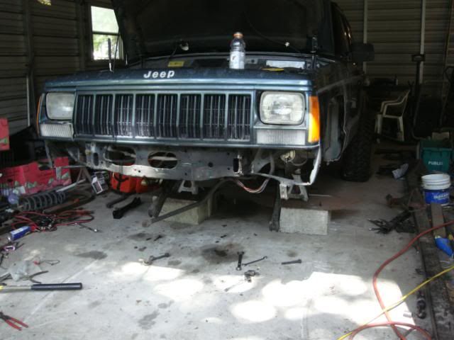

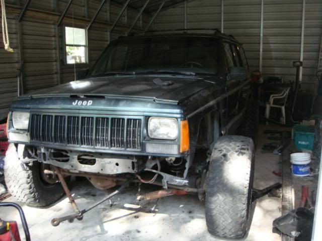

Today I got the brake lines hooked back up and bled. Had to switch the axle lines to the opposite sides due to the cherokee frame lines exit from a different location than the CJ did. Hopefully this evening I can get the Jeep turned around so I can start pulling the front axle.

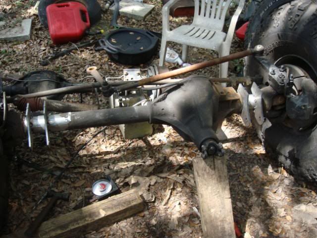

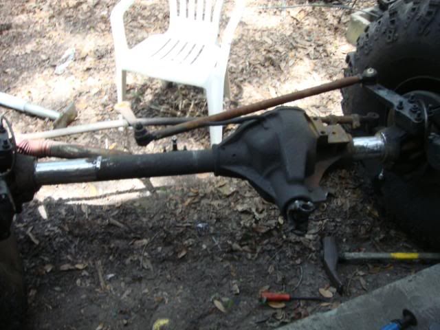

Guess now it can offically be a 1 ton XJ I had to change my orignal plan of attack as some of my orginal measurements were off. After some remeasuring and planing I got it figured out, I think lol. I'll get some better pics and show what I'm going to do later.
Now I need to decide if I want to fab up my own 3 link and save some cash or buy the Clayton or Poly Performance kit and save time
Orignal Chevy brackets cut off
No more Dana Turdy
Ballistic brackets tacked on
Sittin on factory springs and 33s all the way around. And yes I know that the driver side is sticking waaay out. It was hot, I was tired and after all my hard work of centering the axle I set it down on it's on weight, forgot I had no trac bar and the body shifted to the pass side

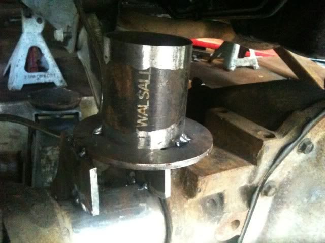

Haven't had to much time to work on the Jeep lately. Have next weekend off but were going camping, I may end up burning some vacation time to get some work done. Today I cut some pipe and made some spring retainers. My plan was to pull the 4.5" springs out of my LJ and put them in the XJ to get and idea on tire clearance so I can order some springs, but I got busy and only had time to make these. Once I get eveything fitted I'll cap them off.

Id make a bigger plate to weld to the tabs on the axle. Gusset it under the side that sits over the housing also. I wouldnt be to comfortable with that as a final design. Unless thats just a temp thing to use just to figure out ride height? Either way i cant wait to see this beast done!
JeepFreak1982 is offline
I am going to gusset it better once I make sure eveything is going to fit right. I knew the top plates were going to be offset a little , but somehow my measurements got screwed up and thats how the top plates ended up. Hopefully it will all work out in the end.

post #30 of 107 Old 08-08-2011, 03:59 PM
JeepFreak1982
Location: Middle Island
Posts: 808
Maybe use a square plate? Id want as much welded to the axle brackets as possible.
