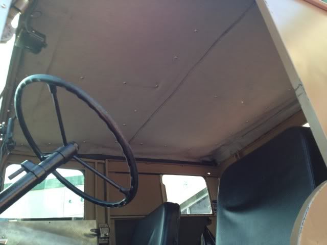

post #8 of 13 Old 12-27-2011, 03:32 PM Thread Starter
brian0128
Location: Maryland
Posts: 160
Originally Posted by inkryptic View Post
What's the company?
Fantatic work.
brian0128 is offline
