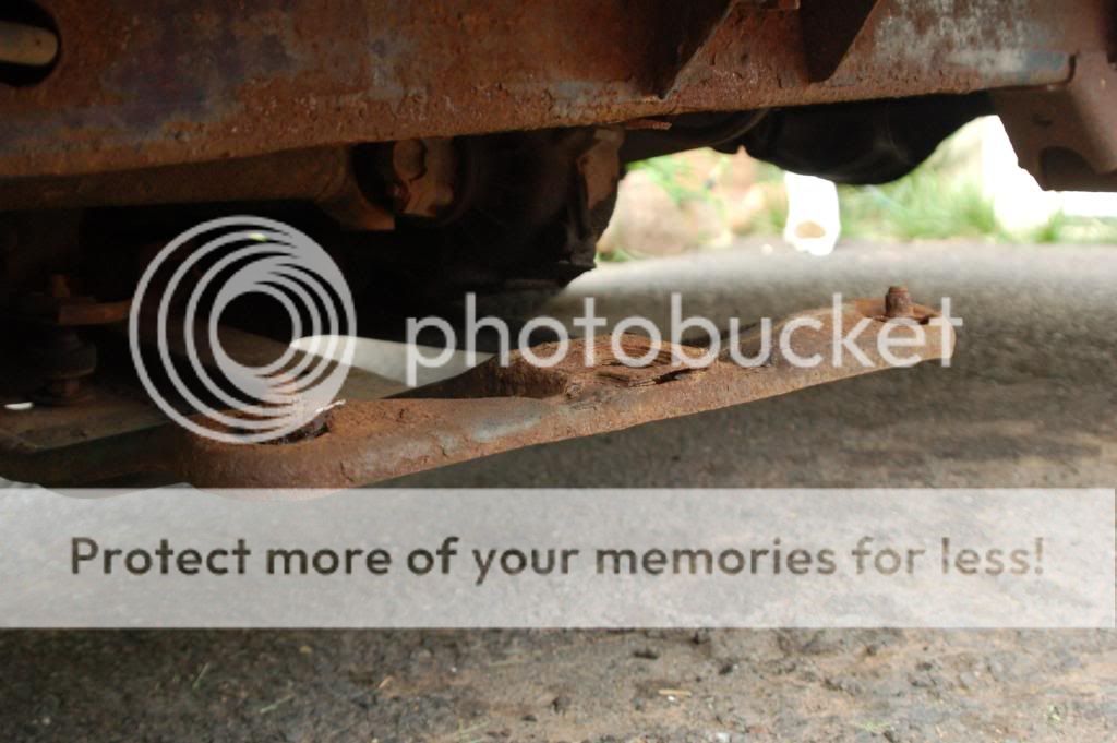

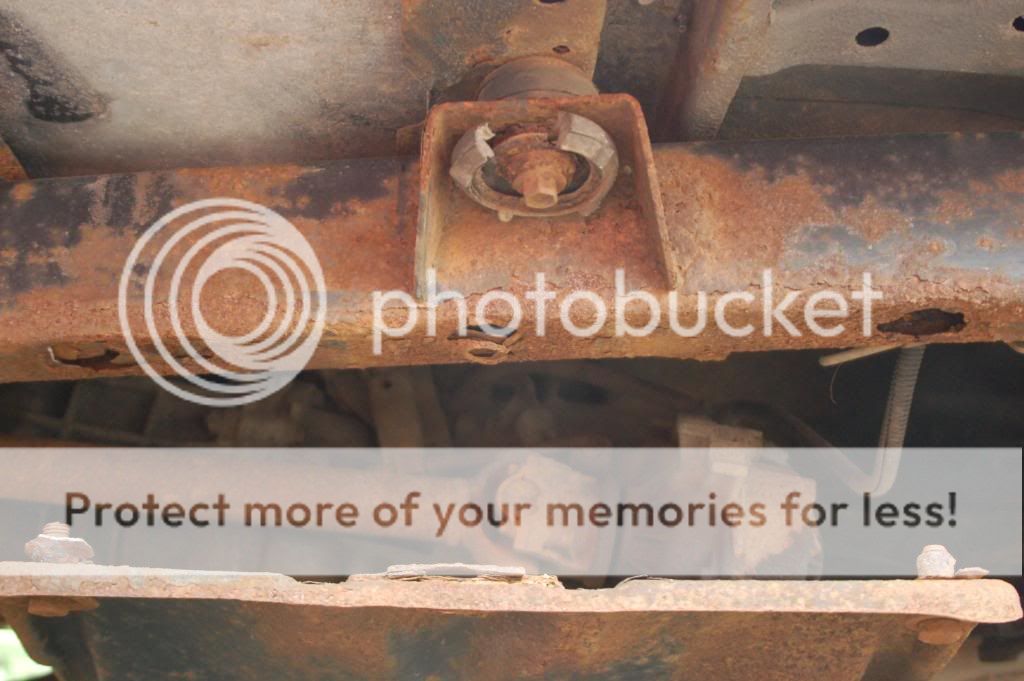

ok, so here are some pictures

OK, now you need to get a screw driver or small hammer and start going around every inch of your frame, jabbing at it. Not just taps either, give it a good jolt to check for rot.
Don't bother getting it repaired if you need to replace the entire frame, know what I mean???

yeah i know, i was actually going to do a complete replacement about a year and a half ago, but after looking of the rot it looked like it was just the front where the powersteering box is. i should have just gone for it... but hind-sight is always 20/20
