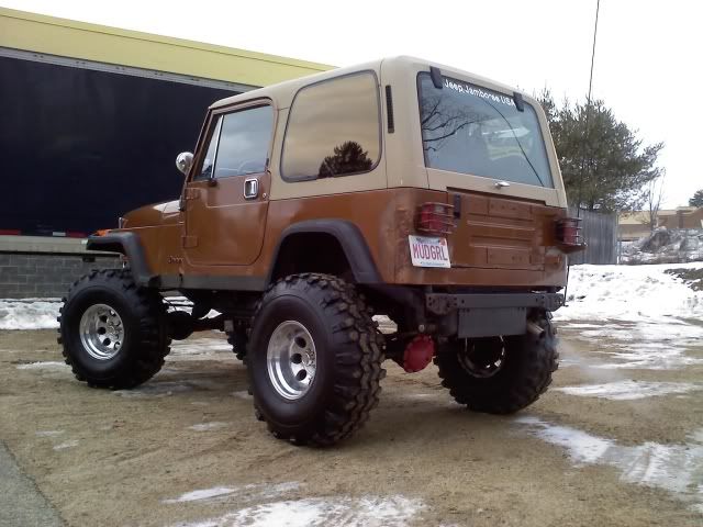

MY stock yj D35 with 4:10's and 36's
Mason, you have nothing to worry about, you're doing the exact same axle swap that I did. From the time I got my Jeep 3 years ago until I lifted it and did the axle swap last March, I wheeled the SNOT out of it for 2 years with 32" muds on a stock D35. Since my Jeeps been lifted Ive wheeled quite a bit, doing a fair amount of rock crawling, and also drove it ALOT with 36's for almost a full year now. I never had a SINGLE problem with either axle. In fact the ONLY reason Im even considering and working on my 8.8 swap is because of what Ive "heard" about the D35. However, you can bet that thing aint goin in until the D35 blows up, if it ever does
