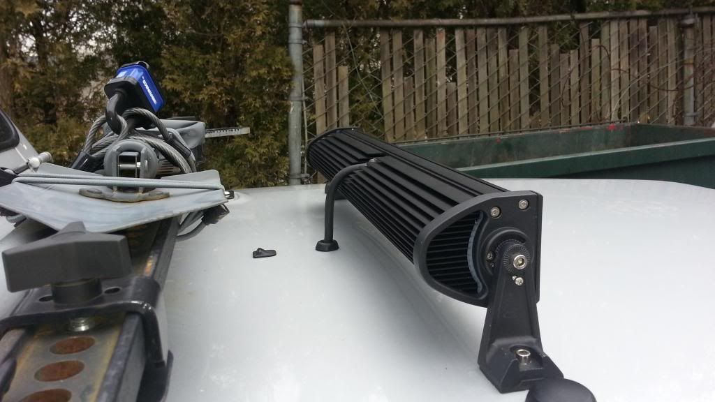

Originally Posted by SurferJ View Post
Looks great. Where did u run the wires for the bar? I can't wait to get mine installed
through the hood. I used a gromet to seal it up.

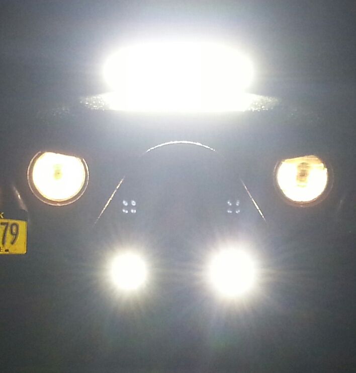

post #34 of 46 Old 01-29-2013, 05:04 PM Thread Starter
SurferJ
Location: Long Island
Posts: 663
that looks great! im waiting for my green LED rocker switches to show up.. hope to get mine installed the end of this week or early next week. post some night pics of them lit up. btw I love your TJ

post #37 of 46 Old 01-30-2013, 11:00 AM Thread Starter
SurferJ
Posts: 663
Daaaaaaaamn that's some motivation for me. Nicely done!

Originally Posted by 04tjoe
thanks. cant wait to see ure rig lookin mean and green.
Lol. Hey question about drilling trough the hood. I got a variety pack of grommets. What about the plug? Did u cut it off and resplice it on? It won't fit trough the right grommet.

post #40 of 46 Old 01-31-2013, 02:37 PM
04tjoe
Location: Greenville
Posts: 96
yes you could do that it would make it easier and you wouldnt have to drill as big a hole to get the connector through the hood just cut the wire fi.sh it through the gromet and the hood then reconnect the other end and use those water proof straight wire connectors that you crimp on to reattach the wire and finish by wrapping with electrical tape for a durable contact.

i think thats what im gonna do
