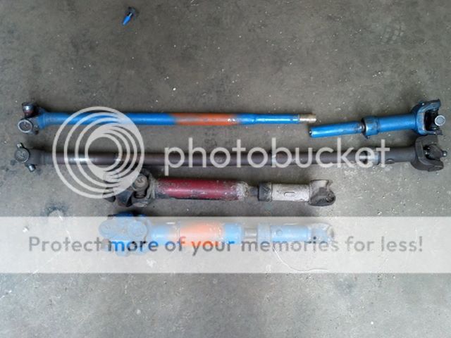

This is what i took home from the Catskills Jeep Jamboree. Someone needs an anti-wrap bar. 2nd day on the trail on a very long and steep dirt hill the 8.8 bucked and twisted up vilently shakeing the transfer case causing the t case shift lever bracket to come loose . rear driveshaft yoke snaped putting all of the strain on the front driveshaft causing it to twist and snap. That was in the first hour of the ride

I have to install an anti-wrap bar before i go out again. Guess Ive been lucky and not breaking rear driveshafts all this time. Catskills is hard core, The list of carnage from there of all the jeeps is endless, So many tires, shafts you name it. If it could be broken it was not to mention the roll overs
Im looking for grand cherokee front driveshafts if anyone has them. Actually i just need the short slip section.
