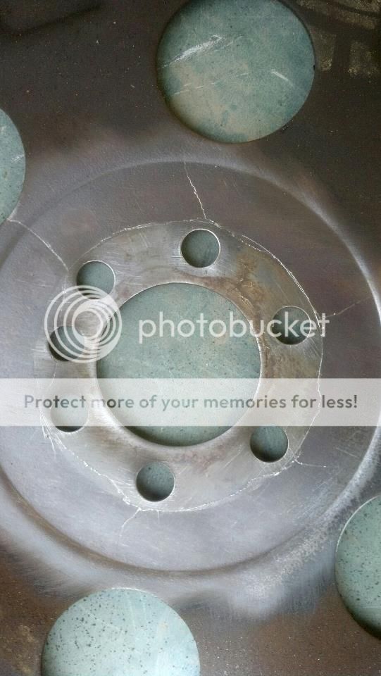

Checked fluid yesterday and it didnt show on the dip stick. added fluid and the noise went away but them came back a few times. Happens mostly in Low 1 and reverse.
Burned out torgue converter? Trans ran hot in the way up to "Daves place "
Im pulling the inspection plate today

Looks like a cracked flex plate. Still makes noise with the cover off. It has to be cracked to flex this much.
Good thing I have a spare and a spare torque converter if needed
This is where they crack and why I dont see it.
I should be good by Monday night
Mind you,,, Im no Mechanic!

Heres the separation
and heres what i was hoping to find and it not be something else
big cracks
I have a spare, Dosent everyone?
Rebuilding tomorrow
