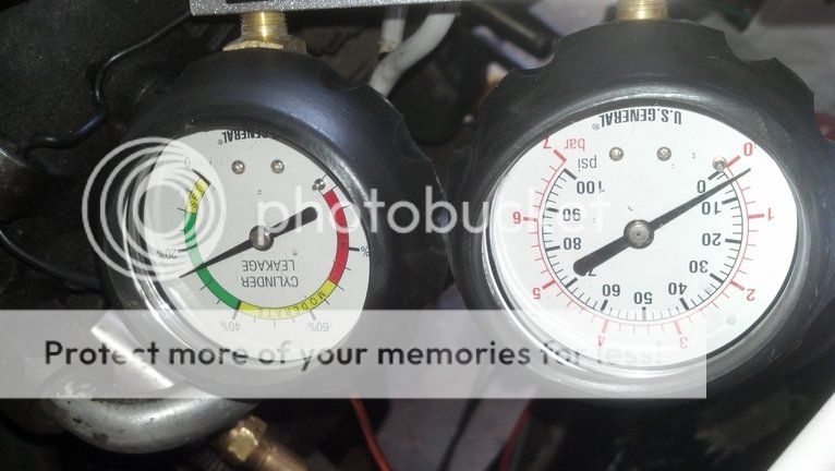

Did the leak test.
This image has been resized. Click this bar to view the full image.
This is the worst one and its on the side thats leaking oil. all others were at 20 or below. I did the test with the motor cold. I read that its ok and a warmer engine gives better readings ( lower percentage).
I did the test by finding TDC with the mark on the fly wheel. The other 5 others I put air into the tester and moved the flywheel and watched the guage drop and felt the resistance of the compression to find TDC. I felt this was an acceptable method.
The plugs are back in and Im going to try it again tomorrow when the engines warm
