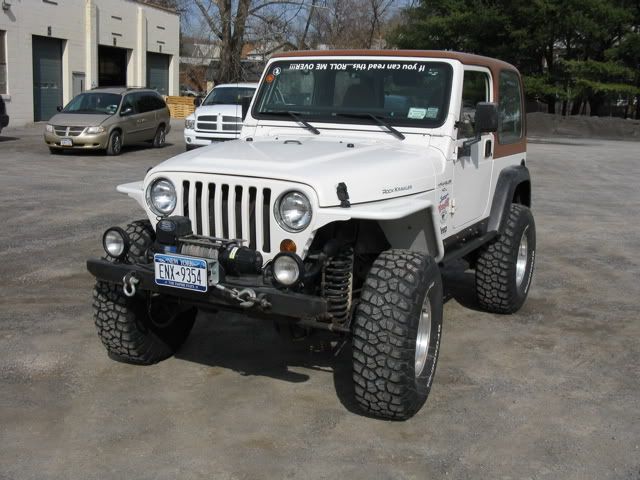

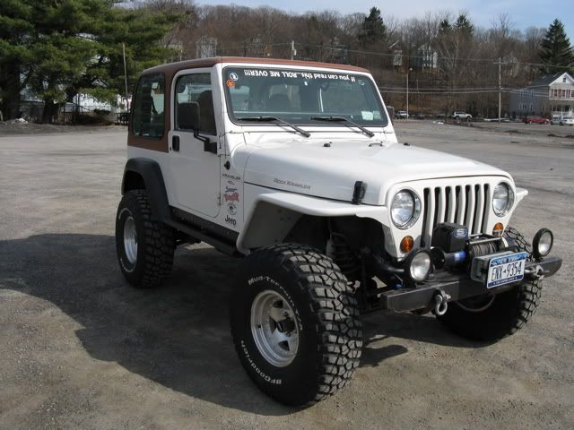

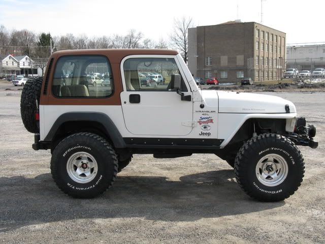

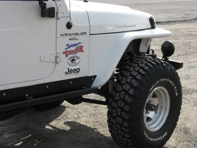

Nobody's been on here for awhile so I'll guess I'll post up pictures of my new Flat Fenders:

Very nice Andy, who's fenders are those? And please don't say yours.

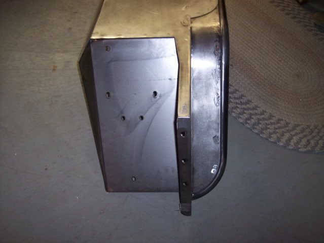

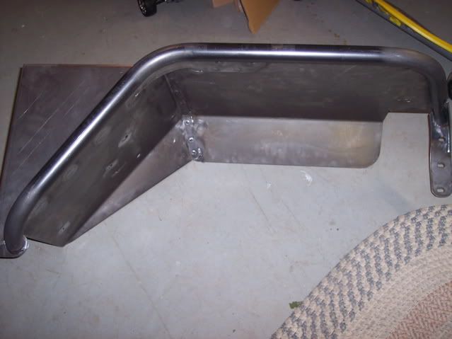

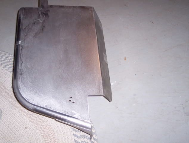

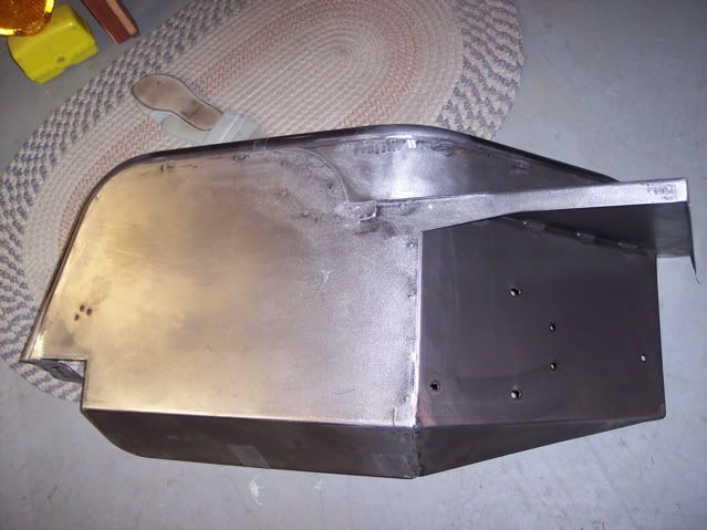

No. They're not mine they're from TNT Customs and the started out looking like this:
I did a lot of work to get rid of the seams and weld/grind marks.
I used Lab Metal to do rough fill of the seams and then finished up with primer filler and Nitro-Stan. Painted it with Primer Sealer and then Acrylic Enamel.

I thought those were T&T's, they are the only tube fenders I would use, not cheap but I like the intergrated inner fender. Did you use the stock airbox, or did you go aftermarket like they suggest?

I got rid of the stock airbox years ago when I put in my York OBA.
I did have to make a cut out on the new fenders to accommodate the York. I'll have it at the meeting on Monday so you can inspect it all.

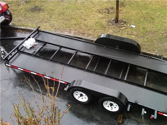

I almost forgot that big thing hogging my driveway, finally bought my own trailer. It's a 2008 16' Econo trailer, 7000lb cap. came with the 3500lb Superwinch, picked it up for $1500.00.
