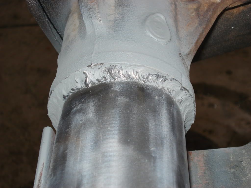

Stan, are you sure you really need to weld the tubes to the center housing? I've never had an issue with 8.8s in my past, but those weren't Explorer housings so maybe they're different? I've got a friend with an Explorer 8.8 and 38" Swampers and his axle has been fine....and he's known to get a little silly.
Generally speaking, welding steel to cast requires preheating the cast iron quite a bit. My concern would be possibly warping the housing by doing so. There is also a specific welding rod/wire that is supposedly capable of welding steel to cast without preheating. If you can find that stuff in a wire format (MIG), we could do the welding here.

Last weekend, I picked up a Ford 8.8 at a local wrecking yard. It should be a bulletproof upgrade for my rig, and guarantee that I won't have rear axle issues on the trail (my main goal!). First thing on my list is to get the tubes welded to the pumpkin. It sounds somewhat difficult because of the cast pumpkin, so I'm looking for a local shop or person with good experience. Any recommendations?

Not sure what "special wire" you may need... I used my arc welder and just ran a bead around the tube. Haven't had an issue with it. Maybe I did something wrong as a beginner welder. (Not being sarcastic.... I really don't weld much!) I think it was a 7170 stick. I'll have to double check numbers. Either way, it worked for my application. I have the sticks/welder at home if needed. Probably wont be too pretty, but effective!!

I'm almost positive that I want to weld the tubes. The entire point of the upgrade is to make sure that I don't have any rear axle issues. I'd hate to leave a potential weak point and have an issue on the trail.
There are some pretty good threads on welding the tubes:
http://www.pirate4x4.com/forum/jeep-...uilt-8-8s.html
"Welding the tubes keeps them from spinning. It's done as a precaution to make sure this doesn't ever happen. When welding the tubes, make sure you do them about 1 inch at a time. I welded on one side, then made another weld 180* on the other side of the tube and kept doing this until the whole tube was welded, this helps keep from pulling the tubes up or down due to the "warp" that welding can cause. A lot of guys pre and post heat when they weld the tubes. It was about 100 degrees the day I did it and all I did was weld it up and let it cool naturally (no water, compressed air, etc.) and everything went well. I also welded up another 8.8 for a guy with a MIG using the same process and it turned out good as well."
"I welded the tubes to the housing with a 220V stick welder and 6011 rods."
"Pre heat it first and use a 903 I think or 908 rod and you want to heat the weld again. And have some clean sand to cover it to let it cool down very slowly. Ask what rod at a welding supply store. you ant to do it right getting cast that hot can make it very brittle and shatter. one inch at a time 180 out but you can do both tubes flip and do both again heat and dump sand or a thick welding blanket to let it cool down slowly."

My takeaway is that it isn't that difficult, and there are many ways to get the job done, and it doesn't need to be perfect or the prettiest welds to be effective. I need to get the axle all cleaned up first, which may take a while. Thanks, Stan

And it was a 7018 welding rod I used for the tubes and all mounts.

Are those welding rods you have nickel rods or are they something else.
