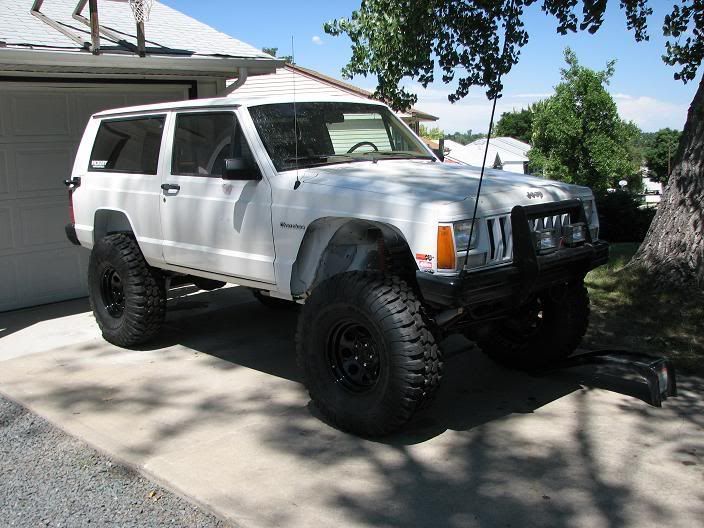

so i got it done to where i can move it outta my drive way or so i thought
well i got the lift on (had it on)
tires on
and put my LA's on
i drove it done the street and back up i threw the jeep in reverse and the brake pedal went to the floor ( i need extended lines)
here she is please give me your truthful opinions
much appreciated,
wojtek

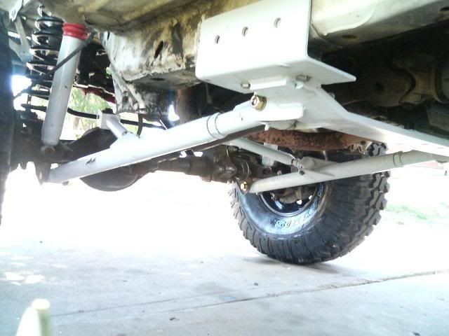

here are the LA's

Truthful opinion, eh? Well, I think it looks absolutely horrid. It's too white, the tires are too big (and they match mine...), the suspension isn't scratched up, it's too clean, and most of all, it looks just too awesome.
That's a mean looking XJ right there. Looks friggin' great! How long did everything take to get hooked up and put on? Now, however, we really do need to work on the whole cleanliness aspect. Not to mention putting a cap or something on your fenders. That looks like it hurt...

what they hell is going on here? is that even attached?

I see spacers back there...why isn't the bracket flush with the "frame" rail?

I think you need a few more bolts attaching the LA bracket. And I second Arlo's question.

im waiting for money for a sye and i will take the spacers out and and put it flush to frame rail then bolt it in through the frame rail with 3 nuts and bolts on each side!

ive had my jeep for 8 months! im 16 and starting school and stuff so its hard saving money but everything you see here did come out of my pocket! ive been probably wokring on it hard for last 3 months though and took a lot of money (which i dont have anymore)! i think i might get some speacial tape stuff or something so it doesnt happen to me again!

For that sharp edge go to a good auto supply or accessories store and pickup a role of door edge guard. This will work well to put over the sharp edges. You can get black, clear, chrome.

so is it sitting now till them or do you expect 4 bolts to take the strain of the front suspension stress.not wise if thats the case.

I would not drive it the way it is now.

don't forget to use cruch sleeves when you do add those 3 other bolts
also looking at the picture again are the front mounts still in the way? also why do they not look right ? like they have been cut off and moved down a few inches................

its not going to be driven this way dont worry scares the crap outta me just sitting here like this!
can i get a sleve like thtt at ace or homedepot?
and about the bracket there i havent got to cutting it off yet since im not driving the jeep yet im not in a hurry to cut it but it will be cut off, also i dont klnow if it was moved come to think of it it kinda does look like that!

I made crush sleeves for my bracket out of 1" DOM.
