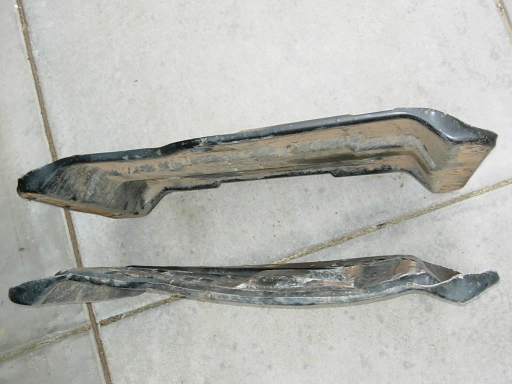

I finally got around to swapping out the t-case skid. All I can say is wow, that was bent. It ended up pushing the t-case up, and causing more of the slip yoke to show, and also made more angle on the driveline, giving some nice vibes. Anyway, all fixed now, but here's a couple pics of how it looked. Kinda hard to see from the pics, but still... But on the plus side- no more vibes, so I'm good to run again!

^ Spring Creek baby!
