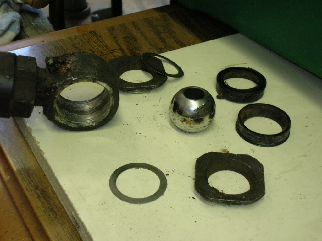

I have heims on teh upper arms, but not the lowers. They are rebuildable, but they use misalignment spacers. I think the newer kits have the spacers actually built into the ball itself. Here is a pic from when I rebuilt mine a while back, the spacers are not in this pic though. You can see that they are needed to space between the joint on each side and the CA mount. It is a pain to get the bolt through the mounting hole, spacer, the joint, another spacer, and the other side of the mount...

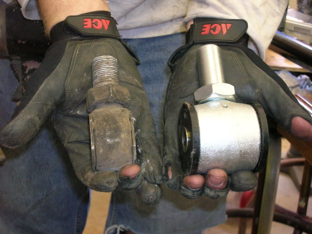

Here are the poly mounts I have on the frame side. Before I had RK joints everywhere on the LCA's. Yeah I know, I need new gloves...

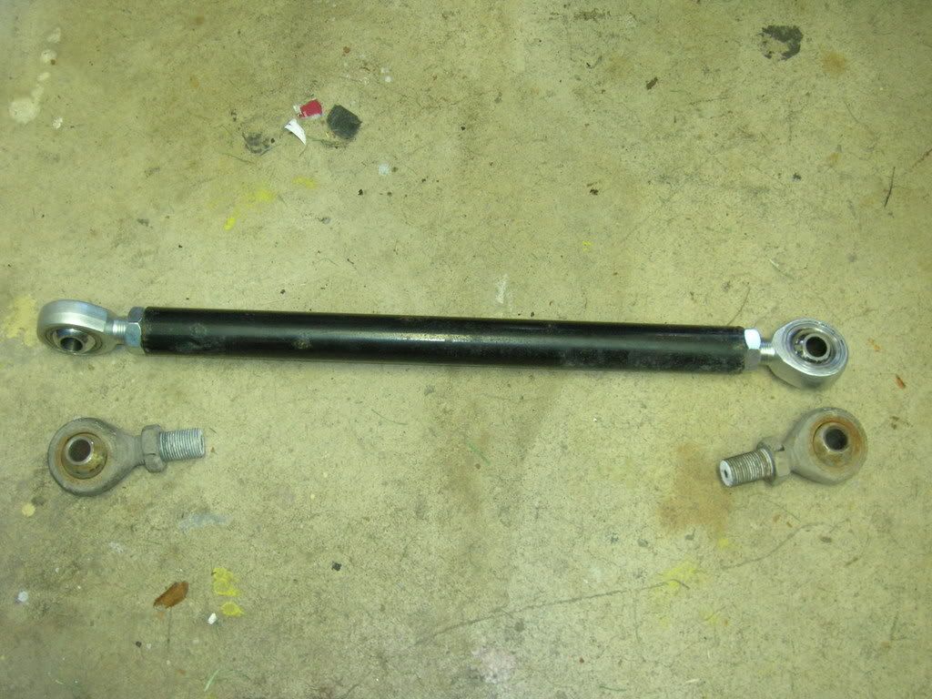

And here is an upper arm:

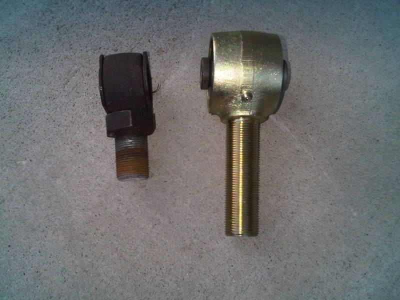

The Johnny Joints had a ton more thread. I had to adjust the other poly end in a bit to keep the arms the length I wanted. I could have cut some length off, but didn't want to deal with that and re-shaping the ends of the threads.

Yeah u do have an early one ha ha I need to upgrade to pure beef of jonny's.. Mine are All those rebuildable ones. The newer style tho. And bushings on the frame end of the lowers..
