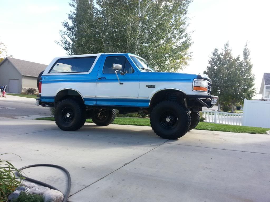

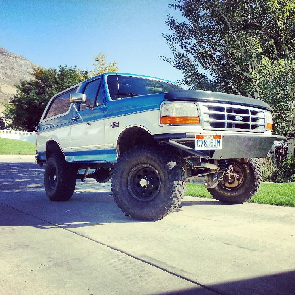

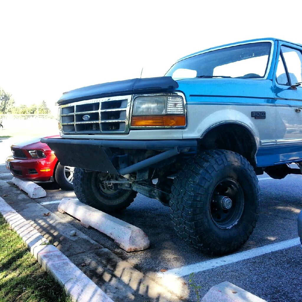

Here's my Bronco bumper just for fun, no pictures of the build unfortunately. Originally tried to bend one up with a harbor freight pipe bender, that wasn't working so hot, so it's actually all just cut and welded, with a bolt on skid, I used a piece of c channel mounted between the frame to hold a winch, but sold the winch soon after buying it, and then the bronco after that. It was welded to the frame at the bottom, and the skid was 3/8 steel, and it was mounted through the frame and in the stock locations as well. Really cheap and dirty build, ran me like $70, but it served it's purpose, and didn't look half bad and gave me a much better approach angle
here it is primed up after it got put together, minus the bolt through the frame and end caps welded on
here it is from the side, with my license plate tabs, and fully bedlined and mounted
another angle of it.
