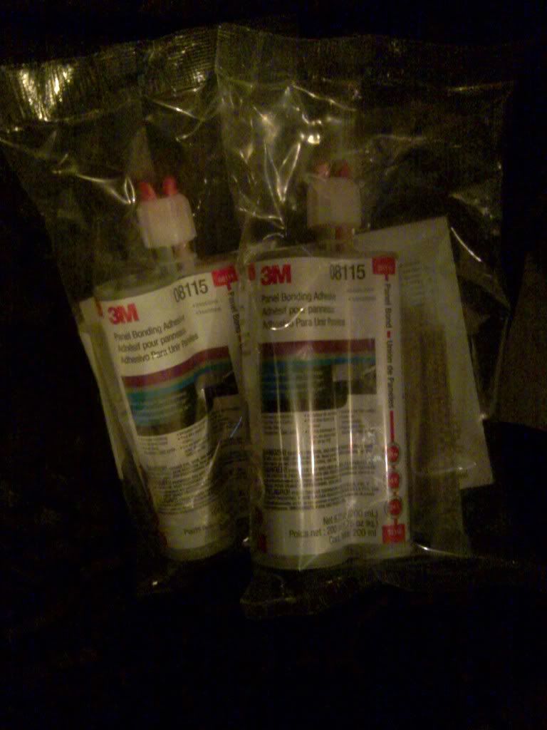

Will - do you know anywhere they stock the 3M8115 in the Ogden/Layton area? If not, I'll have to order it for Friday delivery.

SEM, 3M, and others all make it.
I would check Napa, and autobody supply stores. I usually get it from superior auto in salt lake. I believe that KC Auto Paint also stocks it.
Google listed a these in Ogden: Auto Body Supply, Ogden Auto Paint and glass, and some others. I haven't ever used them, but they likely carry the same products.

Chris, were you able to find body panel adhesive anywhere?

He did! He text me earlier and said Napa should have it shipped to him this afternoon

This stuff is made of gold.
