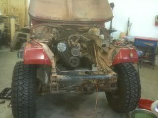

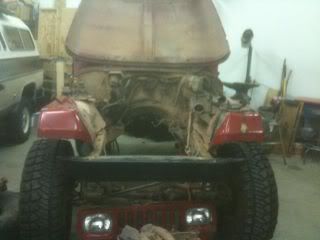

post #60 of 120 Old 11-17-2011, 06:53 PM Thread Starter
youngjeepr
Location: layton UT
Posts: 2,533
well I have the rest of the week off so i pulled the engine today it took 7 hours by my self
tomorrow ill drag it out to the street and power wash the engine bay then give it a rattle can paint job... hopefully its warm enough
