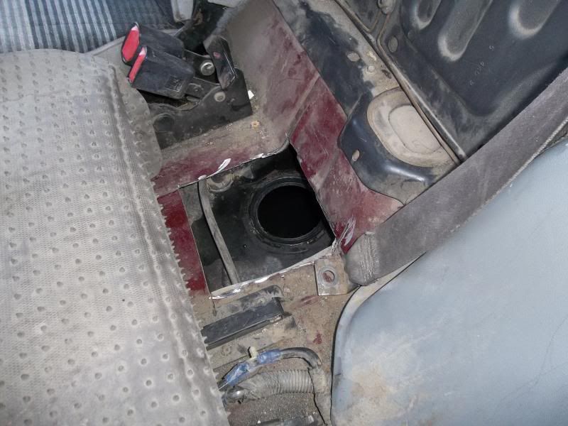

Oh, and greg was closest... Drivers side rear seat pooper access!!!
Or it's what you do when you need to access the top of the fuel tank but are too lazy to drop the fuel tank, especially when it's completely 100% topped off with gas! That's how you do it! LOL No hmmmm'in or ha'in, just getting work done! Don't need no 2nd opinions on what I should do or what I should cut or how I should cut it... LOL Suck it power!
OH!!!!!!!!!!!! AND I DROVE IT TO WORK TODAY FOR THE FIRST TIME!!!!!!! We'll see if it makes it thru the day. Assuming I'm not still hunting down a gremlin on it tonight I plan to get the front end alignment dialed in a bit better, possibly get the sub/amp combo installed which I'll pull power directly off the battery, but first I gotta get that pooper hole filled up. Just going to make a plate that will screw down over the top of it and seal it around the edges with some silicone. Should make it semi easy for any future access needs too, especially since I feel like I really may own this one for quite a while finally! Like I've said, I only regret selling 2 previous vehicles and my old expo is one of those two...

you my friend are very brave. Not because you cut, but because did you know the gap between the tank and the floorboard. Did you even nick that hose?

I'd stuck my hand up in there and got myself an idea of how much clearance I had to work with, also pulled the wire harness out of the way before cutting as well... Not my first rodeo...
