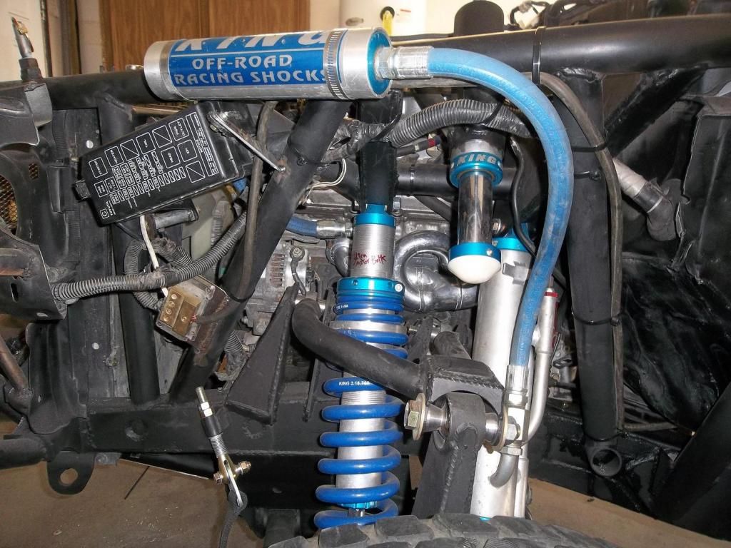

Andy, There's no tubes running to the outboard most tubes and only a single vertical tube down the frame rail even close to the shock mounts. So really he only had one tube supporting the whole front end on that thing plus the welds to the a-pillar and lower windshield tube which I'd be willing to bet weren't full 360 welded cause access to that spot is virtually impossible without serious cutting. His setup is fairly similar to what I did on Jasons and my truck too actually but he doesn't have near the support tubes that I have. I'm still tempted to put one more in on each side on Jason's to be honest just for piece of mind.
See, same "v" type setup with the shock mounts between the tubes.
But I've got tubes running down to the frame rails supporting both sides of the shock mounts with some angle to give chassis structure as well.
At least in my head it makes sense. LOL Hopefully jason's truck never ends up looking like that!
If it does, we had a good time, out comes the engine and the saws and I fix it.

Not sure if I ever showed you these pictures but this is a ranger I did coilovers on years ago in Az. It wasn't caged or anything, just a simple engine cage but you can see i'm supported to the frame on both sides of the upper shock mount, he isn't... It creates a spot for leverage and flexing.
Not the best but working around the space I had and the guy not wanting to relocate or ditch anything, the little kicker brace tube to the top of the frame rail in the picture below was really all I could manage.
Welds are ugly! That may have even been done with my 110V welder before I had my 220... It was at least 6 years ago that I did that. LOL
I also built the light bar and mounted the rear glass. The rear cage wasn't me, that was done by S&S fab which used to be in AZ but is now up in Oregon and is who built the skidplate under the 9" on the race truck.
This is how the truck showed up to my house... Yes, that's the driveway at my house in Az. Zombie Apocolypse, that's one of my 2 options to escape to. Actually it's my plan B. Plan A involves a cabin near the hammers...

That bed cage
I just can't figure out why anybody would build that.
The front looks better but like you said, those welds look horrible.
