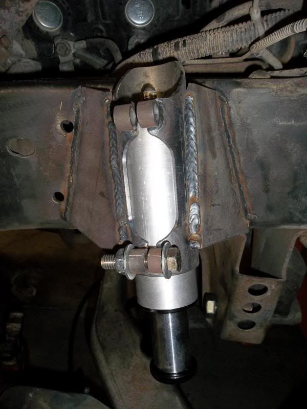

It's official... 15" of travel from bumpstop fully compressed to hanging on the limit strap and that moves the shock mounts up and down 11.5" which should be about perfect considering I'm running a 12" stroke shock. I've got 7" of bump and 8" of droop assuming I set it up as it's sitting right now as ride height which I'm really liking...
Going bump in the night...
Ouchy!!! Hot!!! Don't touch!

Those are some GORGEOUS welds! Looking good!

Those welds on the bump look super nice, good work. These are what I expect to see on my trailer this summer! Haha

The little hiccup on both those center beads about 3 up from the bottom is where I paused and jumped around the tack weld rather then just buzzing over it. Could've taken my time and fit the plates to look a bit more symmetrical but wasn't concerned with winning a beauty contest to be honest.

Those are some damn fine looking welds. I would be willing to bet that the weld is actually stronger than that of the surrounding material.

Hey the welds still look hella good. Better then what most people can do.

Khris damn good welds. I guess after countless hours of burning away you e become quite the pro. I would keep that to yourself though now you're going to have tons of people on your butt wanting things built.
