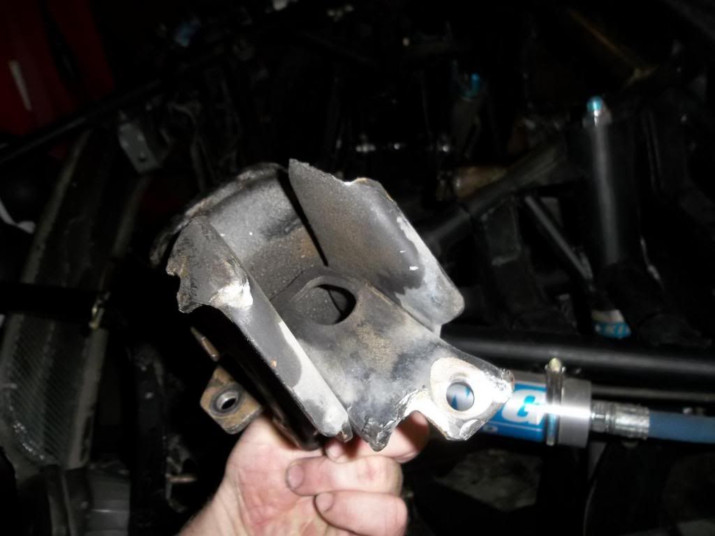

So... gut feeling after looking things over a bit more on the race truck last night. I think the motor mount bolts worked their way loose and that's what caused the failure. I don't think the bracket just failed out of the blue.
For anyone that wasn't there... Check out the jack handle spliced into the coolant line on the side of the block! I need to get that back to Garza to return to Dave!
Lowrida!
The two tabs that are ripped off actually are the lower two that secure straight to the block. 2 out of the 3 bolts holding the mount to the block are gone. I know for a fact part of my pre race prep was torquing those. They will get drilled and safety wired this next time! ANDY!!!!!!!!! LOL I also will be running the stock bracket again but it's going to get some additional love via sheetmetal, welder and hammer!

Are the threads in the block stripped? Did you use a torque wrench of did you just wrench them down? It sucks that something so simple caused the failure. Let me know when you want me to come by. I would prefer to wire up both sides. I also want to take a look at the wire on the hubs as well. If it is going to be after this weekend, I'll see if I can't get my hands on some .32 wire and wire everything up with that instead of the .20.
