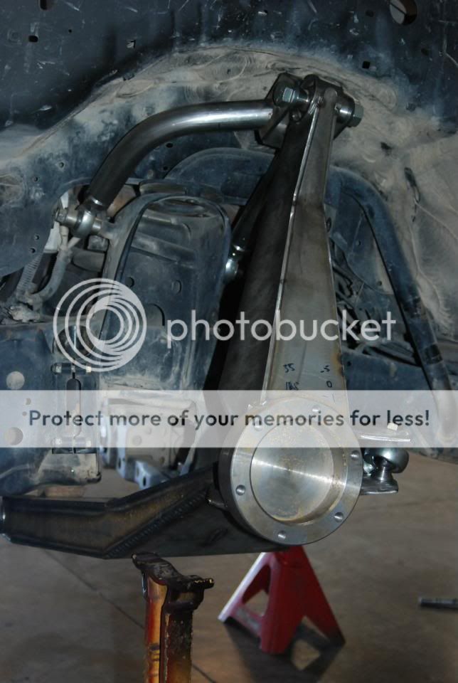

And for the force on the bolts, you can see here basically what the spindle looks like without the hub bolted to it. There's a massive male slug portion of the hub assembly that indexes into it with basically a zero tolerance fit. So the shear load is all taken by just the design of the parts, all the bolts are doing is holding the two pieces together like I was saying...

My only question is when you do have to take it apart is it going to be something that is going to need to go back together quickly, such as a pit situation where getting back on the track is paramount? This is going to take someone with experience a couple of minutes to do. If it is something that is going to have to go back together quickly, I have another idea that is going to cost more but is going to take seconds and someone with zero experience can do.

are you thinking a large sheetmetal style washer with tabs on it. So one can be bent around the outside of the flange and the others can be bent around the bolt head?

No, those never seemed to hold well and I have seen a bolt spin without the washer spinning. Rare, but it does happen. My thought is actually what the aircraft industry is going to. Look up Saf-T-Cable. The tool runs around $350 but it is stupid fast, just as secure as safety wire, and anybody can do it.

I'm not expecting it to be a quick type pit scenario so the speed involved isn't really anything that's of high importance to me honestly. Heck, at this point if anything hub related fails it's going on the trailer anyways at this point cause we don't have spares. The hubs themselves are not serviceable in the field without a press so until we drop the money on having a spare setup machined it would be a day ender either way.
