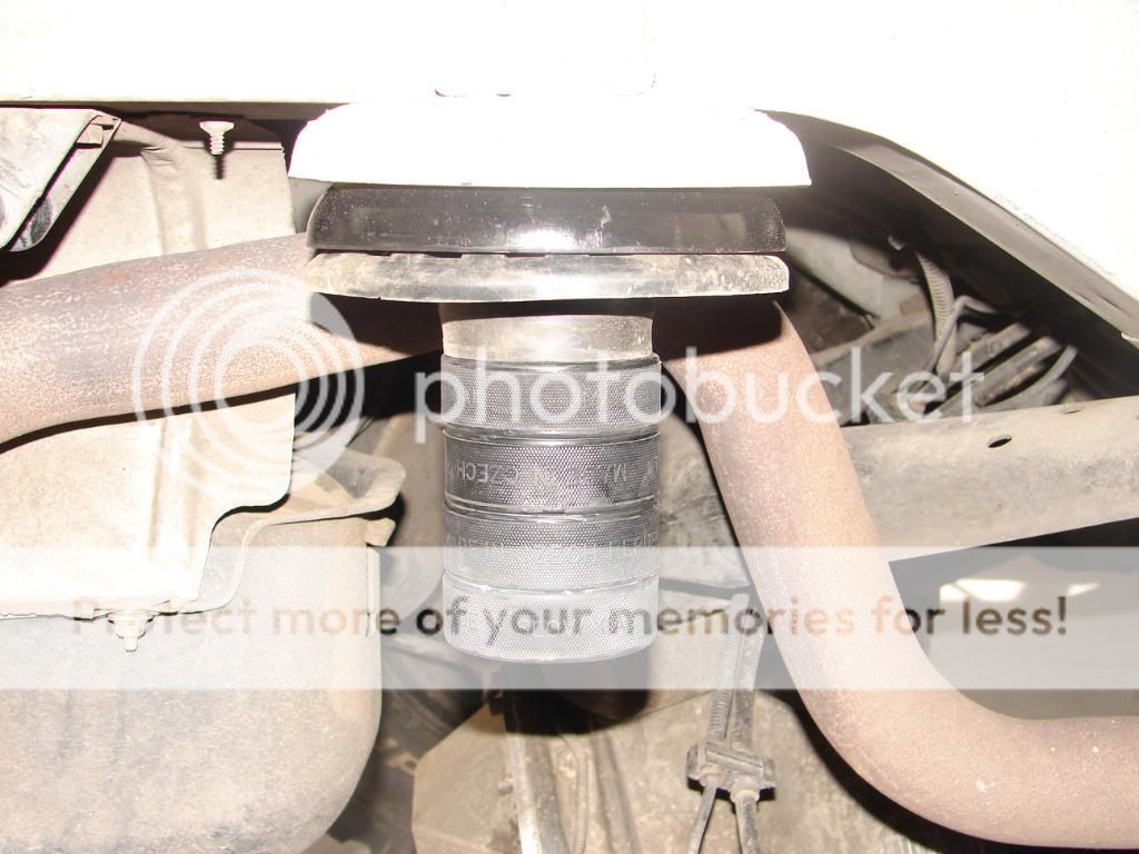

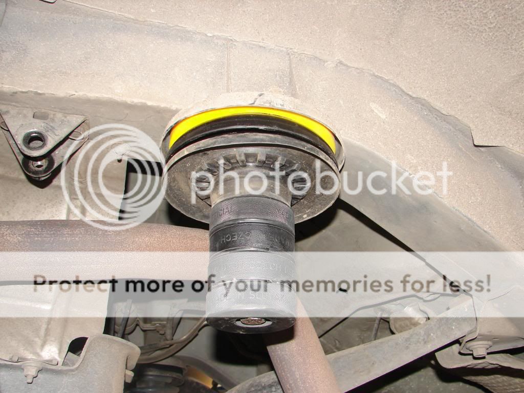

Got the rear bumpstops in today. Had zero issues and it went really fast and smooth. I took a 7/16th drill bit then drilled out the center of the upper plate. Then once again took my impact gun and hammered the 1/2" grade 8 bolt into the hole. Since the grade 8 bolt is harder then the metal of the bump stop plate it ends up threading the hole as it goes. I took a 36" breaker bar and really tightened it in there. Took about 15-20 minutes per side. Once again I had to remove the coil spring to get in there. I also had to disconnect the shock and swaybar to get the alxe to drop low enough for it all to work. Here's some pics. You can see in one my weird OME 10mm spacer (yellow) stacked on top of my KOR 3/4" spacer (black). I ran a few bolts through them to make one solid 1 1/4 spacer. I needed the extra clearance once I added the weight of the heavy TAG bumper, trail gear, and 33" spare. Right now I'm sitting at 23" fender to hub front and rear, which is about 5" of lift.

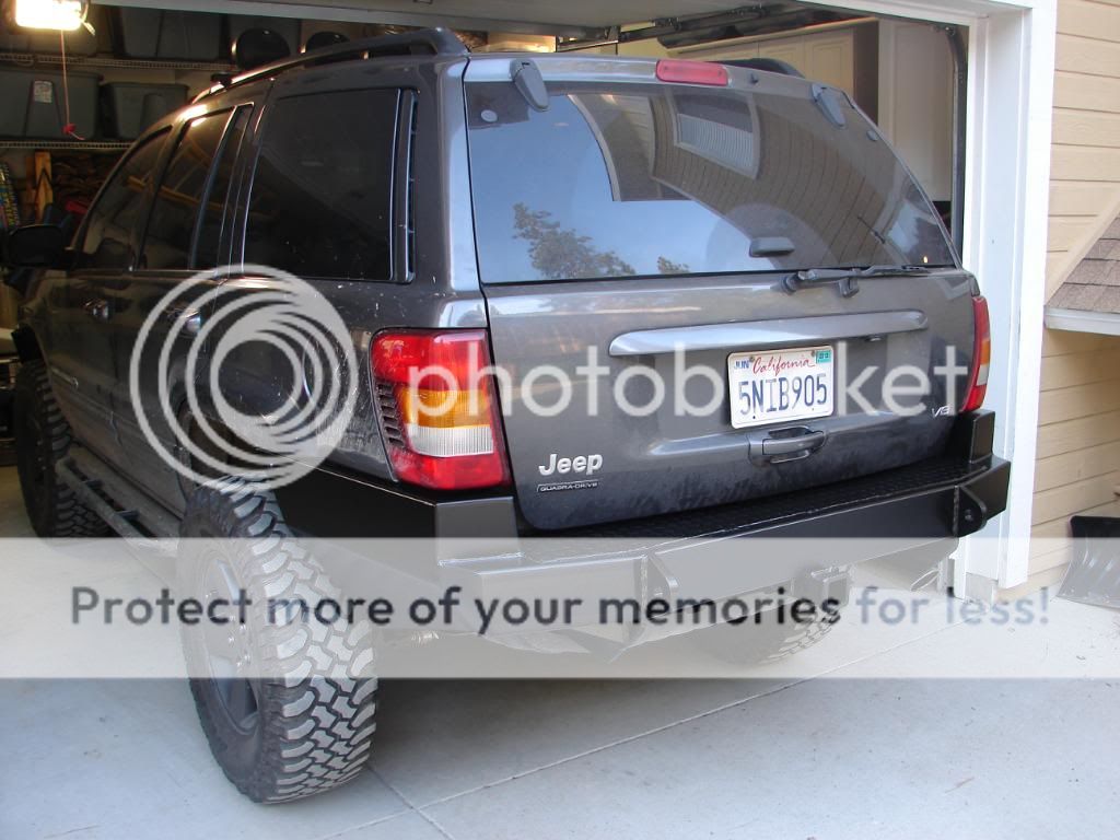

post #86 of 111 Old 03-10-2012, 07:17 PM Thread Starter
bhicks
Location: Forest Falls
Posts: 1,054

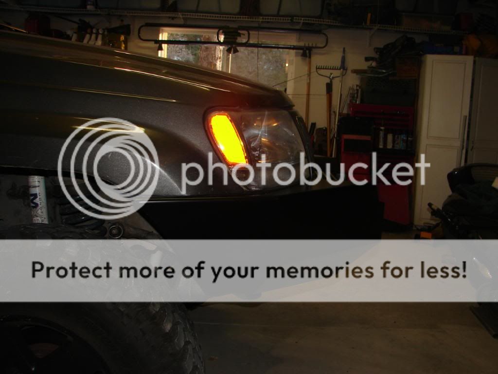

Bumpers are all painted. Here's some pics of what they look like all done:

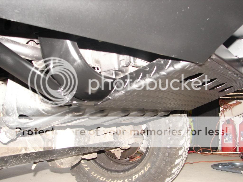

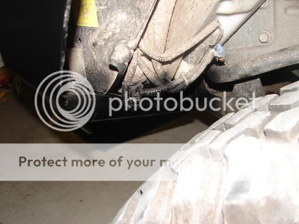

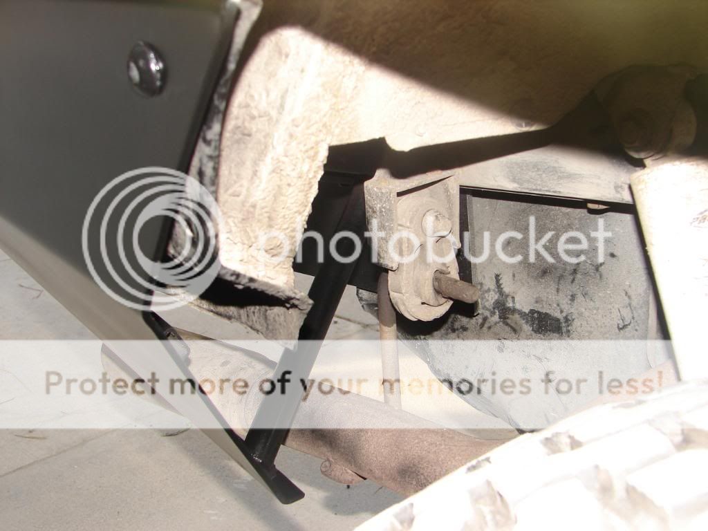

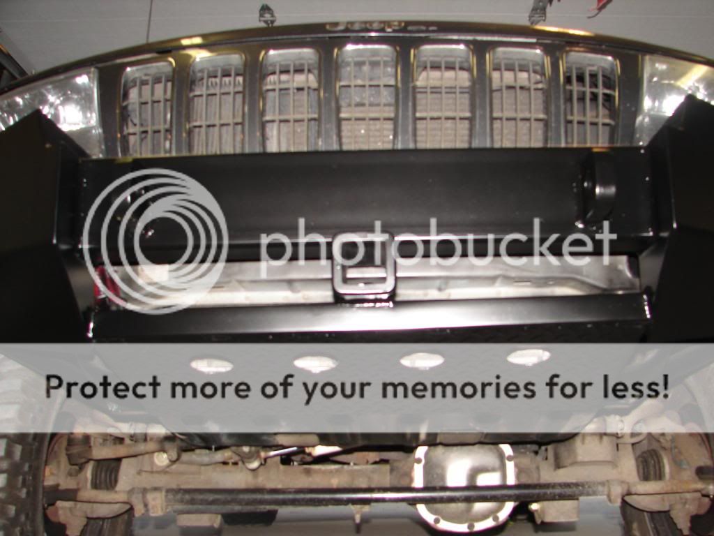

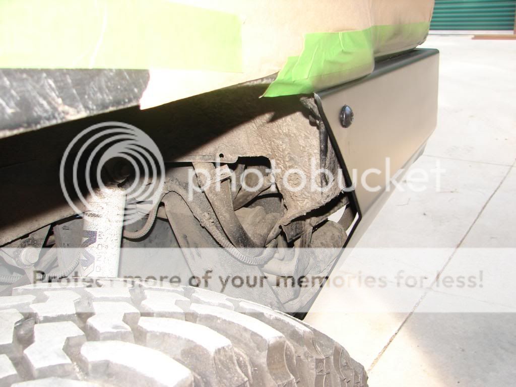

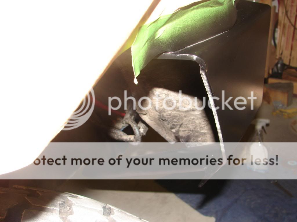

Here's some pics of the reinforcing I had to do to make them trail worthy.
Pics 1 and 2 I added supports and either side to reinforce the edge of the fender/bumper and give me a radiator support.
I added a radiator support which was made up of some heavy angle iron across the bottom of the radiator support bar then some cross bars that go up to the edges of the bumper, then a skid plate that is welded to the angle iron then to the front tow hitch cross bar. My buddy had a plasma cutting table so we sketched it out on his laptop and cut the skid plate in just a few minutes.
On the rear bumper we added the same side support that we did on the front that go from the edge of the fender to the frame rail. We could only add a support to the passenger side since the evap canister thing is in the way on the driver side. We had to bend the frame of the canister and cut a little bit of the frame off to make it fit.

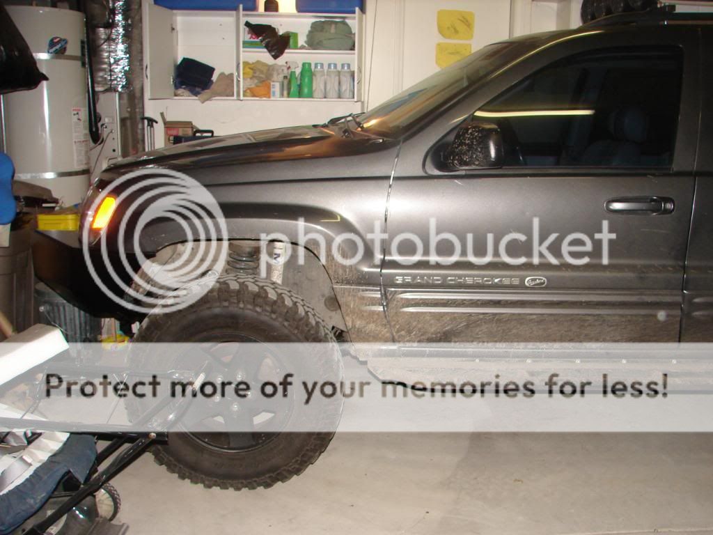

side profile of your rig..?

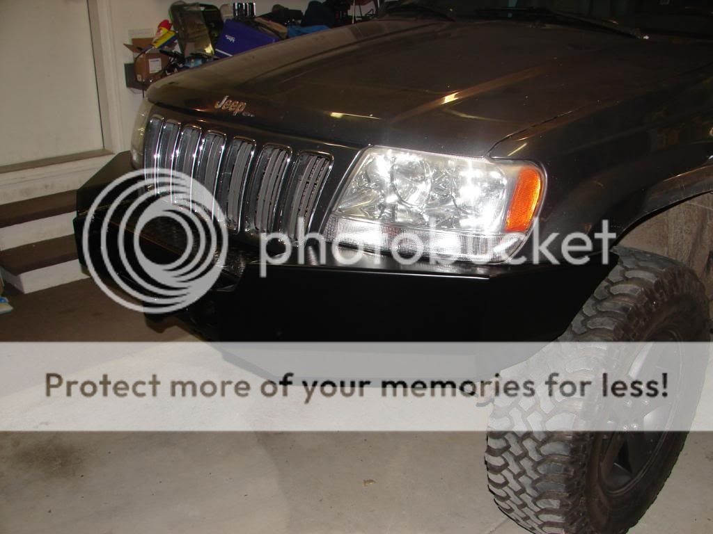

Here's a side shot of the front bumper. I don't have a side shot of the entire Jeep. I will take one tomorrow.
____________________________________________
Past-SOLD2000 TJ, 4.0, 231HD,4.5" long armed lift, 4.56's, detroits, 35" KM1's
Past-SOLD 2000 XJ auto 242 4.0 6" Full traction long arm, Dana 44's, MTR Kevlar 35's, 4.88s, Detroits
Present- 2002 WJ Overland, 242HD(going in soon) 4.5" Teraflex/JKS lift, JCR Sliders, TAG bumpers, 33" Muds, 17" JK Moabs ( Future- 2012 JK Rubicon)
bhicks is offline

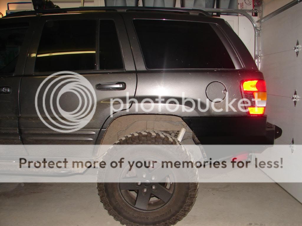

post #90 of 111 Old 03-10-2012, 08:31 PM Thread Starter
bhicks
Posts: 1,054
Here's two shots of the side profile. The front and rear end aren't in the same pic but you get the idea of how the profile looks.
