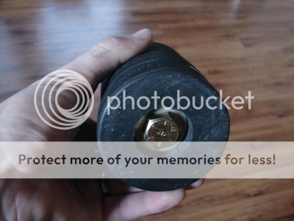

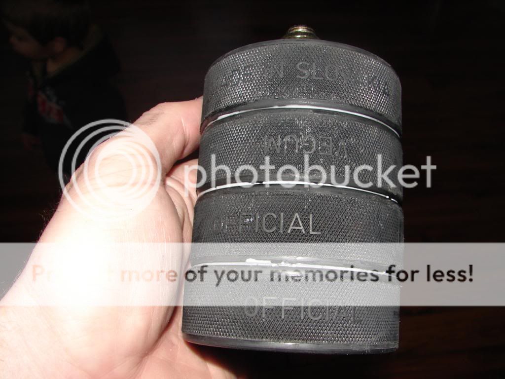

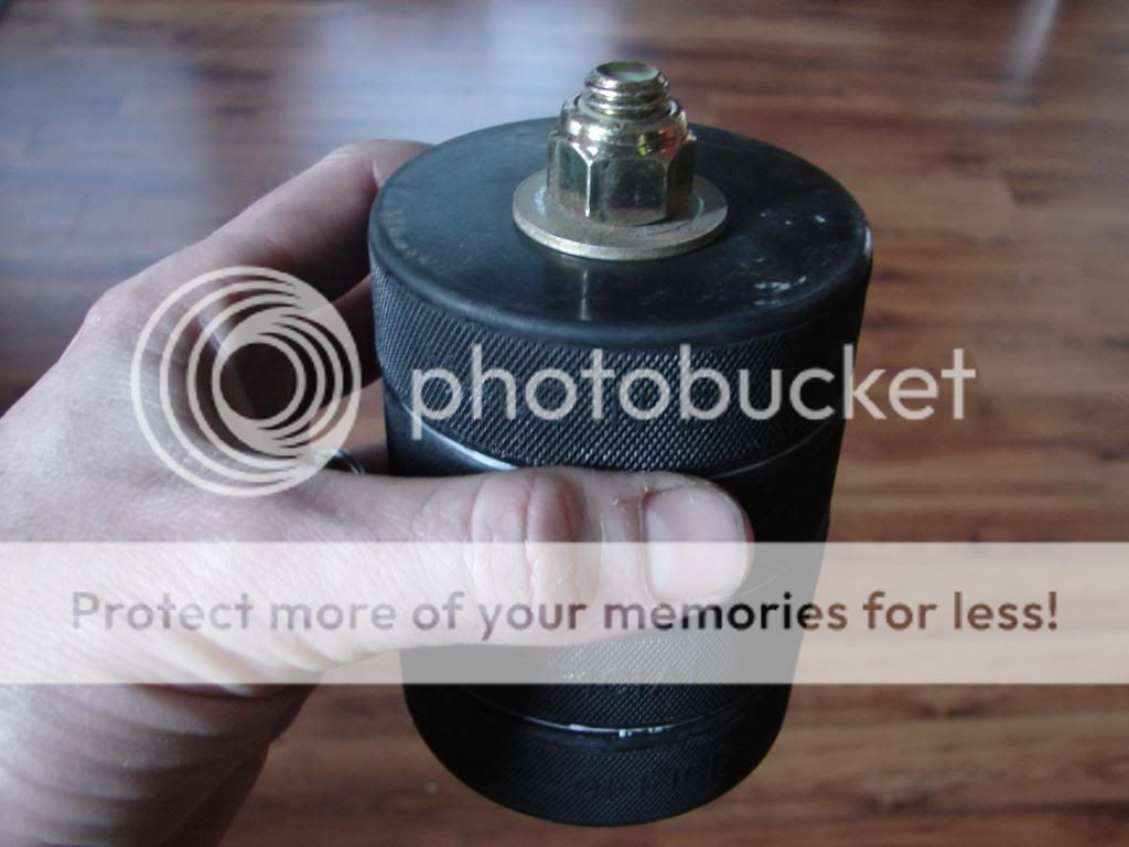

I looked at sport challet first and they wanted $5 a puck. Online you can find them right around a buck. I waited until I found them with free shipping. I will try to see if I can find the confirmation email from the co.
edit: Here's kinda what I bought. It's a 50 pack for $57 with free shipping. I originally bought a 30 pack, but can't find that deal right now. You could easily split the cost between someone else for around $28 which would give you plenty for the front and rear. Probably another $10 in hardware and your set.
http://www.ebay.com/itm/Hockey-Pucks-Bulk-50-cs-Official-6-oz-/290585136393?pt=LH_DefaultDomain_0&hash=item43a839 4d09

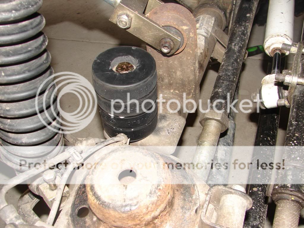

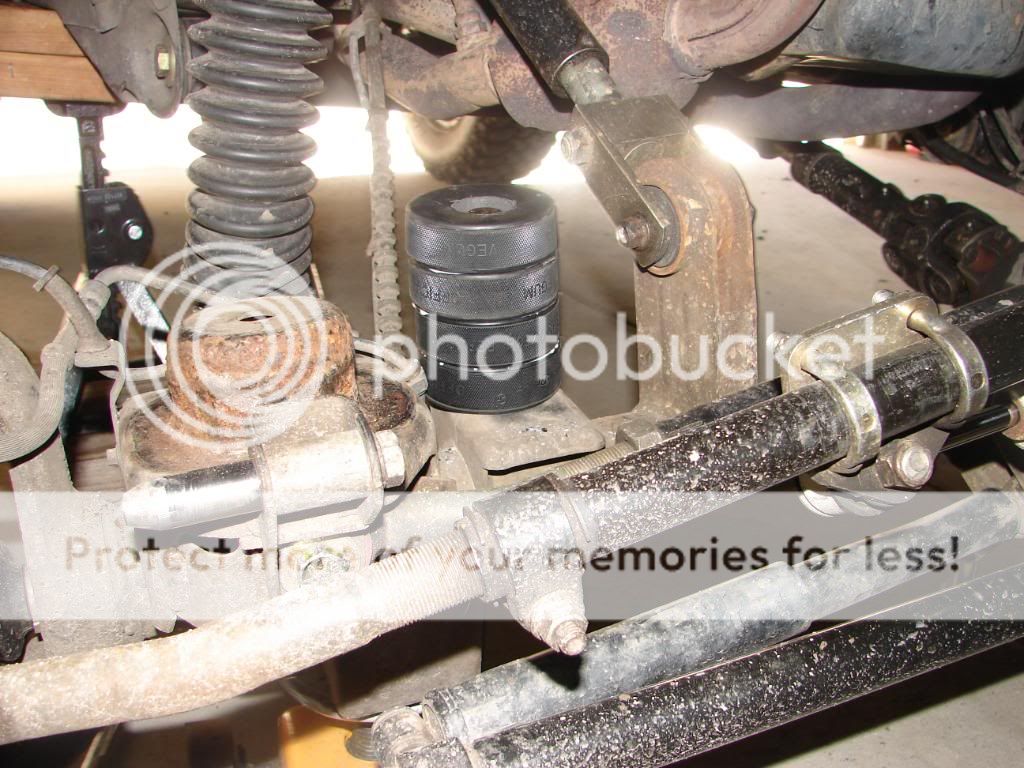

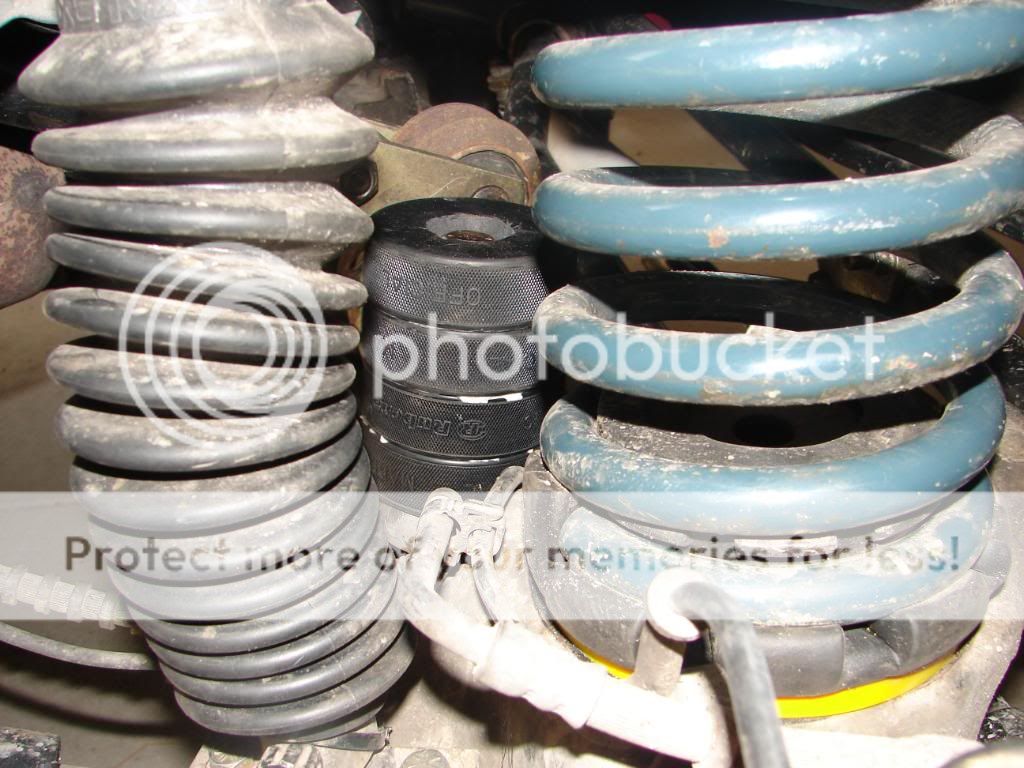

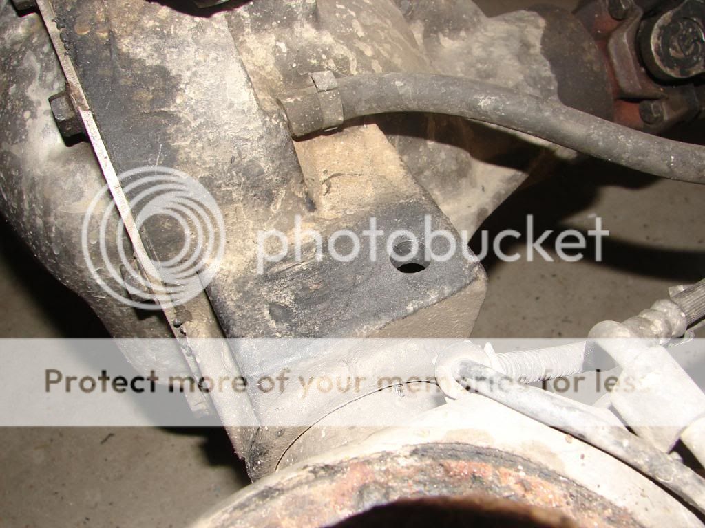

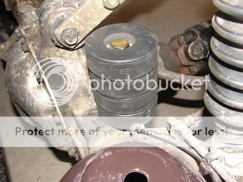

Got the front bumpstops in. The passenger side only took about 15 minutes. I went ahead and removed the coil spring since it was in the way and I needed to install my OME 10mm spacers anyways. You may notice the pucks are not centered on the plate. The reason for that is I used my JKS arms to adjust the axle forward just over an inch so I had to slide the pucks back (off center 1") to compensate for that. The bumpstop now hits the pucks dead center and right when the tire is just about stuffed into the fender. Here's the passenger side pics.

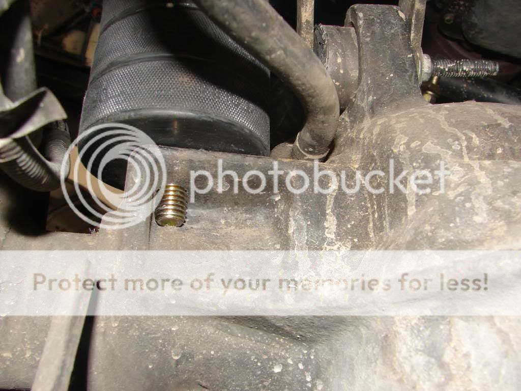

The driver side was a little more tricky since the plate is actaully cast into the diff. I drilled a smaller hole this time to make sure the bolt didn't just slide through it. I then put the pucks on, put the bolt in place and got my impact gun and threaded it into the hole. The hole itself is not threaded but it's in there pretty tight. The hole I drilled HAD to be in that specific spot to ensure the pucks and bumpstop hit dead center but that location caused a problem. That location did not give me room underneath to get my lock nut on the bolt. This is why I drilled a hole too small then used my impact gun to thread it in. I will have to weld the end of the bolt into that cavity to ensure it doesn't come loose. Might not be needed considering how much my impact gun had to hammer that bolt into the hole, but I want to be safe. Here's the pics of the driver side.

Originally Posted by PhantomWJ View Post
BHICKS - you need some rustoleum...and sand paper
Look at the 5th pic closer. The lower coil spring bump is shinny becasue I just finished sanding it and adding two coats of rustoleum on it. Both lower coil spring bumps had bad rust. I had to use the chisel first, then the heavy wire brush, then the sanding block, and finally the paint. Should stop the rust from getting anyworse. All the other red color is actually mud. Our dumb *** neighbor decided to truck like 50 loads of dirt up from down the mtn. and its like a red clay dirt. It doesn't allow the snow to seep into the soil so his property just turns into a giant red mud puddle every time we get snow and it melts. As the snow melted it just ran down the center of our dirt road. Now all of the cars on our street have this horrible redish color under and all over our cars. Only thing that will get it off the paint is a clay bar.

I forgot to add something. If you dont have adjustable fronts and would need to put the hockey pucks dead center of the plate then my approach on the driver side would not work. What you would need to do is do the reverse of what I did. Instead of having the bolt go down through the plate on each side you would take the bolt and flip it up side down and weld the head to the center of the plate. Drill a hole in the center of each puck then slide them over the bolt. You would need to counterbore the bottom puck to fit over the bolt head and counterbore the top puck to seat the nut flush. I thought about this approach but realized it wasn't needed since I had to offcenter the pucks anyways. If you weld the bolt on then you would need a shorter bolt since it's not actually going through the plate. I will probably do the welded approach to the rear. I will weld the bolt to the top plate inside the coil spring then add the pucks around it. I will also take pics of that as well. I plan to get the rear end finished up this week.
