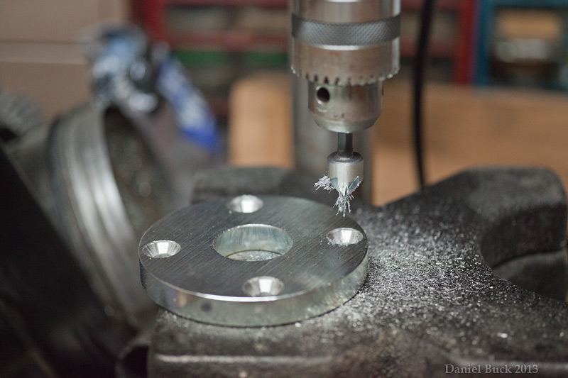

started making the adapter plate for the turbo. The exhaust manifold bolt holes are farther apart than the bolt holes on the turbo exhaust inlet. So... I picked up a HUGE washer from McMaster-Carr (a shopping mall for men! haha :smokin: ) which gives me a head start with the large hole already drilled in the center. My drill press is old and tired, it's chuck is wobbly, and it spins way to fast for metal even on the slowest belt setting. But I make it work, for now. It was my father's, it was good enough for him, it's good enough for me
These are the counter sunk holes for the allen head bolts that will mount the adapter to the exhaust manifold. Once I get the engine into the engine bay, I'll place the turbo on top and figure out where i need to drill the holes to mount the turbo. I'll drill those holes, tap them, and insert studs. There's not enough room underneath to have a bolt head or a nut, so they will have to be studs. It makes sense in my head, I think it will work :laughing: The washer is 4" OD, 1.25" ID, and 1/2" thick, about $7 from McMaster if I remember correctly.
I'll still need to file out the hole a bit larger to fit the turbo exhaust inlet size, but at least the center hole gives me a head start, I don't have a bit near large enough to drill a hole that size in steel.

I may have a bit for the center hole if you end up needing one? My Grandpa was a machinist and when he passed on my Grandma gave my brothers and I most of his tools, plus another retired machinist left us a bunch of his tools when he moved out of the country. Have lots of different bits.
I have a cheapo HF drill press, the chuck slips out of the shaft all the time. I've been thinking about tack welding the chuck to the shaft.
Nice job Daniel.
