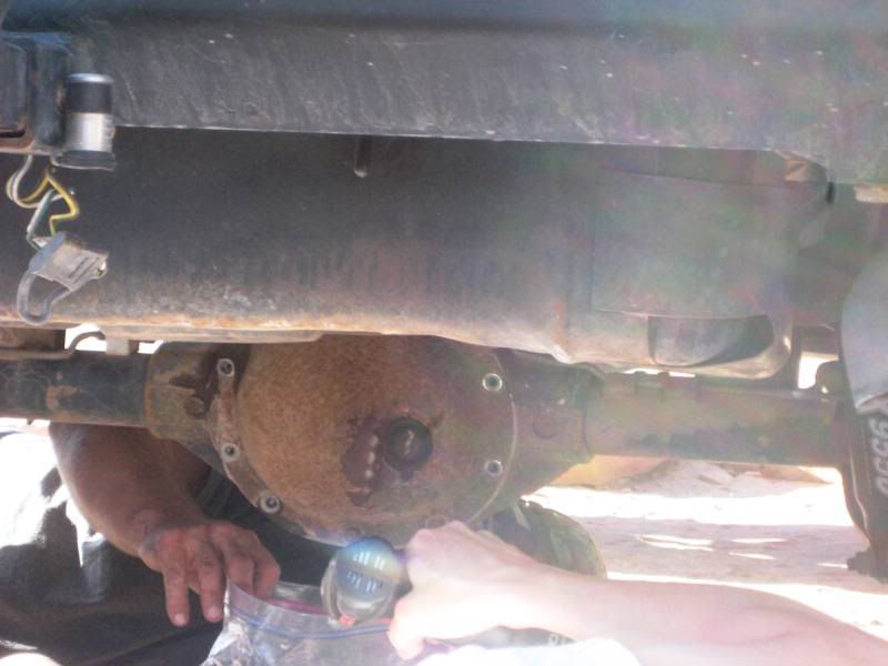

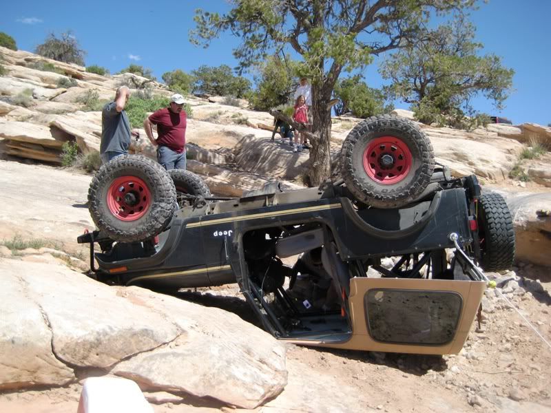

And the carnage:

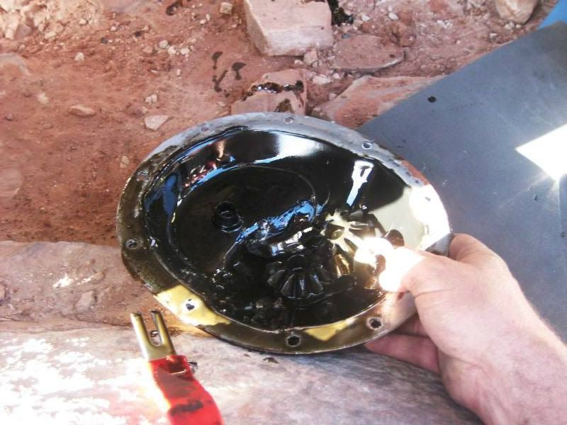

Grenaded D35

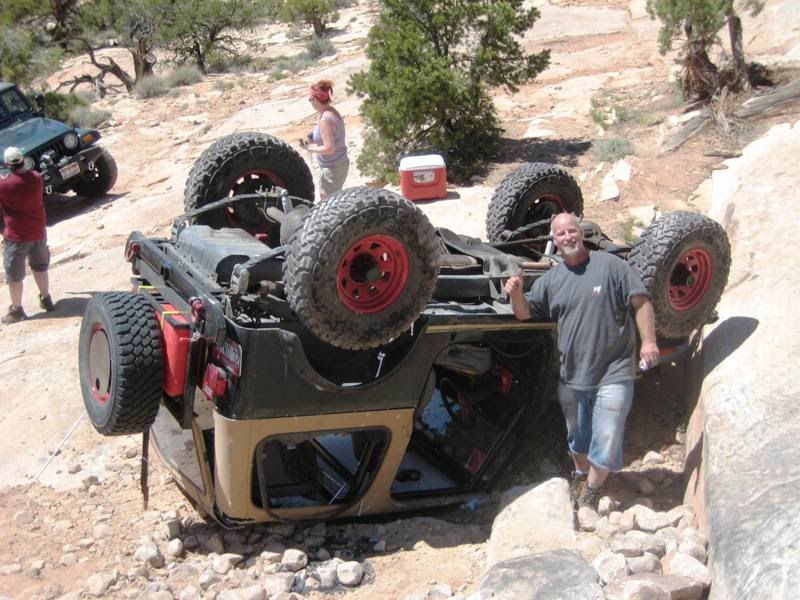

Rolled CJ7....drove it off trail

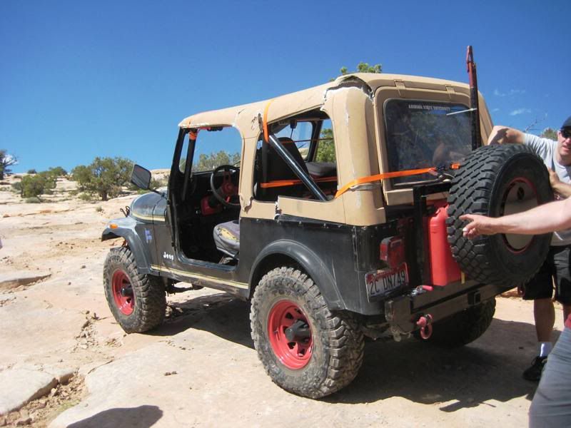

My bent tie rod
Trip was a blast though!

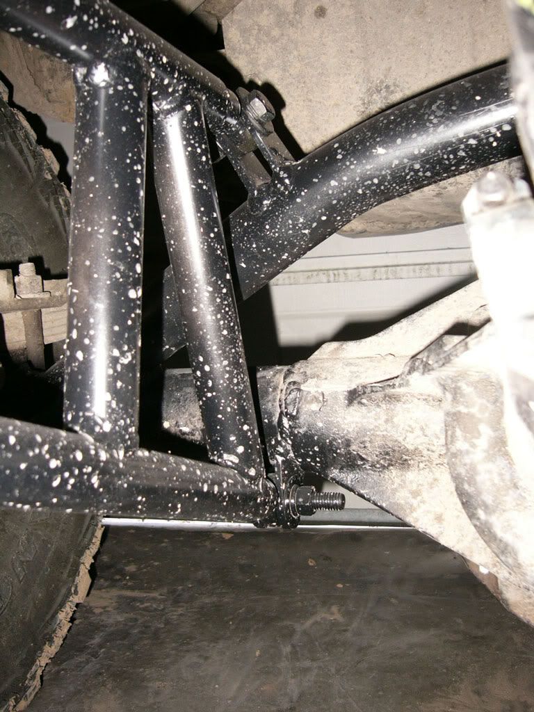

Here you go Chili. I decided to mount the top link to my truss, mostly to get better link seperation and to try to limit the anti-squat I introduced into the suspension. I get a bit of anti-squat (rear lift instead of drop on acceleration) but I may be able to overcome that with a spare tire and healthy rear bumper. The tabs and heims I ordered from Spidertrax. The tabs are 1/8" material, I figure if I notice tearing or other deformation I will just order duplicates of the axle tabs and weld them onto the existing tabs, with plug welds which should give me effective material thickness of at least 3/16" (since 2 1/8th plates welded together arent quite as strong as 1 1/4" plate itself).
Rear axle mounts;
Front mount; will reinforce the t-case skid with some 3/16" plate with plenty of plug welds along the bottom.

Bent Trac Bar dumby!

Lol oops....that's what I get for posting so early in the morning.

Hah, I thought I was the dummy. I was looking so hard at the steering trying to find the damage that I didn't even see the track bar

Lol I have Currie steering with the Savvy heat-treated tie rod. If that was bent, I'd have some SERIOUS problems!
Gotta replace the trac bar with a Currie one. Lets see 1 1/4" x .250 wall 4130 chrome moly and a Johnny Joint do that!

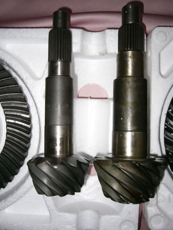

Guess what came in today
And people say the amc 20 is weak!!!?!!
The AMC gear is on the right, the left is the D44
The AMC pinion is also on the right, the D44 on the left.
Which one looks beefier to you?
