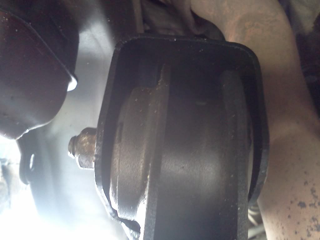

Sorry to hyjack, I think my driver upper axle side ca bushings is bad
pic
Ordered a new bushing but all I got was the metal incased bushing. is there another bushing for the axle?
passanger side. Looks totaly diffrent?

Axle bushing part #?

k3128 question as well... according to the pics above there are two different bushings on the axle for the upper control arms. i am replacing all ball joints, control arms, and links so part numbers and brands are needed for the front axle upper ca bushings. i am buying all new ca to save the hasle of replacing just the bushings so its easy and just bolt on and done plus its really not that big of difference price wise in going about it that way. just dont know which way to go on the rear upper ca complete new or just the bushings there is a big difference in price there.

The axle side bushings are the same. And if you haven't already you should do some research on replacing the axle side bushings, its not very fun/easy.
