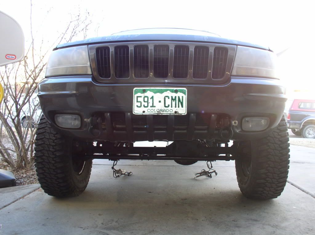

A few... straight on, from the front:

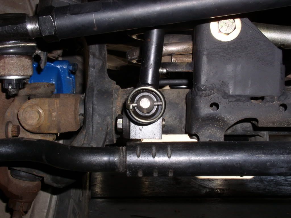

I used some angle iron to turn the passenger-side sway disco 90*, but its a design that I'm still working on, as it tends to want to bend a bit under load... you can see the track bar bracket fabbed from 1/4-wall 2x4, and mounted on top of the stock track bar location in this pic as well:
You can see the OTK draglink in the a couple of those photos as well -- works great!
