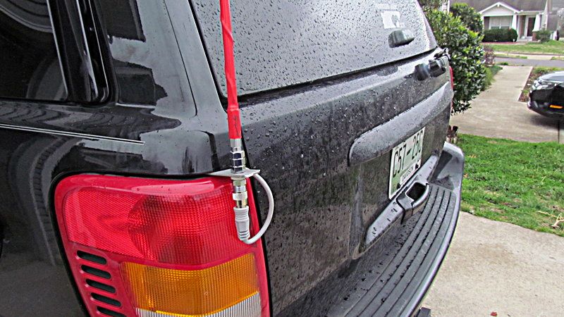

http://www.amazon.com/gp/aw/d/B000X3...f=ya_aw_oh_pit
Here's the one I used but I mounted it to side of the jeep instead of the rear.

^^^^^^ you dont worry about that getting ripped off by a tree or something when wheeling? We have tight trail here in TN and that would be gone in 5 minutes hanging out there like that

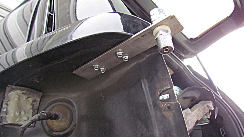

OP.......all you need is a small piece of flat steel. I used 4 self tappers to hold mine in place. Cost about 2 bucks.

if your careful you can just notch your tail light with a dremel
Can you post a picture with the tail light removed?
