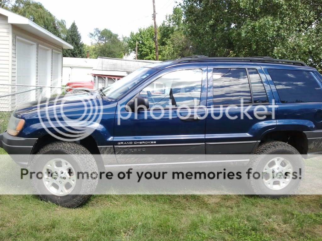

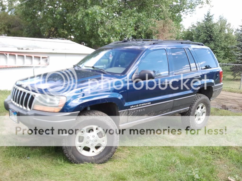

Here are a couple pics of it right after the lift and tires. I dont have any current pics.
