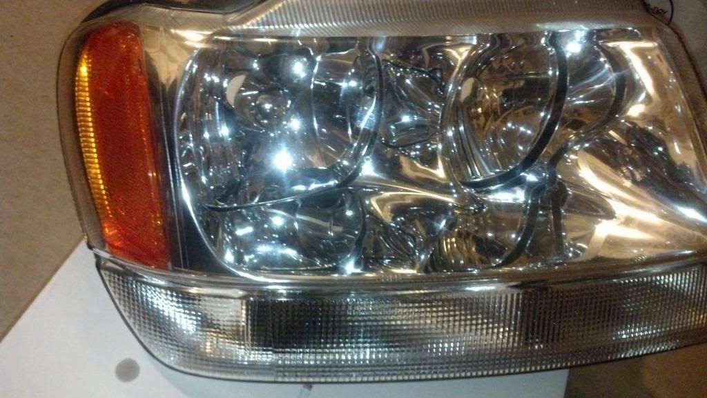

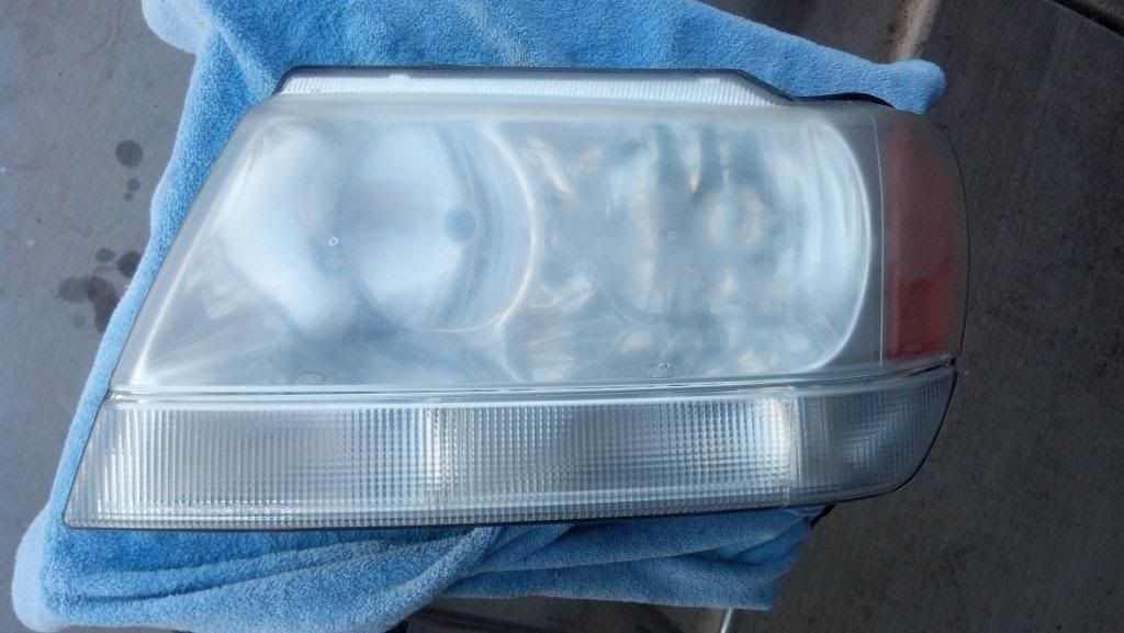

Mine were almost as bad as the Dodge light above when I started... I didn't even think about taking before pics... but here's a pic. after all the sanding and before I added the polymer included with the Sylvania kit...
and here's the final result (I know it's opposite light, but they both looked the same)

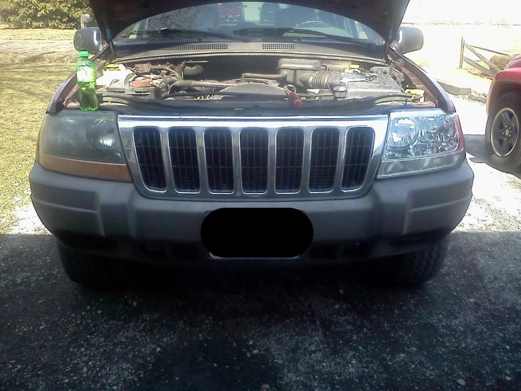

A year after doing these I upgraded to projectors... giving my old headlights to my dad for his WJ... As you can see his were bad but mine still looked good after that time...
