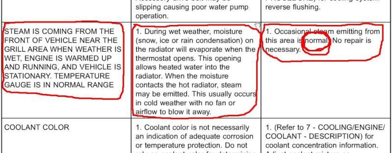

Not trying to be a jerk, Outlaw, but please see the following statement direct from the 1999-2004 Jeep Factory Service Manual:

OK, fellas. No need to get all heated up, tho I bet blowing off steam is harmless in that regard too.
Thanks for the great info, and particularly the last post with the Jeep repair manual. That rocks - and puts my mind totally at ease that this is a non-issue. This is EXACTLY what's happening to me.

No worries, and good info, that would also apply to every vehicle with a front radiator. What you posted makes perfect sense. When your jeep gives up the little white puff of steam, does every vehicle out there do it? My post was also directed at anyone thinking that white 'smoke' or steam was in any way related to oil...its not.
